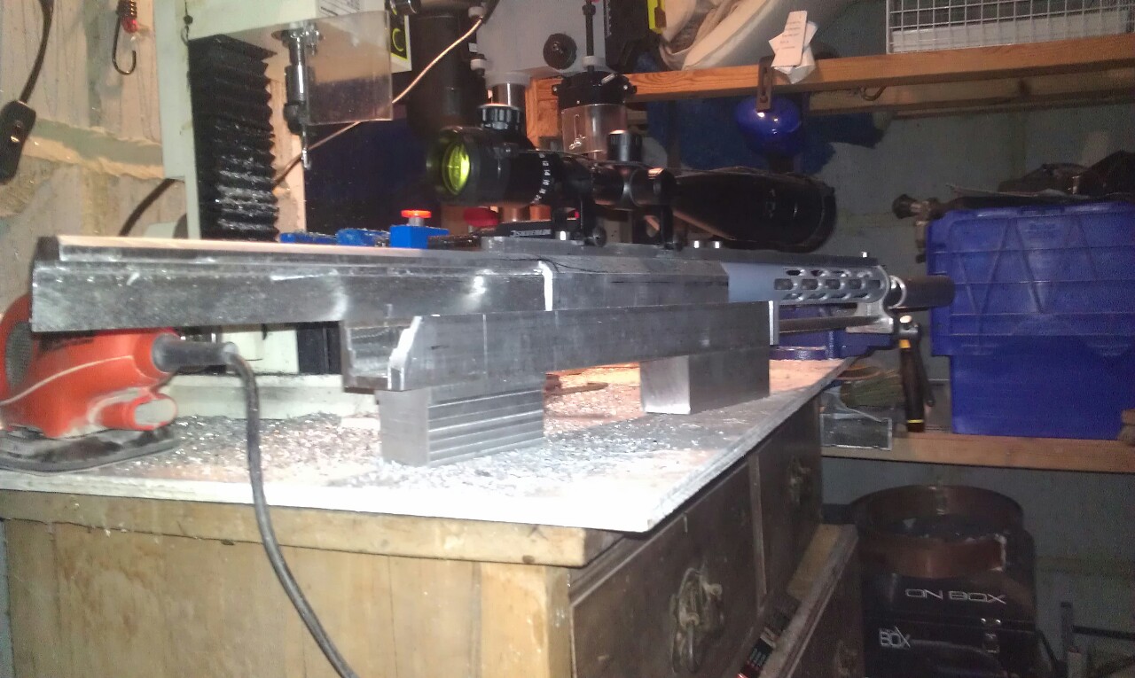

just quick update on what i have done so far
Main problem at the moment is finding a place for the internals to fit as they are pretty large compared to gun overall size.

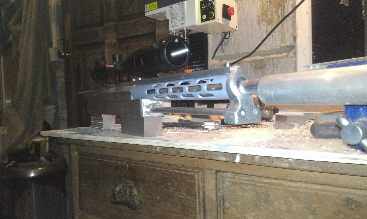

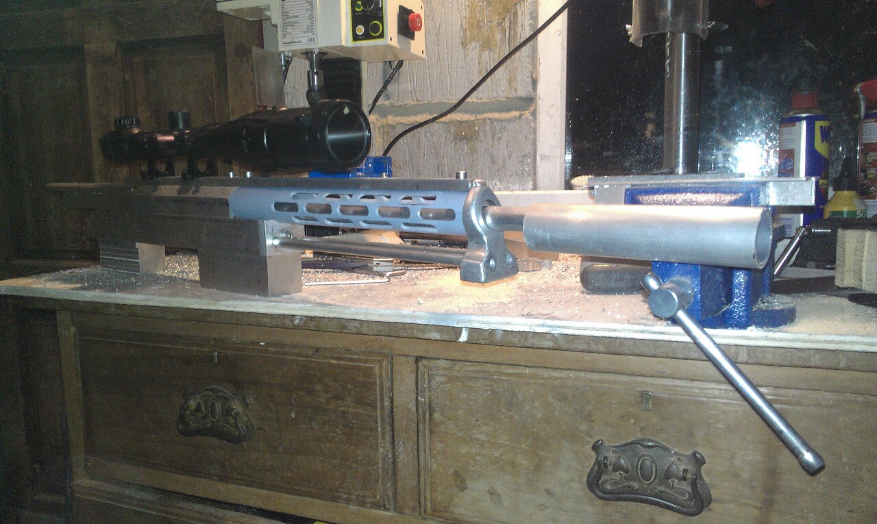

Couple of up to date photos

Wow, looking very smart! Great work, looking forward to the finished result :)
