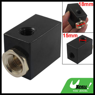

Also this is the qev I brought,
But the listing tells me its 1/4 but the measurements in the pic make no sense!
Ideally I want to reduce the exhaust port but don't know the size 18mm is 45/64 or is it meant to be 5/8?
- $(KGrHqF,!g0FC2mWVZYeBQwzkD3l9Q~~60_12.JPG (26.52 KiB) Viewed 8894 times
Yeah, the thread sizes are pretty weird. I'm guessing the 18mm dimension is actually 1/2" BSP.
