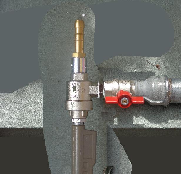

ok. I've finished my gun and it works very well. what can I use for the trigger instead of a blow gun?
Modified ball valve:
Or any of a multitude of valve styles really, what's wrong with the blowgun?
Filippo.san
Posts: 24
Joined: Sat Apr 27, 2013 12:46 pm
There's a big waste of air, i have to find something different or a small blow gun. And i have to use it reverse or it will leak

Ok. my gun is finished and it works fine. have you got some better ideas for the scope mount? it's not very stable.. I'm also looking for a better scope, maybe a 6x32 or something like that. my budget is about 40 euros. Any suggestion?
thank you in advance.
ps what's the highest pressure i can reach with this gun in your opinion?
http://i44.tinypic.com/2vd4pp2.jpg
http://i42.tinypic.com/30netqg.jpg
http://i39.tinypic.com/2vv598k.jpg
I wouldn't take it past 400 psi, the blowgun will probably start to leak above that pressure.
The breech looks awkward, does it seal well?

Yes, there are no air losses. And what about the scope mount?
Should I use a rail maybe?
You can buy a couple of these and clamp them directly to the barrel:
http://www.ebay.com/itm/DUAL-WEAVER-RAI ... 3cd20e3be0
Note that the above fits a weaver rail, your scope might need a different type of rail.
