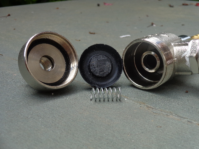

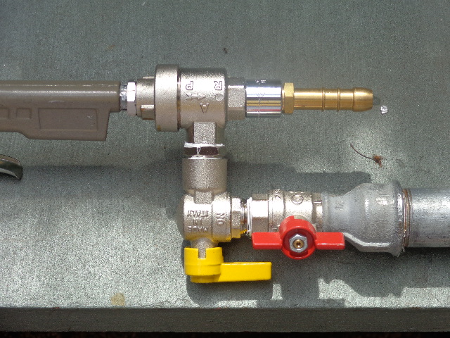

And i put it on my gun. I have got a chamber with a valve that takes a part of the air from it. The air has to pass through a tiny hole that slows the flow, because the air goes into the qev from the barrel side and not from behind the diaphram. I cut the diaphram in some points to let the air pass with a small flow. Of course there is a spring behind the diaphram, on the pilot side. The problem is that the diaphram closes the barrel hole only for the first shot, then when i open the chamber valve to shoot again, the air passes easily through the barrel. It happened only once that i could shoot all the air reserve without any problems. I guess it is a problem of the spring but i can't solve it. I use a pressure of 12-13 bars. What do you think? Thank you in advance
I think I understand your question but it would be better to see your set up, puoi farci una foto?
I think the problem is that the grooves in the piston are insufficient for air to flow past it.
Have you tried poking a small pin-hole instead? This is the normal solution when people are using chamber-filling QEVs.

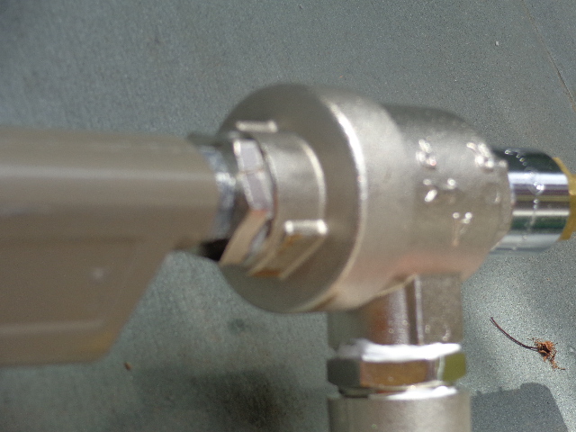

It's hard to say exactly from those pictures, but I have a few thoughts. I don't know if its the quality of the pic but your sealing face looks very rough, almost like you hit it with sandpaper. Next, in my opinion, you have too many equalization holes, and also they're in the wrong place. I have seen this setup work well with one tiny hole in the thick portion of the piston, off to the side of the sealing face. Your hole(s) are actually on the sliding edge of the piston which probably affects the smoothness of it's travel. Hope this helps.

Ok, thank you very much. I will buy a new piston and drill the holes in the thick part. Then i'll let you know..
