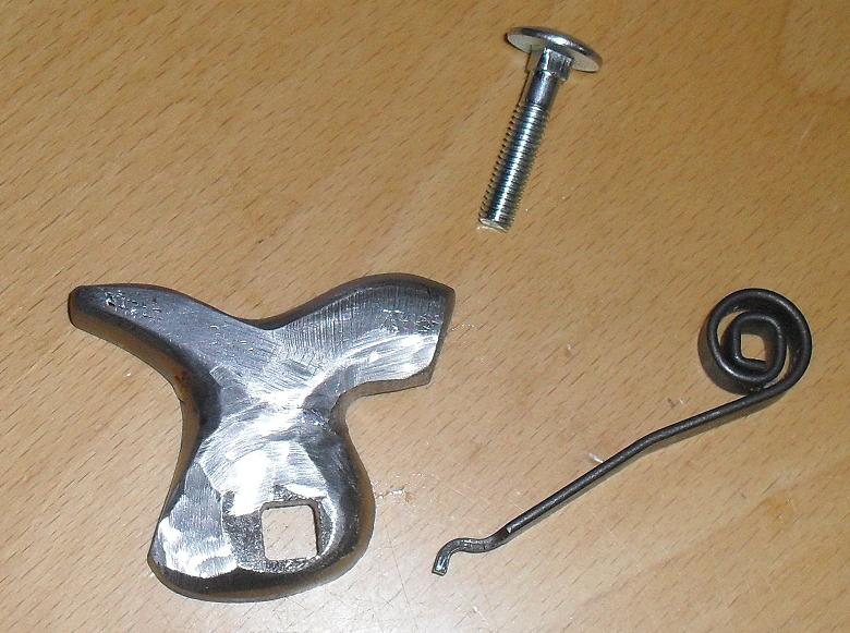

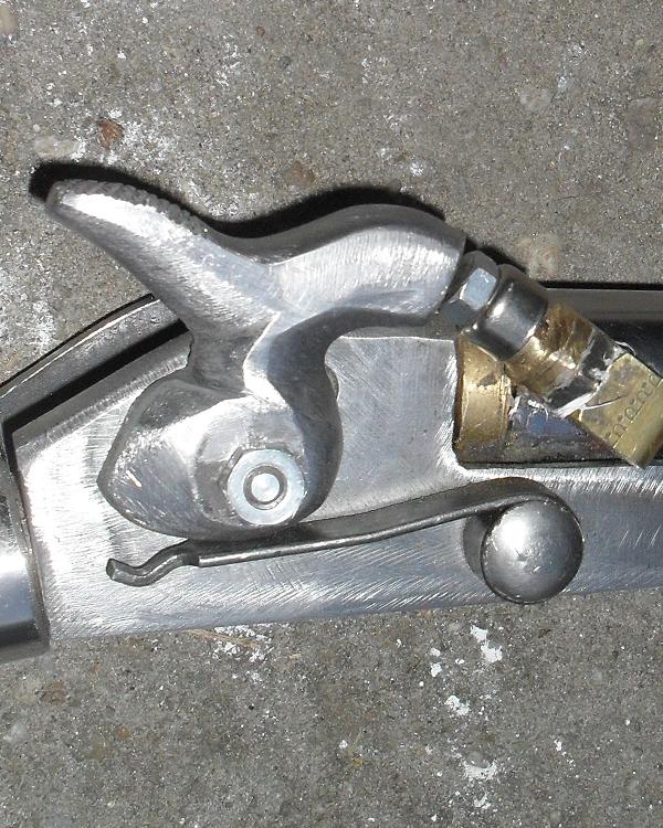

The round thing on one end is a lockbolt, rounded flathead with a square right underneath it, normally used to attach those long hinges on farmgates..?
The square part buries itself into the wood so you can tighten a nut on the other end without the bolt turning.
Because of the rounded smooth head you can't remove the bolt from that side.
Anyway
The leafspring, wich is made from...leafspring...curls up into a square wich fits the lockbolt with some assistence.
I took it from a lock ( doorlock) and I have several spares in case one gets damaged.
I tapped an m6 hole through the sideplate.The lockbolt threads in and on the other side I use a nut to lock it in the position I want.
This way the spiral- end is hidden from view by the nice rounded head of the bolt and the angle ,and with it, springforce is adjustable.
Anyway

Gonna have a smoke and take a picture of one of those springs and the lockbolt I' m talking about.
Edit:
There you go!

I'm confusedThis way the spiral- end is hidden from view by the nice rounded head of the bolt and the angle ,and with it, springforce is adjustable.
Got this partI tapped an m6 hole through the sideplate.The lockbolt threads in and on the other side I use a nut to lock it in the position I want.
ThanksGonna take a picture of one of those springs and the lockbolt I' m talking about.
I'm gonna buy a doorlockI took it from a lock ( doorlock)
Edit: Ah, now I get it. Was confused about how you adjust the tension but now I know.

You could go to a locksmith and buy just the spring, or ask for broken locks or used ones they put in the trash.I'm gonna buy a doorlock
I edited my post to include the pictures...
