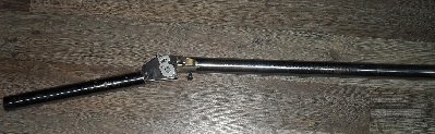

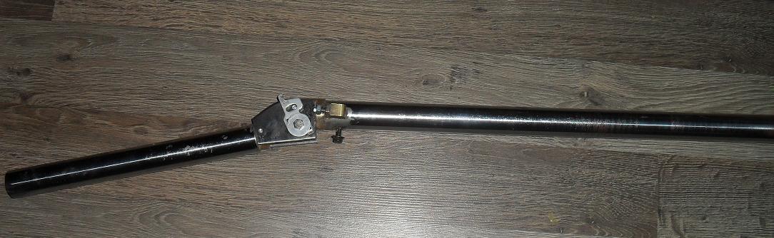

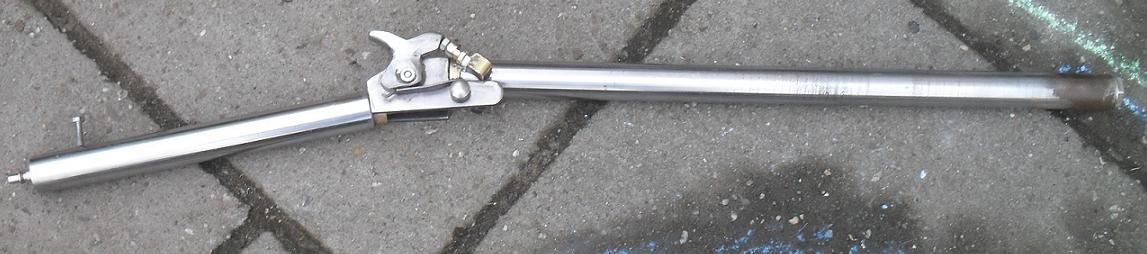

A more serious airgun for my kid this time, after some Nerf projects.
I set out to build him something to last a lifetime, a wallhanger for when he's grown.
So...I decided to make a muzzleloaded coaxial repeater, in a Lukens kind of style.
An airgun to resemble a flintlock musket..wich will launch anything shoved down the barrel.
Soft and light stuff at first...he's still young.
I used the tubes from a motorcycle front end, since they served me so well last time.Thick smooth steel walls...
The original plug was drilled to accept the barrel and an O-ring seal.
The piston is made from thick rubber, with an O-ring superglued to it.The O-ring naturally expands against the reservoir walls.
I used one slightly larger than the I.D. and pressed it onto the piston with a brass cilinder while the glue set.
All in all it is 100% airtight -one way offcourse, and comparable in weight to a QEV piston.
A light spring keeps it in position and prevents it from flipping over.
It actuated spot-on..just like a factory made QEV.
A hammervalve is added to pilot and an extra supply of air is held in the buttstock.I've restricted flow between the valve and buttstock to act asif the piston would have a tiny equalisation hole, yet it doesn't.
Same type of system as I used on Old Shat, just a different approach.
Tapping the hammervalve to fire, repeat untill the gun is empty... :D
Just started on the project, the hammer shown is just a mock-up.
I need to set the fillplug in place, add a trigger mech, hammer, sights, paint, woodwork, engrave it some, decorate etc.. etc...
And boy do those scrathes pop out on camera! Wyz should have a blast!
But here are the first few pictures:
(More will follow)

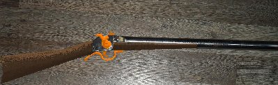

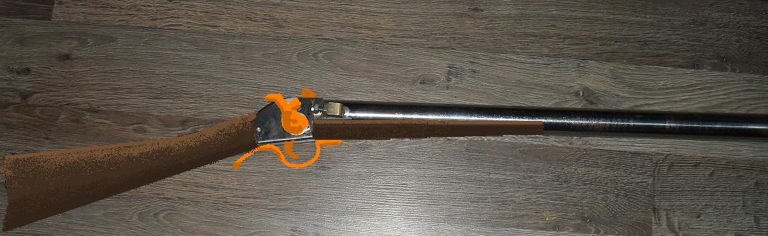

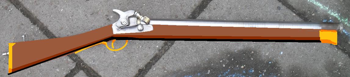

This is the idea..basically.<br />Will need to add a ramrod to the front grip though...

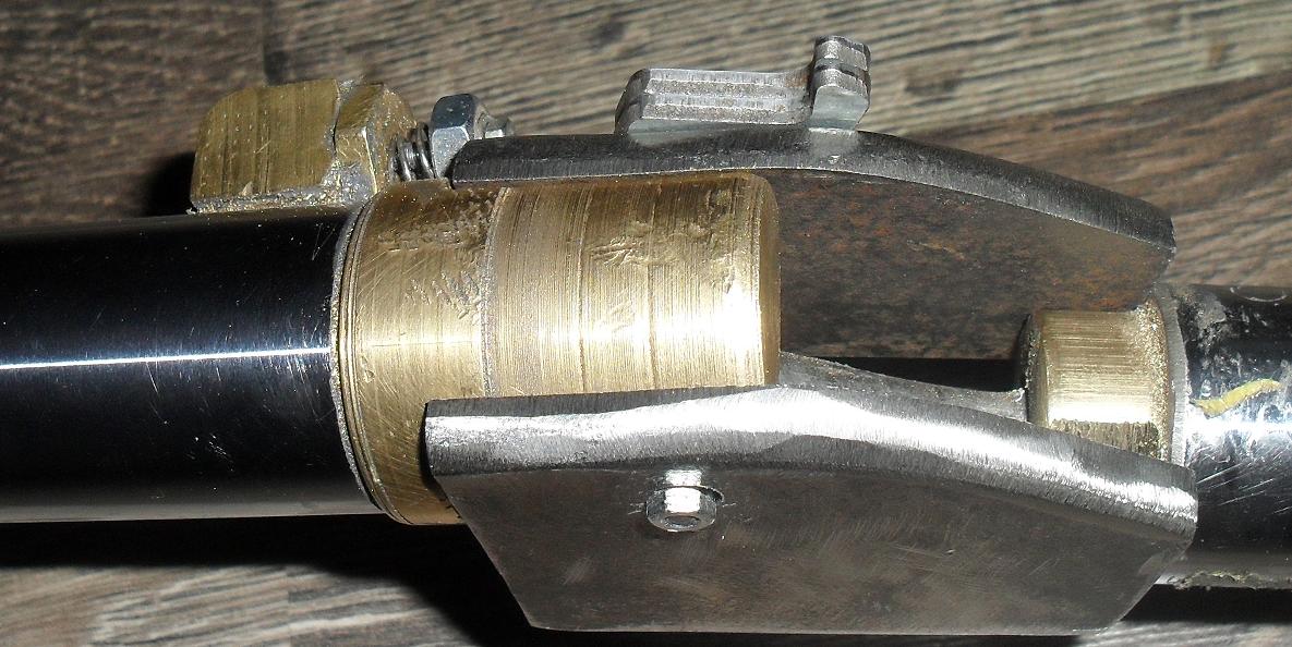

It's pretty basic...
Coaxial in a tube, connected to another tube.
The brass bar holding all the pieces ( reciever?) was lathed down to fit inside on one side.
The other ( bigger) end was filed down to fit the sideplates...and tapped for the pipe-connection.
I used a square elbow to house a hammervalve...and voila.
Unfortunately my welder died ( I think) so the conical buttreservoir I had collected all the pieces for is out...
Wich is no problem really.
I guess I'd better save that for ....another project anyway...
I just made an m8-to square-to m6 axle for the hammer...so pretty soon it should be functional..

Looking great as always Brian I especially like the MS paint artist's impression hehe
Thanks!
You always say that...
If the idea doesn't come across with a simple sketch...it is most likely not thought through very well.
I've been building stuff that shoots for so long that the real challenge is no longer to make it simply work.
My goal is to make it work simple.

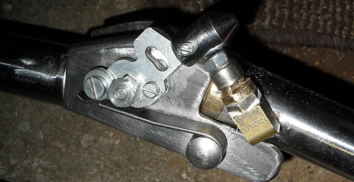

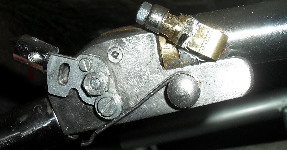

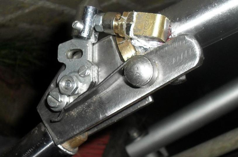

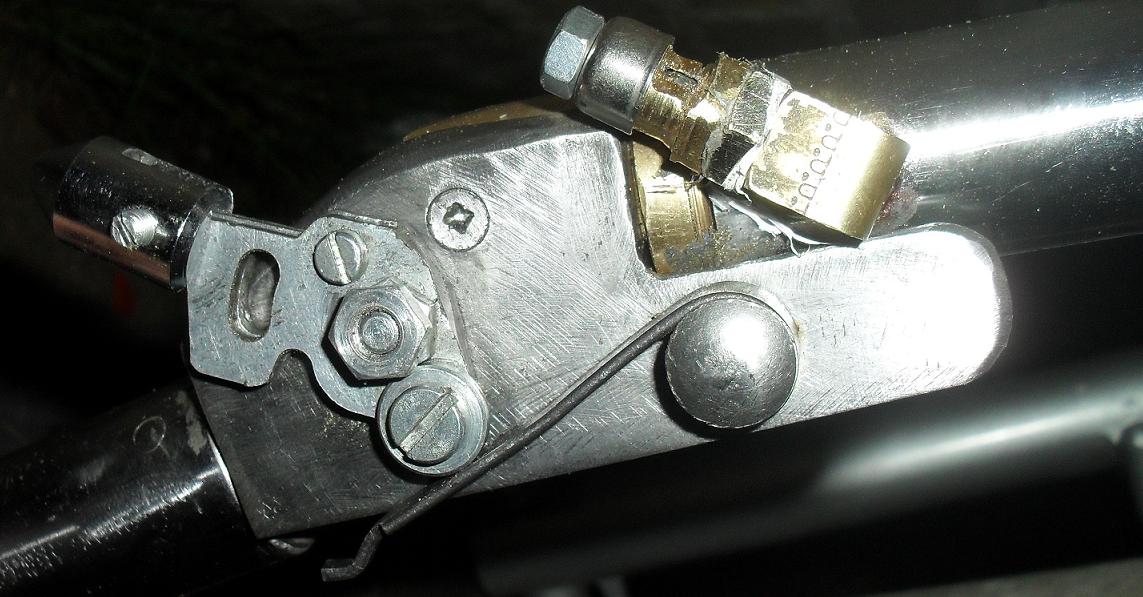

I've made another lock-plate as I couldn't get the internal stuff mounted on the initial one.The brass receiver is partially in the way of anything rotating there...and then there's the airline to the stock...
I needed to move the hammer(-axle) location back so I'd have room behind it for the trigger parts.
I'd already drilled the hole...so I needed to repace it alltogether.
After looking through some books on flintlocks I decided to make the front of the plate longer to allow an external leafspring.
This too frees up space inside and looks about right too.
The leafspring will drive the hammer, wich I will sculpt from thick sheetmetal.
Pictures will follow after I fit the hammer...

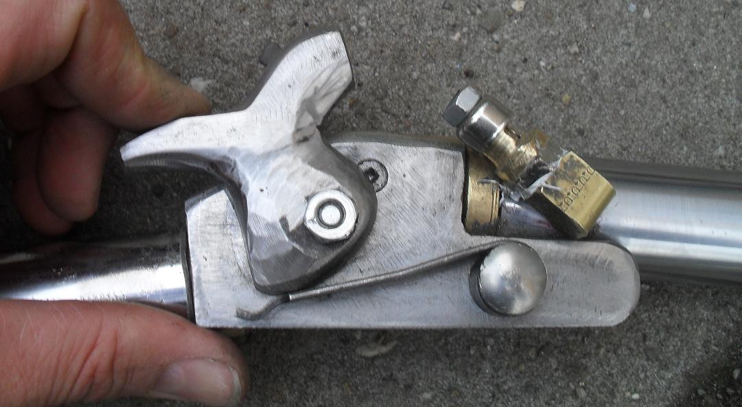

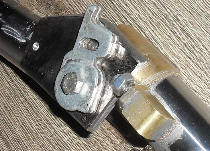

I haven't made the hammer yet as I had to work out the exact dimensions.
The leafspring has to be able to give it enough momentum to knock open the pilotvalve at fairly high pressure.The hammer needs to hit it at the right angle and have enough travel from " top dead center".
On top of that the weight needs to be just about right.
I worked it all out in a prototype hammer.
Without a trigger I simply cock it to the point where the leafspring keeps it in balance and give it a gentle push forward.
I managed to get 6 good shots from a 10 bar fill.
I still need to clean it all up...don't worry...

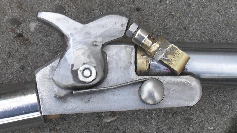

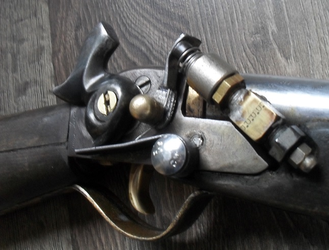

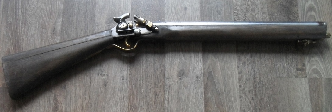

I got the hammer roughly shaped out now.
Drilled and then filed a square hole to fit the squared axle I made earlier.
One end is squared, the rest is round for smooth operation...with a large flat head on the other side.Like a disc.
I'll cut a notch in the disc for the trigger to hold on to.
The hammer still needs a lot of filing and sanding before it is done, but as you can see in the MS Paint sketch-up ( esp. for JSR!) I'm confident it'll fit the look I have planned.

That's an odd spring setup, so I guess the pilot valve is very easy to open.
