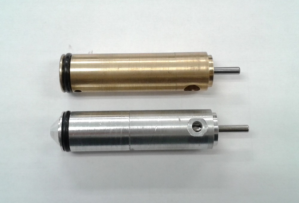

Finally found the time to make some progress on this:
Here's the new valve in brass compared to the old one in aluminium. Note the flat top on the new valve, I will be making a pump head to match soon.
This is what it looks like taken apart, note the balanced valve and separate eccentric check valve.
The valve is not exactly balanced in order to maintain a residual force keeping it shut. Even so, I was able to expand the porting to 7mm diameter over the original 5.5mm, while still having 20% less force keeping the valve closed.
The porting to the barrel is now 5mm diameter, though due to my pledge not to alter any original parts the barrel restriction of 3.4mm will remain.

Cheers all, it was nice to spend some quality time with the lathe :) also, this is the first hammer valve I've made from scratch.
Gippeto wrote:The results of your testing will be interesting.
It's been quite inconsistent so far, I've been fiddling with different springs... sometimes it gives an almighty bang, other times two or three shots - with the same spring and number of pumps!
I think I'm going to re-do it with some more thought. I can't have more than 5mm diameter counterbalance because of the need for the separate check valve, so perhaps I should go for a smaller port - say 5.5mm - to keep the difference minimal. This would mean that there would be much less stress countering the hammer, so the stem can be thinner.
Then not much will change, flow is limited by the lowest point.
Well, yes and no - imagine the difference between filling a bucket from a water bottle, and filling it from a hose. Same diameter, different flow speed.
I see you used a o-ring for seal, I made the exact same way for my airsoft gun. Even though the o-ring sits in a groove it sill get blow off some times and I was using much less pressure so bear that in mind...
It seems to have held so far. Pretty much the same as used in airsoft valves.
the new valve set seems to have less chamber volume than the original?
Should be a bit more actually.

wyz2285 wrote:Too bad I haven't find one for my lathe. I also made the piece longer and thinner in the end, still can't cut threads deep enough, can't secure the piece from rotating with the die...
This is what I had done before I got one ;)
I had the same issues with Dimply as it was the first time I tried it, have a look.
You need a way to bleed the counter-side in case some pressure leaks past the O-ring.
This can easily happen when you fill it from zero.
There is a bleed hole, unlike the diagram the threaded port goes straight through the counter chamber. Unfortunately I was unable to access the holes to clean them up properly so it tears the o-ring going past it afer a few shots, meaning I had to limit travel. This is why I want to re-do it.

Well, made a new valve stem, ironed out some bugs that were causing inconsistencies and failures and now it seems to be working great. So far, noise has been my only perception of power and up to the 20 pumps I've tried it just keeps getting louder! Clearly the sweet spot hasn't been reached :D
Did a quick non-scientific power test by putting an airsoft BB in the transfer port (6.5mm bore) and clucking bell! It went through a cardboard box!
My cellphone microphone really doesn't do justice to the noise, it sounds like a 22 rimfire at 20 pumps!
