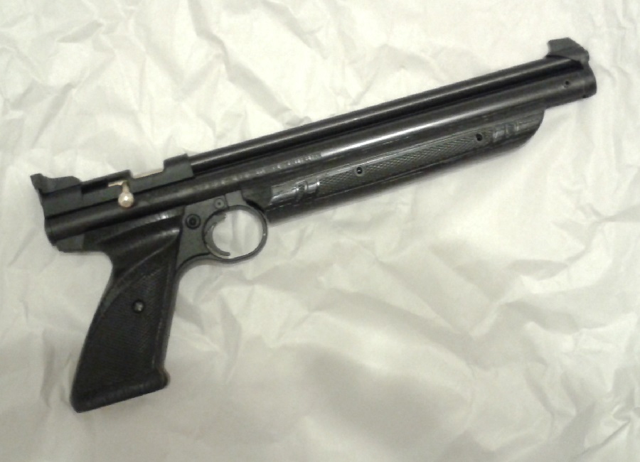

Crosman 1322
My first airgun purchase on the North American continent :D which arrived through the mail! Without any licensing or registration requirements! :shock: I know, I know, it's how life has always been here, but this is completely new to me!
[freedom intensifies]
Of course it cannot be left stock, the nasty plastic breech and muzzle block have to go but first, some revamping of the internals along these lines:
Removing the dead space in order to improve the efficiency of the pump, and a Brian the brain style balanced hammer valve to reduce valve stem resistance.
I will document the progress in this thread.

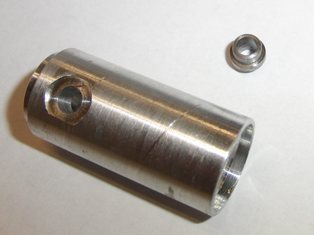

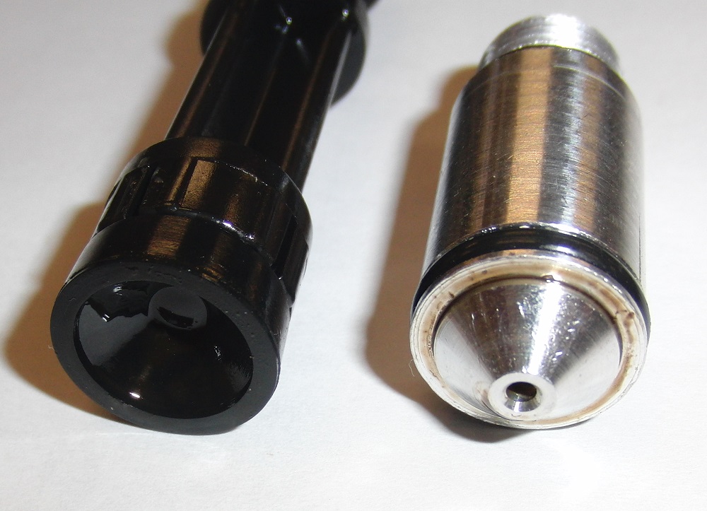

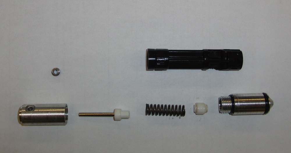

Took it apart this morning, here's the valve and pump piston:
There is a lot more work to be done than I originally thought.
The most disappointing thing I found was the transfer port which is a mere 3.4mm in diameter. For a 5.5mm barrel, that represents only 38% of the cross sectional area, a significant performance limiter. My original idea was to make any modifications reversible but I might have to change my tack.
Looking at the pump head, it seems to mate exactly with the valve, so there is much less dead space than I imagined.
Took some dimensions and put it back together for now, needs some thought :)

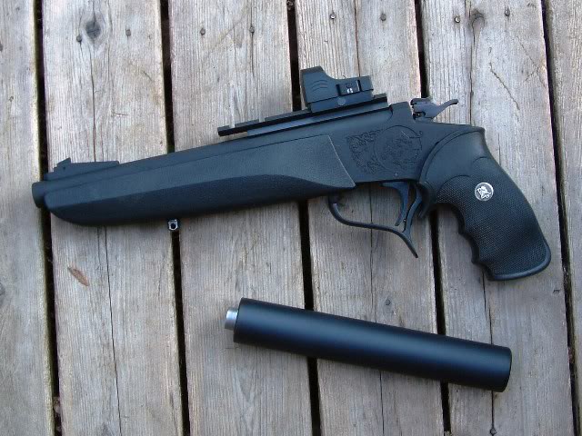

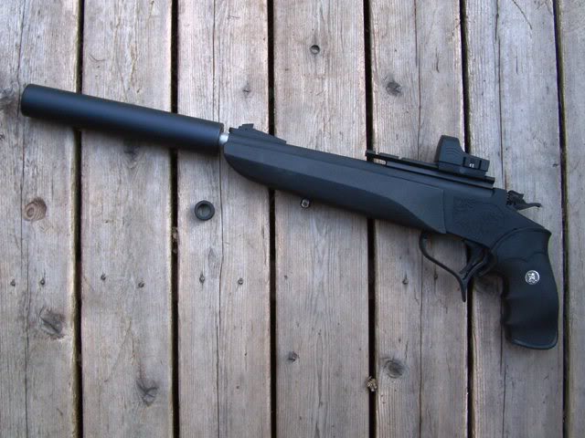

Aesthetically, this is the look I'm going for, a custom 357 Thompson Center Contender pistol which I have long admired:
Sadly suppressors are a big no-no here, but I might make a fake one in order to conceal a longer barrel.
Mmmmmm...
