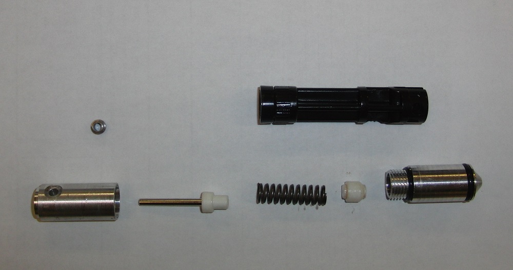

Of course it cannot be left stock, the nasty plastic breech and muzzle block have to go but first, some revamping of the internals along these lines:
Removing the dead space in order to improve the efficiency of the pump, and a Brian the brain style balanced hammer valve to reduce valve stem resistance.

Took it apart this morning, here's the valve and pump piston:
There is a lot more work to be done than I originally thought.
The most disappointing thing I found was the transfer port which is a mere 3.4mm in diameter. For a 5.5mm barrel, that represents only 38% of the cross sectional area, a significant performance limiter. My original idea was to make any modifications reversible but I might have to change my tack.
Looking at the pump head, it seems to mate exactly with the valve, so there is much less dead space than I imagined.
Took some dimensions and put it back together for now, needs some thought :)
