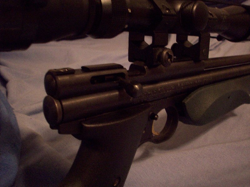

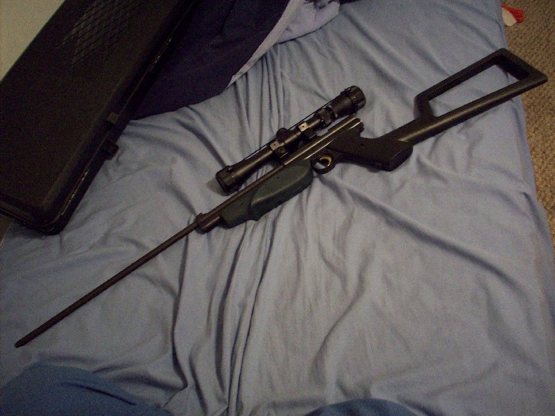

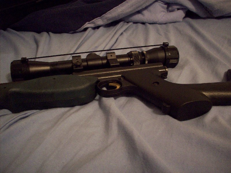

Whooie!! Finished my rifle/carbine. Range tests will commence tomorrow for accuracy of the setup. I'll have to wait until my new breech seal and mounting screw comes in to do any good velocity testing.
I decided to go with the 24" barrel and the 1389 pumper arm. So far, I don't see any problems with just boring out the existing barrel band to 7/16" to install the barrel, but there could be something unforseen. Mounted a 3-9x32 scope atop just for testing tomorrow.
Here's a few pictures.
An overview of the rifle.
Blued steel action.
Blued steel action.
Trigger and replacement pumper arm.
