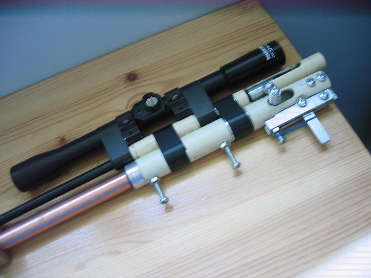

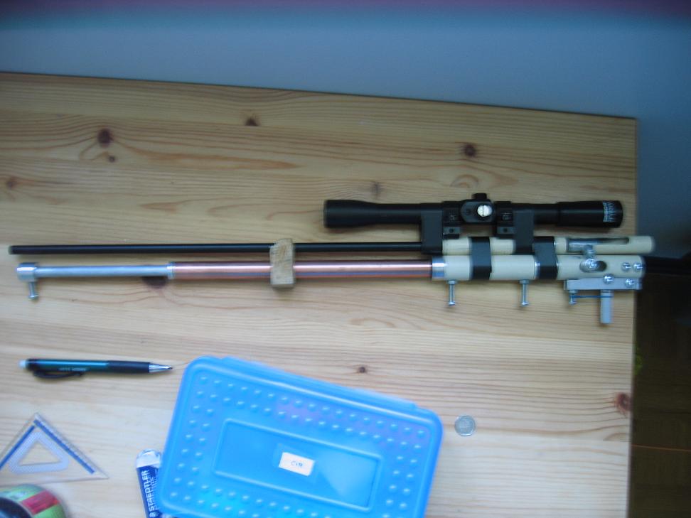

This is my latest carbine, took me 3 full machining days, approx. 24 hours of build time and it looks like a loss of time
Anyway, it made me learn and practice how to machine
Power would be 618 fps with .2 grams

nice action but wheres the stock?
- Gun Freak
- Lieutenant 5
- Posts: 4971
- Location: Florida
- Been thanked: 8 times
You should put a nice wooden stock on it, it would be cool. Why don't you want to? I don't understand the valve. Is it single shot hammer?
So what did you use?I dont have a mill and i did'nt used my dremel.
Looks really well made. Could you maybe provide a diagram of the inner workings?
interesting valve. But as others have said, this thing needs a nice wooden stock. Just buy small pieces of oak and glue them together. Should cost under $10 aud. A bloke made a how to about it, i cant link you to it as im on my phone

I used a mini-lathe and a drill press and other basic tools

Looks like a pump, chamber sealing valve with a physical latch on the piston instead of a pneumatic trigger, bolt loading and looks like it should be able to work. Seals not working?
Stuff happens. Going to redo it?
