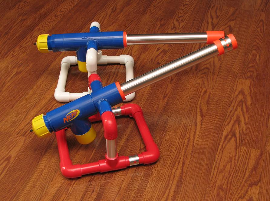

i sort of stole this design from that cheapcarbide.com site. His have a simmilar stand but thats about it.
This whole setup runs about $12. with the $1. grill igniter from walmart. Then a cut in half 9mm shell for the load. Ide say it sounds about like a 357 mag type bang its a sharp not to percussive bang and not alot of kick.
