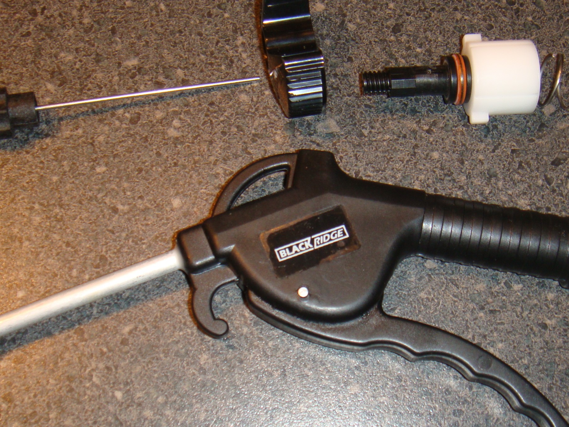

The solenoid valves open super slow. Modding the valve either with a blowgun or another smaller sprinkler valve I'll give you a dramatic increase in performance. You cannot have to large of pilot valve.
Using the solenoid, the valve opens with a whoosh. When you mod the valve with a blowgun they go pop, but when you pilot them with another sprinkler valve they go BANG!.

ok so I now have modded the sprinkler valve from the side (leaving guide rod ect in place),1/2 inch thread into the side of the valve,got a 10$ blow gun,just waiting for the epoxy to harden.
heres some modd pics

in the last picture the hole at 1 oclock should I have poxied that one?It joins up with a hole that runs to the exaust side of the bottom half of the valve.

I would plug the little hole at 1 o clock, it will probably allow the valve to stay open longer.

What an amazing difference the blow gun has made.As soon as I pulled the trigger on the blow gun there was a hole in my plywood target (spud ammo).Took it to 70psi.Amazing power.
