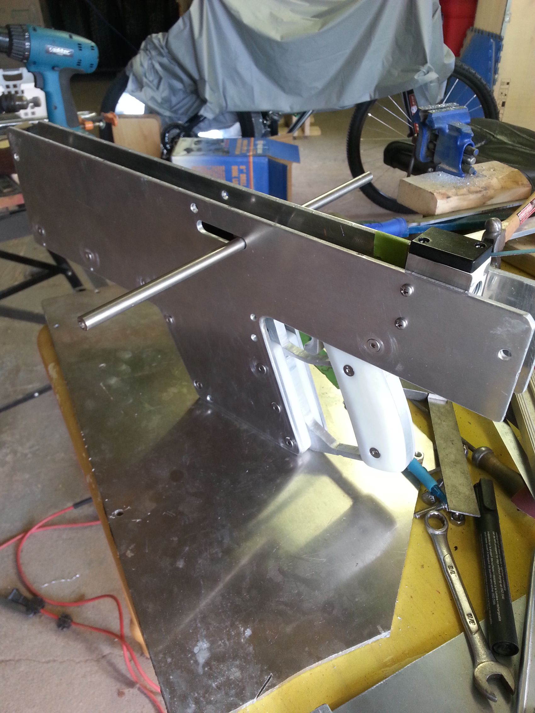

Started getting some more parts together

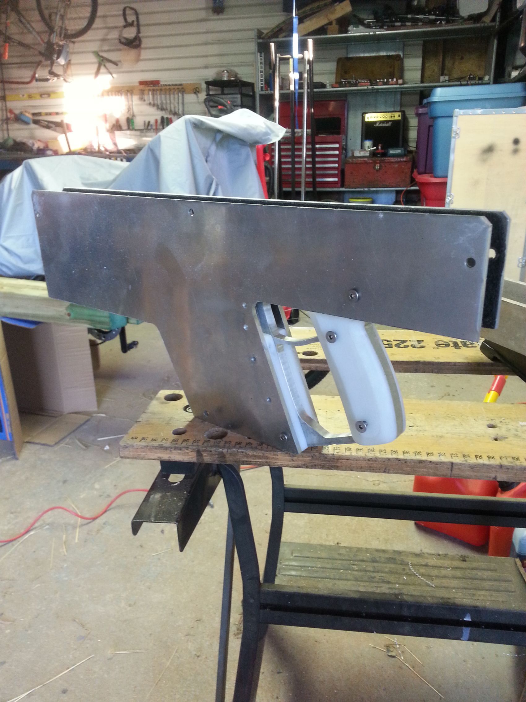

First trial assembly of the main body
Looking good, love the subtle-but-not Kriss Vector influence.

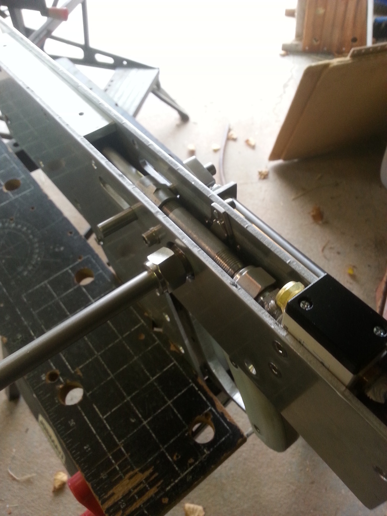

Some drilling, tapping and countersinking later.

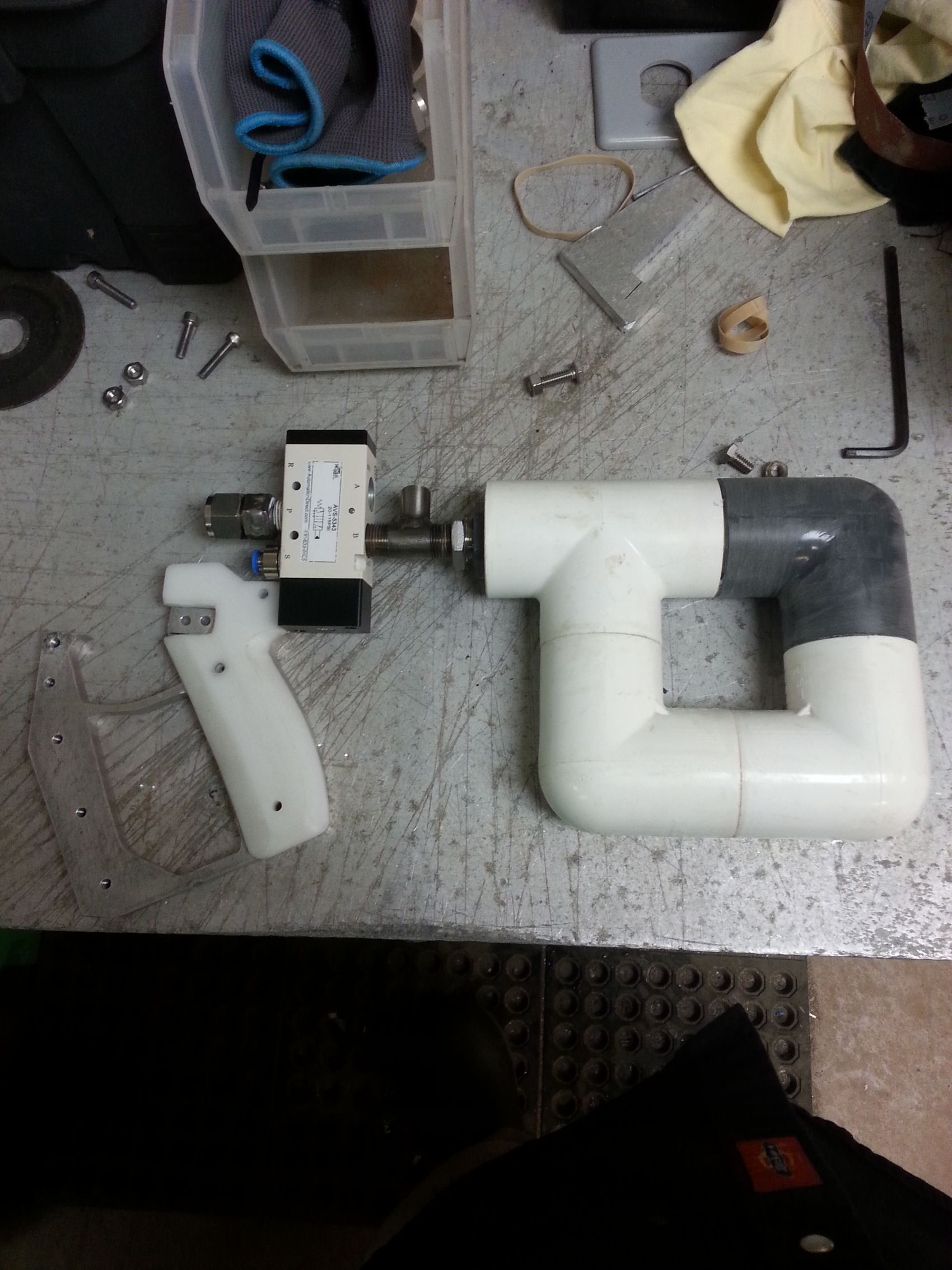

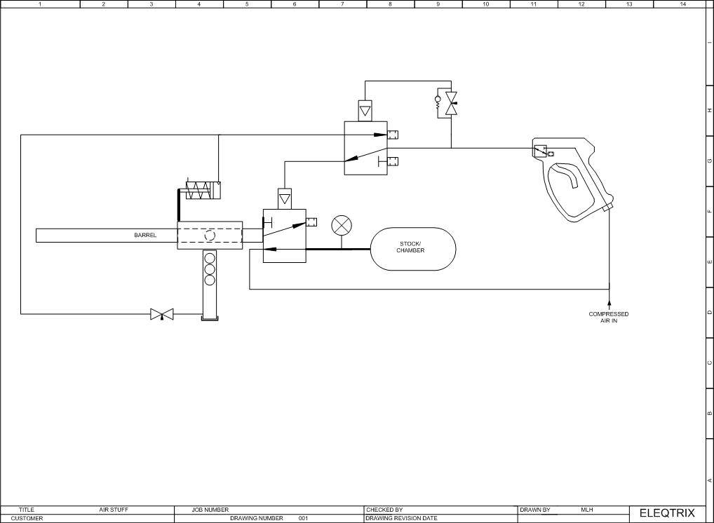

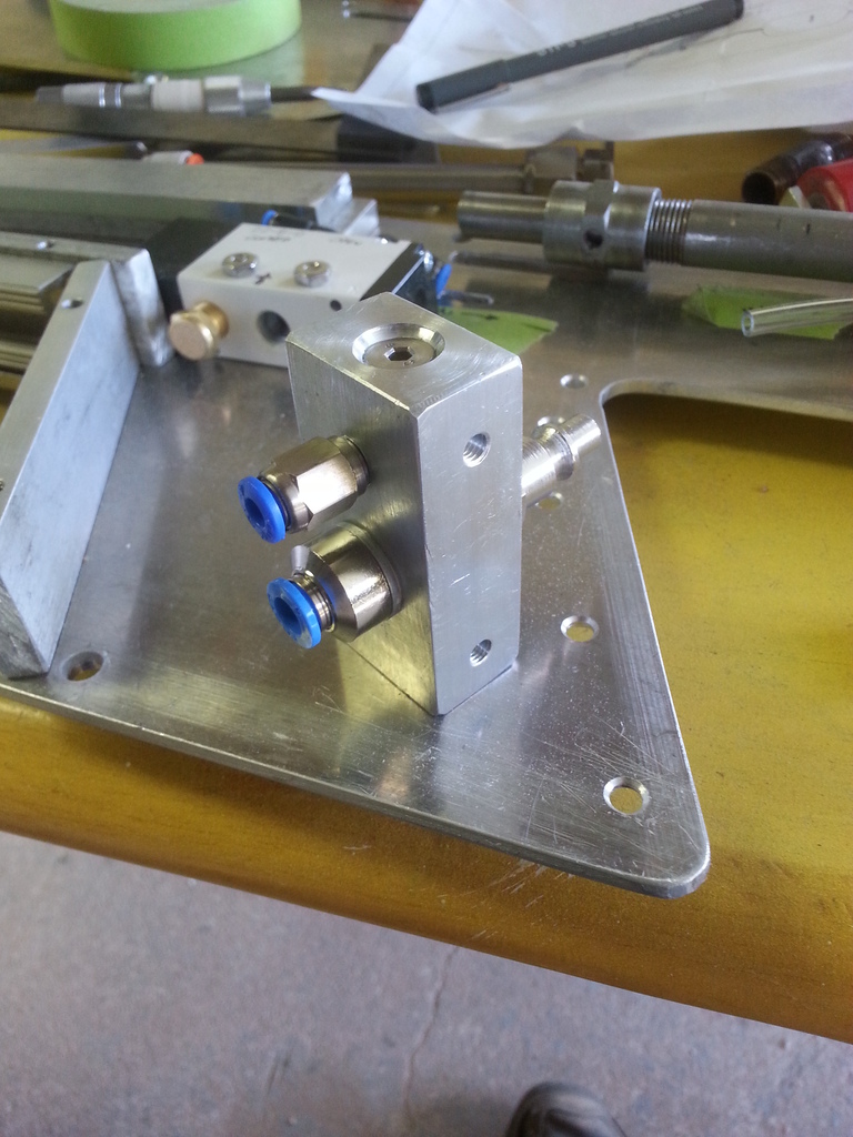

Another part made and fitted today, manifold for the air supply, 4mm for the pilot and 6mm to the chamber,

A few hours more work on it, it's slowly coming together
Still to do is smooth down chamber/stock and paint, fit the reload magazine and get it to work !, top rail to mount stuff like sight, sleeve over the barrel for silencer look, some plumbing.

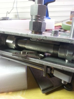

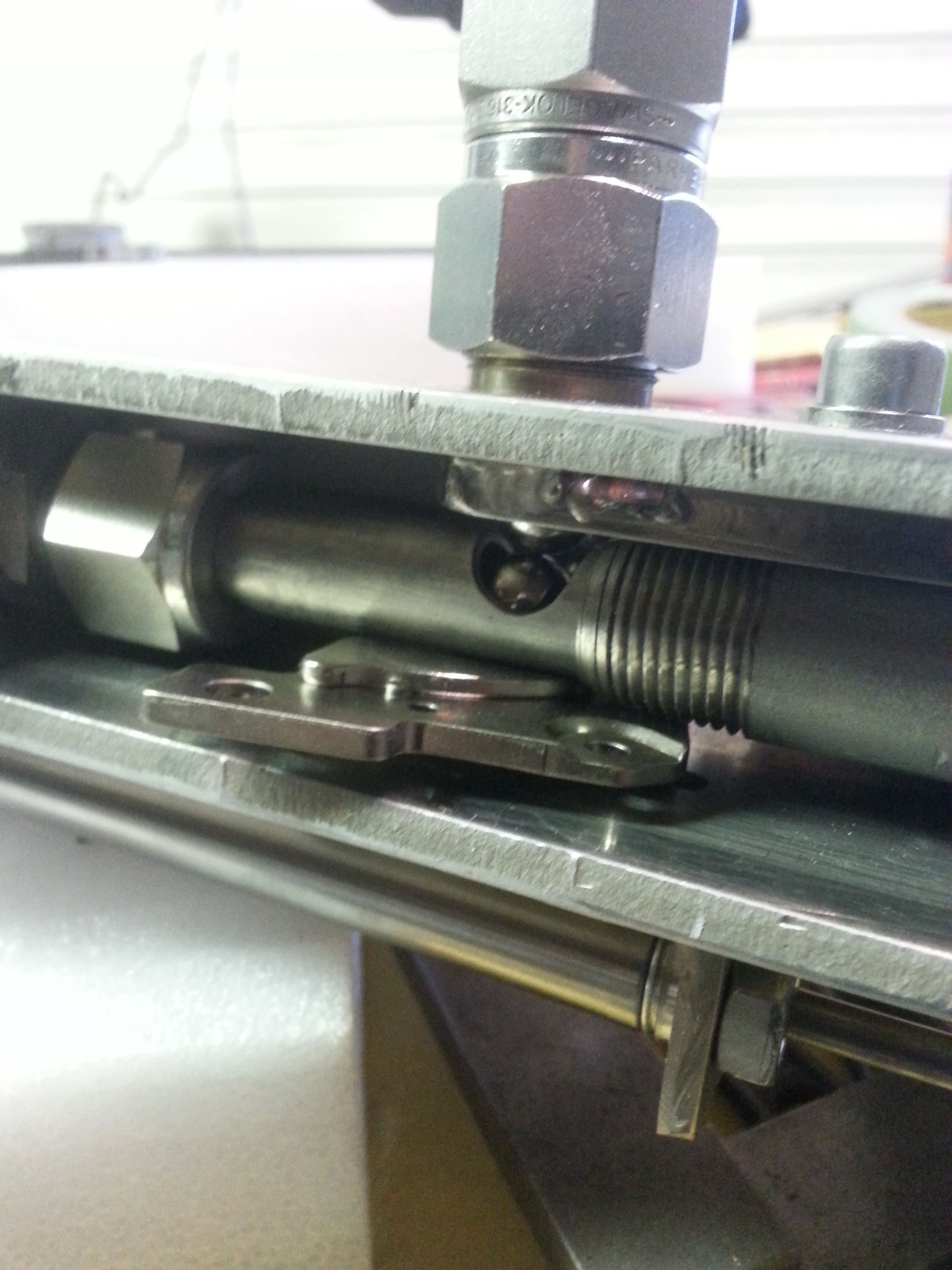

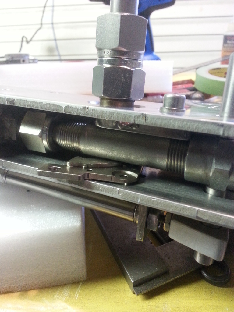

The loading system seems to work OK, just needs a bit of finishing
BBs in the tube, breech closed
Breech opened by acuater, first ball is held by magnet (I haven't fixed it in yet)

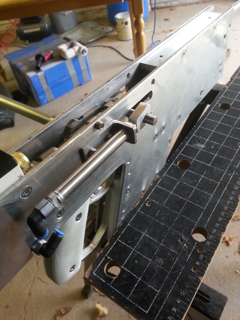

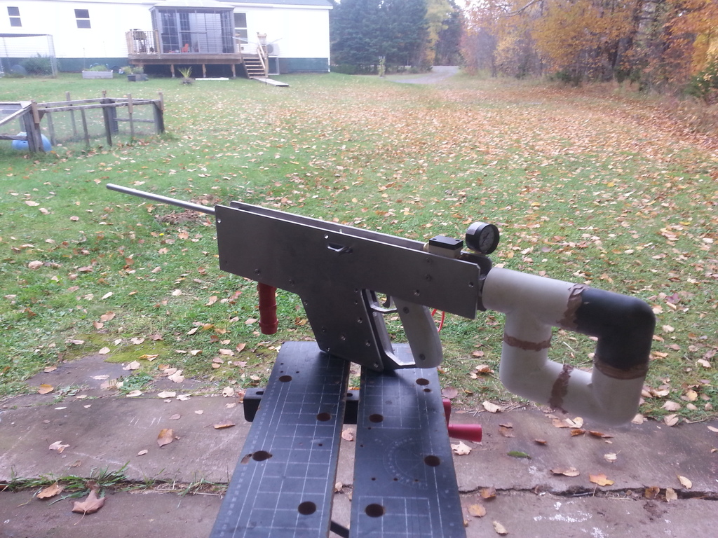

Got it all fitted in nicely
sharpshooter
Posts: 75
Joined: Wed Feb 08, 2006 6:49 pm
I assume the pneumatic piston on the right side will cycle the bolt automatically?
farcticox1
Canada
Posts: 1088
Has thanked: 69 times
Been thanked: 103 times
Yes, that is the plan, nothing has been powered yet though.

Found a cover of an old CCTV camera, it's gonna make a sweet sight, going to have a lazer pointer as well.
