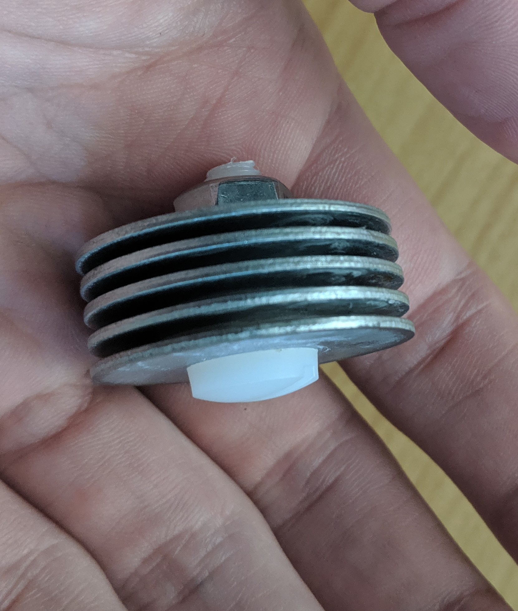

Either way, I built a cute little HHO core yesterday and I'll be testing it out soon, I'll post my results on trying to get it to pressurize it's own gas.
It has only one positive and one negative electrode on either side with 3 neutral plates in between (this is because I am attempting to run it off of 9 volts). The plates are made of zinc just as a test until I can find stainless steel, I know they will rapidly corrode.
