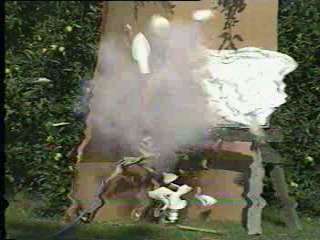

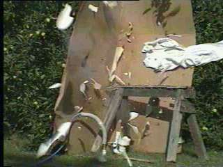

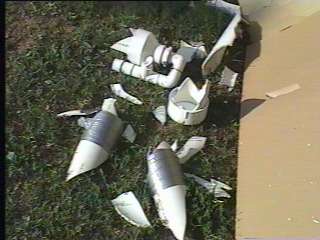

I think it is irresponsible of you to find one video of CPVC being tested with water and conclude that PVC doesn't grenade and many members concern for the safety of others is unfounded.
PVC
PVC
DOES
DOES
GRENADE
GRENADE
woah where did you find those pics? i thought it would nade, i just didnt see pvc just bursting.

Thank you Clide. I was going to show them myself but didn't have the right fittings to go from a CO2 bottle to NPT right now.

PVC does grenade. I have had much, much experience. Sometimes only a couple of peices, But more often than not, too many to count. It causes serious wounds and felony charges.

I wish i could remeber where i saw the video that clide's pictures are from. It makes the stills look like nothing. I believe that the chamber was also wrapped in duct tape, which obviously had no effect, but i'm not 100 % sure.

Im sorry clide. I did not go out looking for this video i just saw it and thought i would show it. Now i will shut up.
BTY Could You post the video.
clide
Posts: 784
Location: Oklahoma, USA
As Don indicated, the pics are from a video posted on the web awhile ago. Unfortunately the site is no longer working and I couldn't find the video archived anywhere. There is a chance I have it archived on my home computer, but I am at university right now, so it would be a week or two before I even get a chance to look for it...if I remember.
