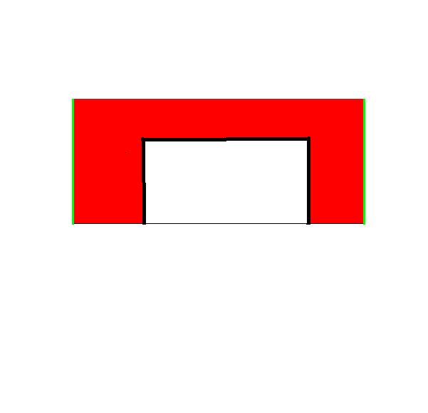

ramses
Posts: 1679
you could put the cap in some kind of disposable contariner and then cast epoxy on the outside.
red is epoxy, black the original cap, and green some kind of disposable container.
Make sure that no epoxy can get into the part of the cap with the threads.
I started captioning the picture, but then realized that google translate wouldn't affect it.
or you could buy a metal cap, as long as the threads are the same.
The flat caps in your picture are not built to handle any pressure. They are a dust cap. A cap built to withstand pressue is often domed in shape. I have found ABS to be much less brittle than PVC so it less likely to shatter, but it is softer so it may be more likely to blow off. In places where you can't buy a proper threaded cap a female adaptor with a short length of pipe and a proper glued pressure cap may be the solution. It lengthens the chamber somewhat and appears what Shurshot is using on their cannons.
The cap is a female adaptor, short length of pipe and a cap.
