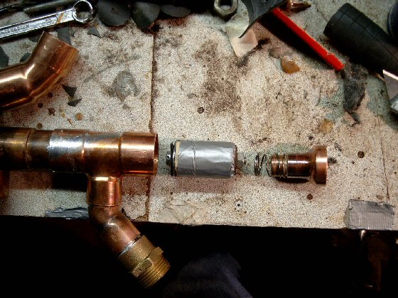

Thx for the compliment. I guess I am realy lucky then. My first gun ever was a pneumatic, this is the second. Both worked fine. BUT... I have to sai I did a few weeks of research on the net, and especialy here on this forum (that's why I'm still here
) before trying to build one.
My adive is start with the valve. Try to understand that part, the rest is peanuts. If you are able to build a valve, you are able to build a pneumatic gun.
A barrel sealing piston valve. Watch the pic.
Got to say though, that taht spring and bumper din't work. Well, it did work, but for a short time. The bumper (copper part on the right) was smashed completely by the power of the piston. It had way to much moving space. But the gun works.
My next gun will have a small movement piston.
