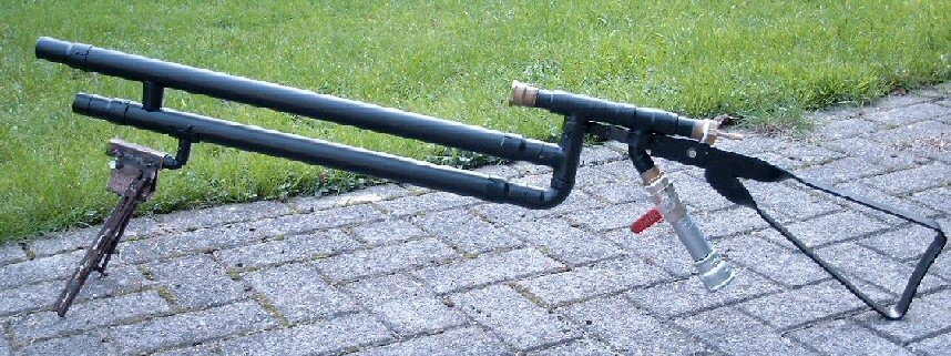

MB2 (Marble Blaster II)
[albumimg]233[/albumimg]
Here it is, my second pneumatic gun, only two weeks after I finished the first one :
* as I sead, it is pneumatic
* made fully out of metal (copper)
* uses barrel sealing piston valve
* pilote valve triggered by a 3/4 balvalve
* dual chamber 34 mm copper pipe
* rest of the gun is made at 28 mm copper pipes and pices
* pressurizing valve is a bycicle tire valve
* C:B ratio, depends on the barrel type, at least 2:1 with the 34 mm barrel

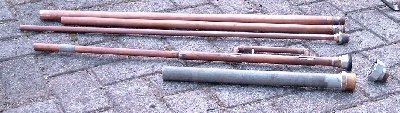

* it has exchangable barrels, 10 mm, 15 mm, 18 mm, 22 mm, 28 mm, 34 mm and a 1 inch galva barrel

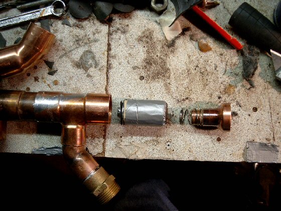

I testfired it, and it leaked at the piston valve. So I changed the rubber, nog it is ok. I could only testfire it at 100 psi, dont have more pressure untill my high pressure pump is ready.

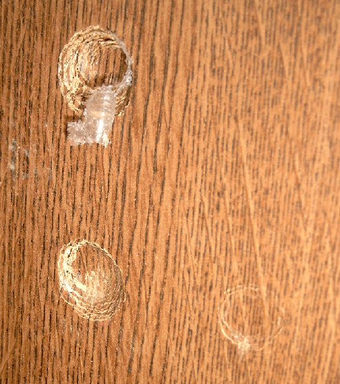

Here the damage pics :
[albumimg]236[/albumimg] [albumimg]237[/albumimg]

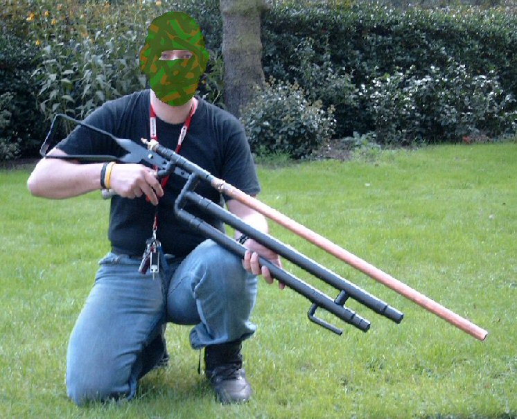

Me holding the gun, so you can see the size :
[albumimg]238[/albumimg]
Improvements since the MB1 :
* shorther space between the piston valve and the ammo
* bigger chamber
* better piston
* ighter than a galva gun
What still needs to be done :
* make a wooden stock
* make a wooden handgrip in front
* give the whole thing a paintjob (will be non-shining black)
Now some questions :
What about this gun, you like it ?
What can I do to improve ?
At what pressure you think I can shoot this one ?
Do you like the concept of the twin chamber in this gun ?
Edit : forgot to mention the cost : about 100 euro.

:D I like it man and I love the ammo. What kind if rubber are you useing for the barrel seal ??

wow nice copper gun,if you put a wooden hand grip on you should get that grip paper stuff that you find on rifle stocks at the front :twisted:

Nice,but the pics are a little small to see the in good detail.And yes i like the twin chamber and i wouldnt be afraid to take it to 250psi 17bar.

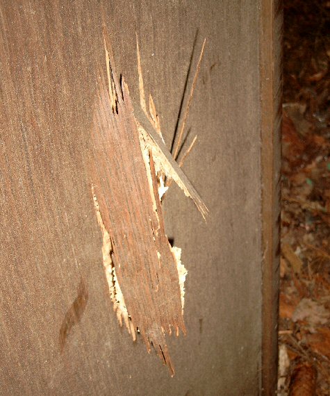

Backside of the second wooden plate. Damage mainly caused by the third shot
the damage at the second plate. Notice the difference due to the use of (different) wadding behind the marble

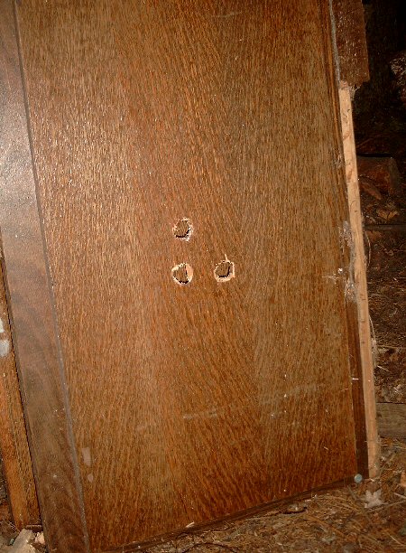

I testfired three times at a thin wooden plate (4 mm) and a thicker plate (2 cm). Here the dammage at the first thin plate, nice round holes of 25 mm :)
Me and the gun, to give you an idea how big it is. It holds very confortable, notice here the bipod is unmounted

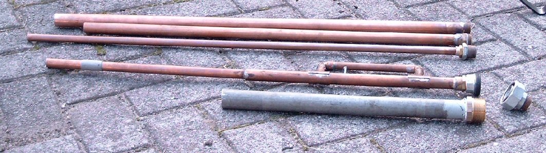

All the barrels I have right now. Notice the second barrel from the bottom, is a recycle of my MB1. these barrels are 15 mm, 18 mm, 22 mm, 28 mm, and a 1" galva dirt blaster

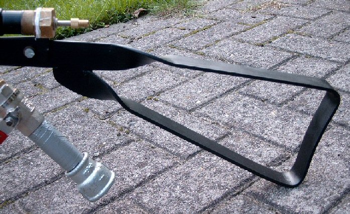

Closup of the stock. This is made of 4 mm thick steel, heated, twisted, hammered and welded.

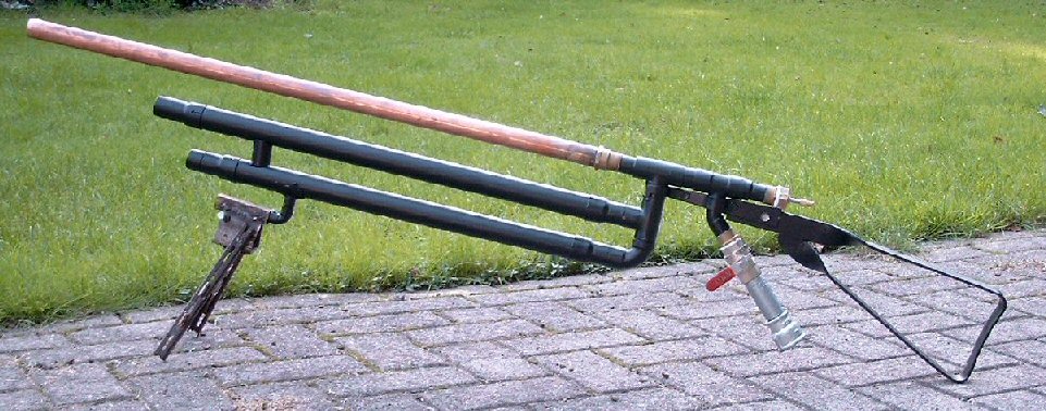

The gun with the "shot gun " barrel, shoots big marbles of 25 mm.

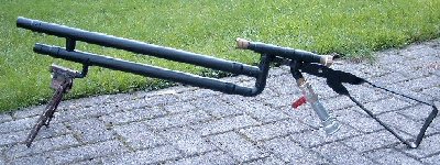

The gun "naked" gun without a barrel, sprayed black and equiped with a steel stock

Man!, that is really cool! I really love the stock, it gives the cannon such a threatening yet awsome look. :D
I think you should try make that as tough as possible, by renfocing the chambers. Great work :D

I just tried a distance shot. I put up a target, a wooden plate (the second plate in the above pics) up to 25 meter, halfway my driveway. In front of it, I put the first plate from the pics above. I lied down at the door of the house, aimed for the top of the plate, cause the bullet always drop in his flight (I used a 25 mm marble) and shot the target at 8 bar. (110 psi) I didn't even hit teh first plate. The bullet only dropped a couple of centimeters, hitting directly on the second plate, en flew clear trough (nice round hole, and major damage on the backside. After I heard it hitting the wood, I heard a 'ting'-noice. The bullet flex further of course, hitting the steel gate. I went out to see if the gate was dammages, and unfortunaly it was. One of the vertical steel pipes had a dent in it. The gate was 50 meters away from the gun.
I was very pleased whit this performance 8)
