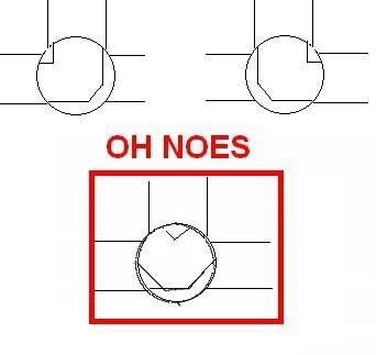

Brian are you thinking about using a 3way ball valve to divert presure? cause you should know that 3ways can't divert presure because the ports are too big, I thought of that one untill I realized that the ports in ball valves are so big that at half way all openings are conected/flowing. I'll get a pic to show you and others cause I'm afraid many people mistook 3way ball valves as a a way to divert presure in spud guns and such

try again after seeing this...http://en.wikipedia.org/wiki/Ball_valve

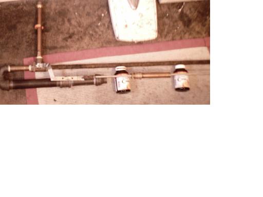

I 've been working on something similar although a lot more basic for a while.
I am starting with a 3/4in Apollo 3w ball valve housing with 2way ball valve guts
Everything else is pretty much changeable
control will be a sear/hook and spring to open the valve
and a gas piston from a t fitting off the barrel to reset the valve ,
I am aiming for 400/650 cycles per minute, not so much to conserve air as ammo and to be somewhat more realistic .
The pic is a far from finished ,rough idea

- start.JPG (15.99 KiB) Viewed 3987 times

i see complete and total potential of jamming, no offence. good idea with ball valve but big ball valves are hard to turn and that wouldn't realy be automatic, it would be a complete pain with a low fire rate._Fnord wrote:The problem with ball valves is there is only a relatively short period of time when they close completely, and the rest of the time they are open to a degree.
what you need is something like this:
(note; this might not work, and might not be a new idea, but I though of it myself a minute ago so its new to me)
