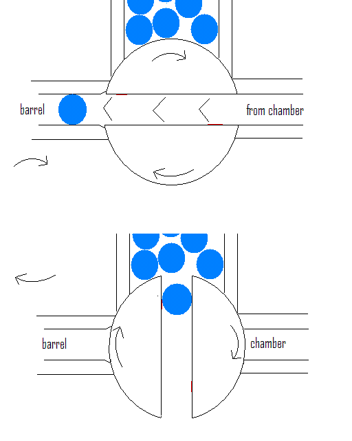

The problem with ball valves is there is only a relatively short period of time when they close completely, and the rest of the time they are open to a degree.
what you need is something like this:
(note; this might not work, and might not be a new idea, but I though of it myself a minute ago so its new to me)
- there might be some problems with the timing involved in the rotation, such as the projectile not leaving the valve quickly enough and getting stuck, but Im sure with some pressure tweaking it could be made to work.
Feel free to try making a gun with my design. - dfgsad.GIF (7.8 KiB) Viewed 12954 times

air will only flow when its in the perfect 90 degree position, on a ball valve air will flow when the valve is in almost every position other than 0 degrees
so air is leaking so much it can dump a small chamber untill the projectile has enough space to actully exit the barrel even break certain projectiles
this concept has been used for single shot breechloaders very sucessfully but not like this
