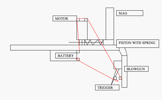

this is the diagram for my electric version.
- the trigger for the blowgun when pulled releases air but also when pulled it makes contact with the two wires which completes the circuit and turns the motor which pulls the piston out which lets another marble down and then when the motor stops turning it springs back in place for the next shot.

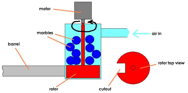

If you´re considering the electric route, here´s a design I've been wanting to build for quite a while - it´s not as complex as yours, there's only direct rotary motion from the motor (which lets you directly control the rate of fire by varying the rotor speed) and if your rotor is a reasonably tight fit in the chamber, then only a minimal amount of air will be wasted between shots.
- rotor.jpg (25.69 KiB) Viewed 2858 times
YOUR A GENIUSwell with your permission may i go ahead and make your design?
I already realised that my electric design posted was flawed.I came up with a simpler design but your one is more solid my one was fragile and it would be very unreliable.
On your design i'm thinking of using a blowgunu as the valve.
Also i think ive got most of the design but i think that the air which is coming into the chamber pushes the marble out as well.
Anyway Thanks alot for these designs Jack and thanks for helping me mod my own.
With your permission id like to make the electric motor design you put forward.

You don't need my permission, feel free to make the design if you have the right materials
I might have a few other configurations at home, I'll post them later if I find anything useful.
I don't think a blowgun will give enough flow for a marble gun.
