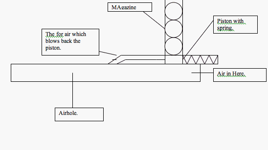

Gas operated Marble gun.
- this is it im gonna make it into an LMG style frame.It should be sweet.
- Snapshot 2007-05-11 18-25-00.gif (7.77 KiB) Viewed 6803 times
Poo.
Sorry to burst your bubble but I'm almost sure it won't work at spudgun pressures. Remember that firearms that use this system have chamber pressures in the range of 30-50,000 psi far higher than anything you could have in an amateur pneumatic.
Of course there's only one way to find out, feel free to prove me wrong, but I'm pessimistic.
ah well.i'm not going to attempt it unless i know or have a really good idea if its gonna work so yeah.
I just wonder.........................mmmmmmmmmmmmmmmmm. i wonder if i had another tube fram the same blowgun like an air hose with a fork in it leading to the barrel and the piston but with the piston one longer so it takes a longr time to get there and so it goes full auto that way.Though it would have been nice to have it like a real gas powered gun.

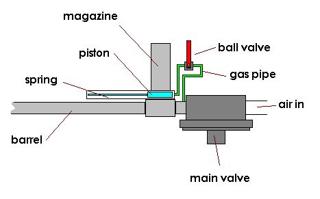

I think you should be looking at the direct blowback system for inspiration, which is what low pressure firearms such as the Makarov PM use, and also the mechanism I adopted for my cartridge fed prototype.
If you want to stick to a separate gas line for the piston, then having the line fed directly from the valve has a much better chance of working. It would be a good idea to include a ball valve on the line, so you could adjust the flow of air until you get optimum performance.
yeh ive already designed a blowback system for a pistol i am gonna make when i get some cash.
But if its not too much too ask you could you please draw me a diagram or describe to me in detail your seperate gas line idea? you dont have to but im having trouble visualizing it.

idea:
note that the ball valve is only there so you can adjust the airflow until you can find an ideal position for the best performance, once you so this you can lock it in place.

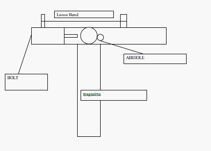

- This is the design i had for a pistol but for this instead of using a band i use a very light spring behind it in the barrel.And i might also put the magazine on top intstead of below to save on springs.
more info on this design
http://www.spudfiles.com/forums/semi-auto-marble-gun-t7904.html - Snapshot 2007-05-02 18-55-43.gif (5.11 KiB) Viewed 6735 times
Poo.
again, shouldn't the air hole be between the projectile and the bolt?
yeh what that is a picture of is rior to the thing loading that is the gun when the Marble comes up from the magazine and before it gets pushed into position.When it fires its all up in place with the air hole in the middle.
im just wondering if there will be enough pressure to push the bolt back as well as shoot the marble a considerable distance.
