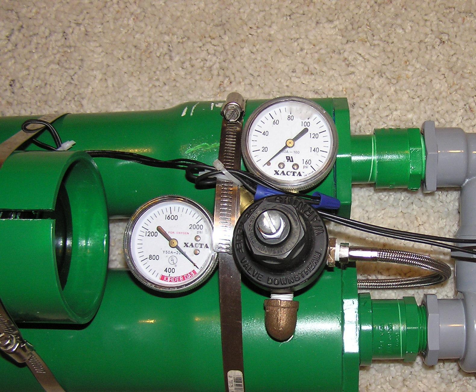

Also if you mean that your going to connect CO2 DIRECTLY to the gun and release the pressure before it detonates, DONT!!! CO2 should only be connected to a pvc gun if their is a regulator. A CO2 tank has about 1500 PSI, PVC is rated to only 250 PSI, See a slight problom their? HINT-BOOM!! Also try a regulator like mine if you are looking for a cheap alterative to a paintball reg sorry one sec on that picture
