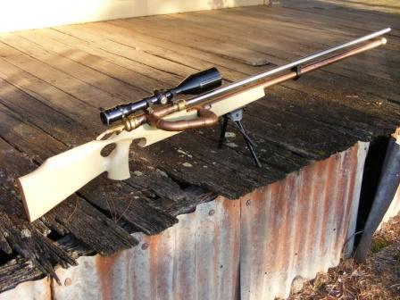

Okay, I've been holding out on you, I've been working on this new project for a few weeks now and really wanted to wait 'til it was complete with a stock and a paintjob and everything before I posted it but I got it running yesterday and broke the stock in half today and well... you know how it is...

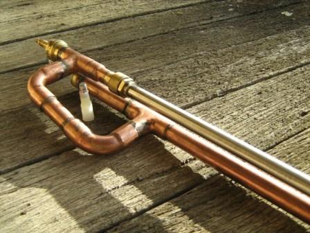

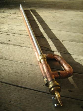

So, its a copper/brass/stainless piston valve pneumatic running on good old-fashioned squished air. The chamber is about 3 feet of 1" class 'm' copper and holds 650mls of water, the barrel is 1m of 3/4" stainless (with an ID of near enough to .700 of an inch, hence the name...)

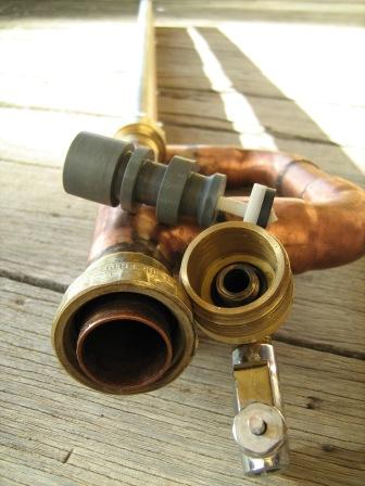

The piston is delrin, turned on a wood lathe (as were many of the brass parts... :oops: don't try this at home...) with a tap washer that i threaded and screwed in as the sealing face, the whole piston weighs 25 grams. It had an o-ring but it sealed too well so I pulled it out and it functions perfectly without it.

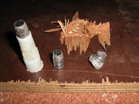

The projectile is (was) a 310 grain pure lead .430 (44 mag) slug stuck in a silicone nozzle and half-filled with 5min epoxy. May have to re-think the projectiles as I suspect some of the 'skirts' may be blowing apart in the barrel.
The shot in the photo (@200psi) went over the chronograph, through a plank of marine grade 9-ply and stopped up against the steel plate back-stop.
Projectile weight 25 grams (385 grains) @ 343 fps = 100.55 ft/lbs!

Edit: I have added a new 'progress' photo of the stock now nearing completion, but had to remove a few photos of the piston etc to fit it in...

Nice, is part of that piston one of the tap washer things? Cool build..I'd just do a stock and polish up the copper nicely...then you have one mother of a gun.

Pookydarts wrote: The projectile is (was) a 310 grain pure lead .430 (44 mag) slug stuck in a silicone nozzle and half-filled with 5min epoxy.
Can you explain that better, how are they lead and epoxy?

Good job using a wood lathe to turn your piston. Looks like you put some thought into it.
If you wanted to try the o-ring again, all you need to do is drill a shallow hole into the side of the piston.
Drill the hole so that it is "half" in the o-ring groove, and "half" on the chamber side of the o-ring groove.
Gippeto,
I must give credit where it it due, the piston was modelled off your 'protruding' past the bearing surface piston from your copper gun, the only thing I could do to make it different was 'skeletonise' it for weight saving.

Looks fantastic, I like your ammo, looks very stable and powerful, and I don't believe I've ever seen that method of having an over under cannon before,
Overall just awesome looking!

I like the side by side, lane change design, really just for the different look and uniqueness of it. It might not hurt to tie them together to keep them from clanking against each other.
Great work on your piston, and the cannon overall!!

Starman, the barrel will get fastened during the future upgrades... And I hope it will deserve sights too!
