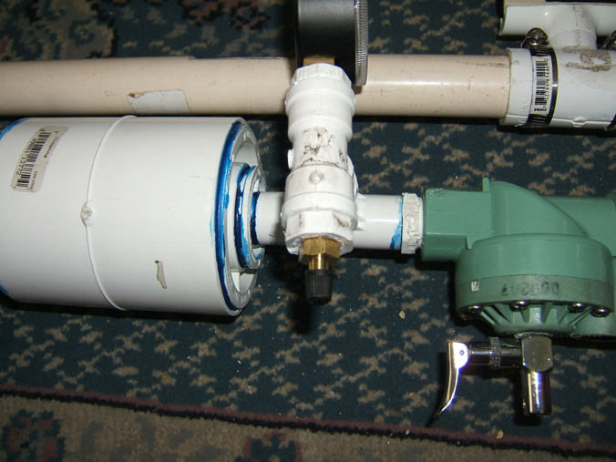

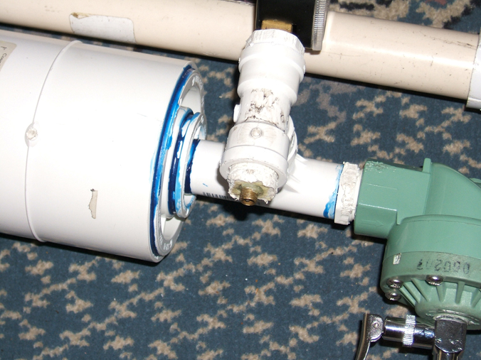

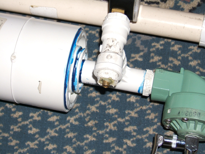

The threaded schrader looks much cleaner and sticks out farther in my case. Epoxy'd bike valves tend to leak. Threaded fittings will not leak provided that you use Teflon tape or some other threaded fitting seal.
