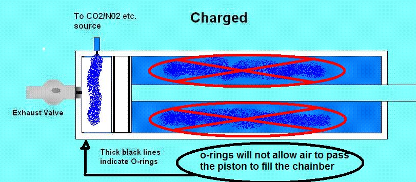

Your pressure is only going to build up behind the piston, not chainber.
Your only other option is a piolet valve, it has to be just the right size for maximum efficency.

The piston valve you show will not fill up the chainber because the o-rings will trap the air behind the piston.
- read this
- gun drawing.GIF (32.85 KiB) Viewed 1879 times

Sorry, I forgot to mention it must have some sort of somewhat restricted flow into the chamber. You could simply drill a hole in the piston (not the middle) small enough so it will still go back but big enough to fill the chamber quickly. Just like a normal piston co-ax though the "leakage" is through the piston, not around it. And depending on how big you make the pilot area, if you place a large valve on the back, you will only be 'wasting' that area of pressure, give or take a little. And honestly, it wont be that much really.

us sniper: I would go with a piston valve in a tee and the chamber can double as the grip. For the pilot valve I would put a sleeve valve on the back. This can be found on page 435 of mcmaster. This will also make it semi-auto (just the valve not the loading system). You could construct the trigger something similar to clide's semi auto paintball gun: http://www.spudfiles.com/forums/semi-auto-t160.html
