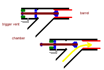

With a 67.5 degree cut, the length:width of the piston and the barrel end becomes the same ---> better fit, smaller piston.
With a 45 degrees barrel cut, one will then need a piston diameter quite a lot larger than the barrel diameter - but ok that brings us back to:
I drew up the situation. Maybe there is a single solution for both problems.
But ok it WILL be a somewhat large piston for the barrel. Something like 71 mm piston OD for a 50 mm barrel OD. On the other hand, construction is simple (90 degrees piston end).

Maybe the best cut is somewhere in between 67.5 degrees and 45 degrees.
If you have a good piston (o-rings, a check valve, and low friction) then you can get the sealed face area very close to the piston surface area in a barrel sealing valve.

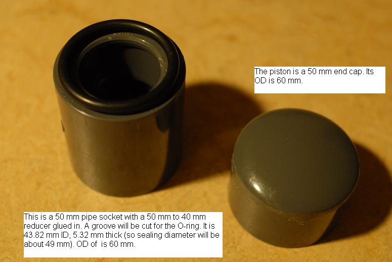

Hi,
I was out at that koi-breeder place, and although they had beautiful PN10 (or was that even 16??) wyes and also 45 degree elbows, I ended up shopping for a regular tee barrel sealer.
Can somebody with experience in this tell me:
- Am I on the right track with the sealing ring diameter vs. the piston diameter? (49 mm : 60 mm) ? Larger seal diameter? The next O-ring I can get (apart from metric, which I didn't consider) is 46.99 mm ID; that will be 57.65 mm OD, which will leave very little wall after a groove is cut in a 60mm OD fitting. On the other hand, a larger (and maybe thinner) ring could help me eliminate the reducer in the valve seat.
The O-ring is quite hard; NBR 90. I also have an NBR 70 to try with.
- Is there a fair chance of a reliable seal with this stuff? Or will the O-ring not be able to withstand the pressure of the whole piston on it?

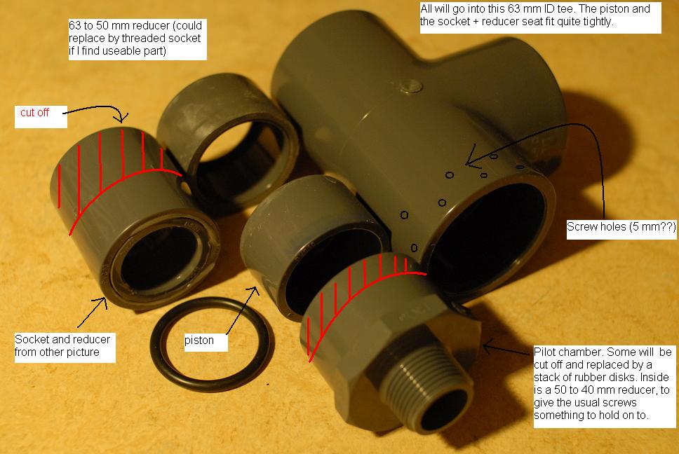

The tee has the usual two different diameters: 63.1 mm where pipes are supposed to be glued in, and it then reduces to 60 mm where the pipes are supposed to stop. That is the beauty of it: The valve seat and the piston can just be hammered into the 60 mm part. I might not even have to glue the seat (a 63 to 50 mm reducer outside it will hold it in), but may need to machine down the piston a little. The back of the piston will stick out into the 63 mm part of the tee, and I will cut a groove in very back of the piston for an O-ring that will serve as a guide. I could get a real piston ring too (how cool!), but the piston and the tee are too short for that.

Looks like you're on the right track for the standard piston valve.

As for the inline valve, noname used a diaphragm. I used a piston made of PVC rod with a .25" neoprene sealing face and a custom made PVC washer to keep the piston from sliding off the piston face.

OK I might build the valve of the original plan one day. I will have to find exactly the right thing to use as a piston first. Lathe access is very limited for me here .. ultimately maybe I have no choice but to pay someone to make the bare minimum number of cuts...
I'm less enthusiastic about the 45 degree cut valve .. a 70 mm wye is bulky and expensive (3 times the price of a tee, and 3 times that if a 63 mm wye), and I will have to fill it up with reducers and only get 50 mm piping. I could make 2 regular tee barrel sealers for the same price and mass (well ok I will need a third tee to join them but still...)
