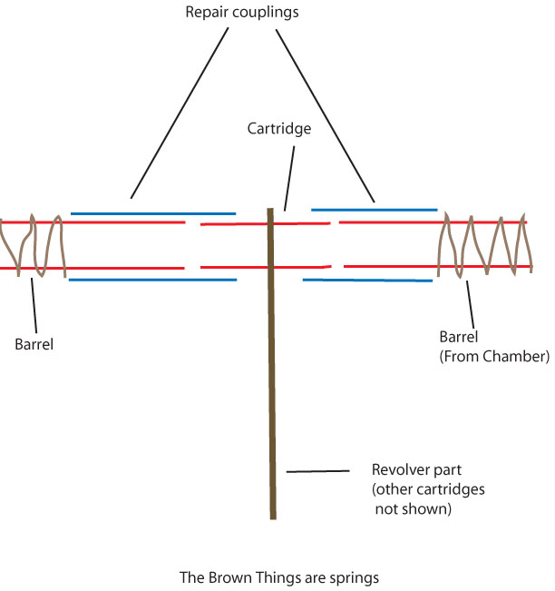

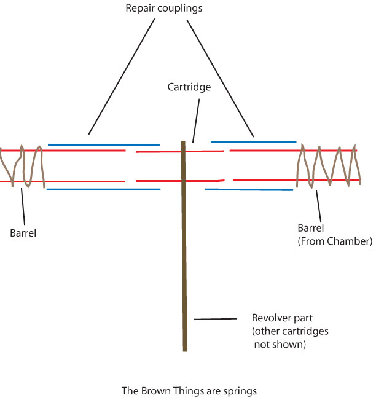

That could be a solution, in the same way the Nagant pushes the cartridge forward to seal against the barrel.kablooie wrote:The only other dilemma would be sealing each cartridge. Maybe I could have something that would seal it during the shot but blow forward as well. (a repair coupling?) Thanks for all the help!

im pretty sure that the nagant's cylinder moves foward when the trigger is squeezed. you see that thing between the barrel and cylinder that looks like a spring? i think that is what creates a seal between the cartrage and the barrel. then it moves back after it has fired so that it can revolve and line up the next round and move foward again.
so to answer your question, both the breech and the shell move.
notice- i think thats how it works, but i cant garentee it. if i made a revolver thats how i would do it. im pretty sure im right, but the world will never know unless you google it.
edit- i didnt see your diagram. its a good idea, but it would require alot of work. i think that the Revolver X works something like that.
second edit- i wonder when spudgunner's will reach the technological limits of pvc pipe.

Oh, I think I understand now, the force of the shot pushes the cylinder back into it's position. So maybe I could have the repair couplings stationary and the cylinder move. now that I think about it that wouldn't entirely solve the problem, because it has to seal on both ends. I might end up using a ram to force the couplings back.

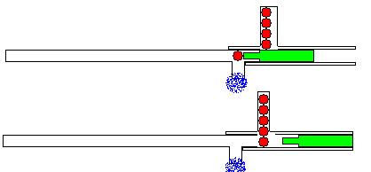

Kablooie, if we keep on spoon feeding you like this we might as well make the gun for you
Okay, one last bit:
The green is the bolt, red is ammo, and the blue fuzz ball is were the chamber/valve assembly would be attached.
The bolt handle (not shown) should ride in an “L” shaped groove. When you want it to cycle automatically you block off the locking area of the “L” groove and put a LIGHT spring on the bolt/charge handle, some people use rubber bands.
I’m trying to avoid giving you step by step plains as this is quite simple (at least in concept, the actual construction is by no means easy), and if you can’t figure this out perhaps it’s best that you stick with muzzle loaders, for your sake, and those around you.
Anywho, do some research on machine guns and sub machine guns, particularly the STEN gun.
But first research bolt action rifles and more importantly the Crossman 1377/22, 2240, 2250, 2260, and their predecessors and the Benjamin Sheridan air rifles. The diagram bellow is roughly based on the bolts of the afore mentioned air guns.
Best of luck to ya’

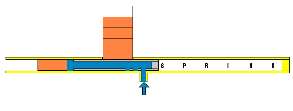

I'm not however experimenting with a 6mm version of the following (from this page) in the hope of achieving full auto with a constant flow of air.
- autobreech.gif (10.67 KiB) Viewed 3492 times
