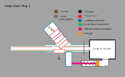

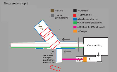

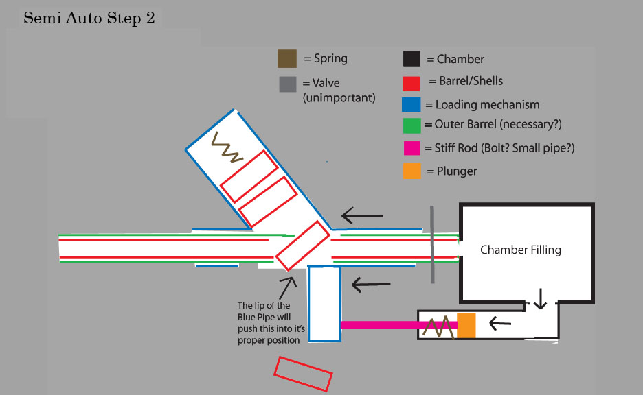

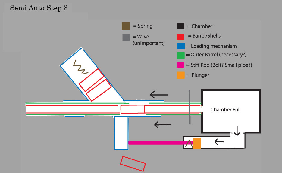

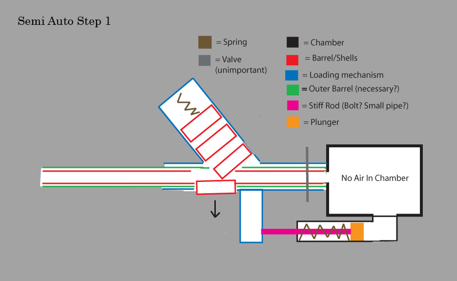

This is an idea for a shell loading semi automatic I will tentatively call it my own, but if I am wrong speak up. I came up with this idea from looking at the various semi auto designs on this site and this is the product of my interest in a design that would lessen the lose of pressure inside the barrel itself. The one red blue and green pipes in the pic have to fit together snugly to prevent pressure loss, any ideas on how to do this would be appreciated.
The diagrams should give you a pretty clear idea of how it works, but I will explain anyways. The cycle starts when the shot is fired and the spring pulls the breech loading mechanism back into the open position. The spent round falls out and the end of the next round is forced in. As the air builds up in the chamber the breech slides forward and the next round is forced in through the slot at the bottom of the magazine. The reason for the slot is so the new shell won't immediately fly out with the spent one. Any suggestions, critiques or questions are welcome. thanks!

i see how it works and i think its a good idea, but it would take lots of work to get working properly, especially if you don't have a good machine shop.

If you can get this to work, it would be awesome (note the big "if")
You would also have to make it with a fairly small sized chamber, otherwise the reload mechanism would take a while before it worked (pressure buildup time)
In "semi-auto step 1" I can find one small flaw. That is that because the loading is spring fed, whilst the one is falling down into the barrel, the next one will also be pushed down, and cause a jam. This can be sorted with a gravity feed magazine (i.e. just take the spring out) Or by putting a small piece of >insert-suitable-material< jutting out to stop it. But then the jutting out piece will cause another jam in the next reload!
Maybe, if your cartridges are perfect size, this wont happen though
Otherwise, I like the design and I think it has potential, if you willing to be patient!

Alright, thanks for your feedback. I am hardly a great craftsman and my power tool collection consists of a cordless drill, a jigsaw and a dremel tool, so maybe a different project would be best.
I might try it anyway, just for something to do (I might find a better idea in the process
) The main problem I would have is the pipe fitting snugly over the other pipes. That's probably where a lathe might be useful (maybe not). Thanks for the info Spud Yeti, I see what you mean.
That could be the case, I have zip experience with semi autos before this one, but my thinking would be that by the time the spring had managed to push the whole magazine back into the loading position, the projectile will be long gone.
Interesting thoughts, though somewhat overly complex if you don't have the right worshop facilities - with a bit of though, you could combine it with this blow-forward valve concept and simplify the process while keeping the basic idea.

-jackssmirkingrevenge- I could try to make that combination, but one of my design goals was to reduce if not eliminate any factor that would limit the air flow behind the projectile. It could be that I start with that semi auto design like the one you posted, and then gradually work my way towards my own design.
