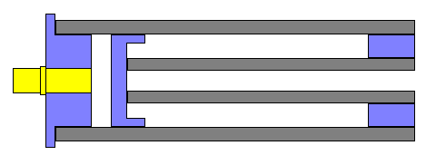

Can I get a estimate for the price on this. I need it .750" by 3" long. The back part has to stop the shell from going all the way through the pipe, so if you have a piece of sch 40 3/4" pvc, make sure it won't go all the way through.

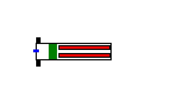

Blue, schrader, red, barrels, green, piston, black, body.
Shotgun cartridge.JPG (11.82 KiB) Viewed 3978 times
If the grey parts could be pre-existing pipe, the rest could be machined relatively cheaply and the whole thing epoxied together.
warhead052
Posts: 1769
This is for my shotgun project, so I need it to be safe to put pressure in, and not have to weaken pvc. I am going to try a version like that, but I would like to know if it can be made?
warhead052 wrote:I would like to know if it can be made?
Anything can be made. I'm just suggesting you look for a way to make it easily and quickly with the minimum of machining, so that you can have it cheaply :) remember, materials are cheap, time costs much more.

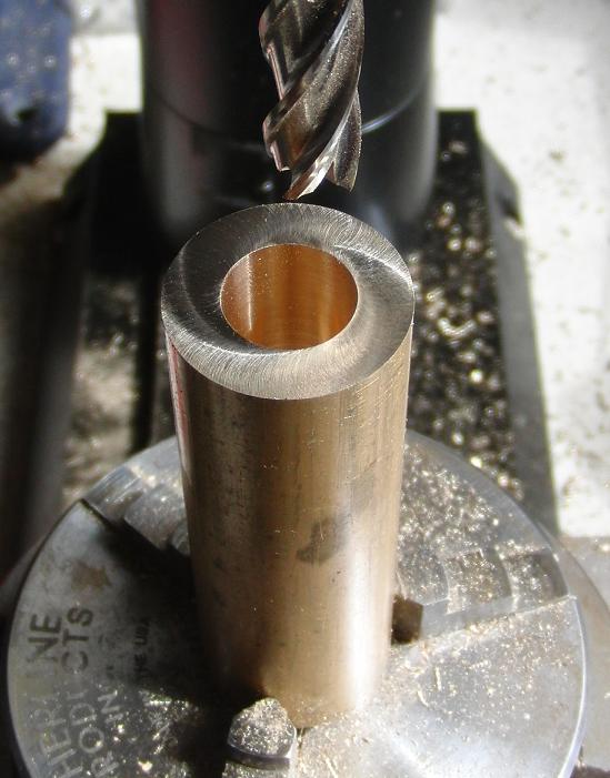

A little something I'm making for jakethebeast in exchange for his lovely little blade, I like <s>trucking</s> milling :D
