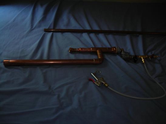

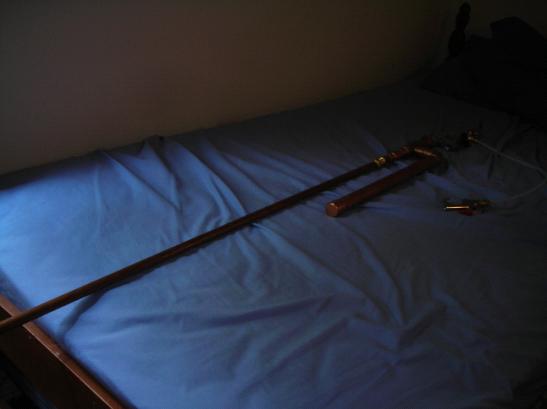

I improved on my first copper gun design. I removed some of the chamber length to conserve on air, and I made the barrel threaded, which can now be breech loaded. Most marbles fit very tightly into the back of the barrel where the compression nut fits over it, and holds them in place.

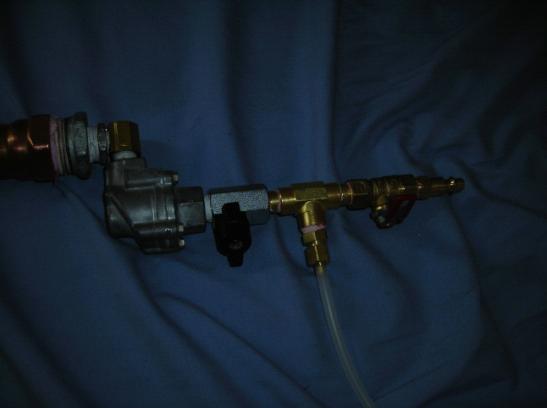

The valve is a normal piston valve. The piston itself is made from a 3/16" threaded bolt, some washers, and nitrile sheeting, (1/8"). The exhaust valve is a 1/4" Q.E.V., which is triggered by a blowgun valve. The launcher is filled through a male auto coupling, which is shut-off by a ball valve. There is also a safety ball-valve to prevent accidental firings, after I almost put a piece of chocolate through my face with my sprinkler-valve cannon. :oops:
Here's some pictures.

i cant realy see the pics but the video it sounded realy quiet for a piston gun.

Very nice update. It looks really good, and I sure it is fun to fill. However, was cutting the chamber down necessary? With my 1" x 60" chamber, it fills to 40 PSI after only six pumps with a bike pump... in other words, really fast. Was there some other reason that you cut down the chamber (I know you got a new compressor). Either way, it looks nice with the reduced chamber length.

I cut down on chamber length to conserve air. I only get to run my air compressor when everyone's awake... which is suprisingly rare given the schedule I have for work and my stepdad's work schedule.
