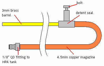

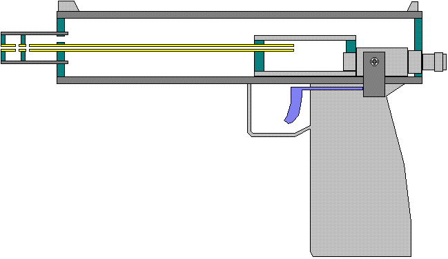

This is what I'm currently thinking of to promote reliable and consistent feeding.
Edit: prototype curing, testing tomorrow :)
Edit 2: prototype with untightened detent - ie relying on seal only - held a 3mm BB without "popping" at 500 psi, and sprang a leak. Leak repaired, testing at 850 psi due later today.

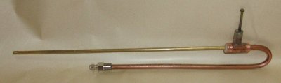

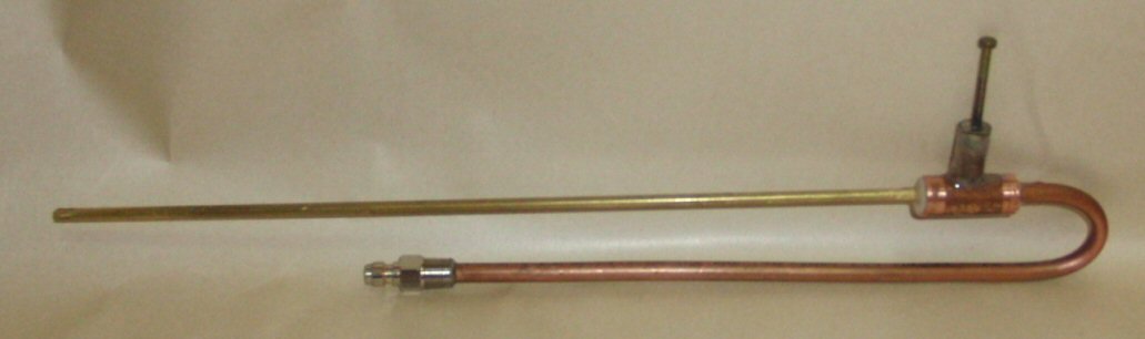

Finally I put together something that is reliable and light enough to be acceptable as the "gun" element for this project. The concept is one expressed earlier and looks something like this:
A previous prototype on this principle jammed up, on account of the tube I was using between the valve and the barrel being of 2mm I/D - exactly double that of my projectiles, which is asking for trouble. The one I'm using now is 1.5mm I/D which is perfect - small enough for the blow of BBs not to jam, but large enough to allow enough blowby to shoot past the projectiles in the tube.
It does jam up occasionally at the breech, because the odd BB doesn't fit in the barrel, but otherwise the cloud mechanism which feeds the tube performs flawlessly.
The beauty of this is that the heavy chamber, valve and associated trigger servo can be mounted on the stand, and the only thing the elevation and traverse servos have to strain with is the barrel (and maybe a laser sight :D)

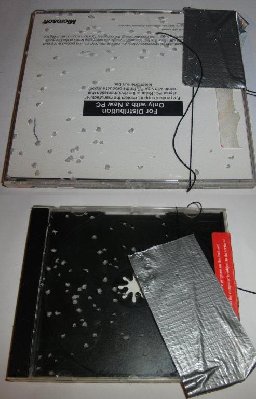

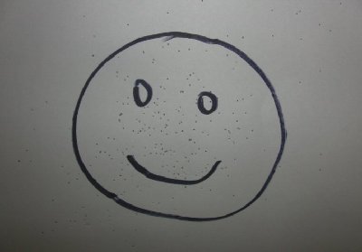

Power is what can be expected of a 1mm BBMG, a single BB will not penetrate a CD, but will happily chew up cardboard smileys:
Some detail:

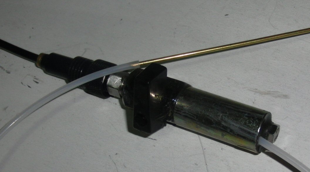

Detail of the chamber (cut from a CO2 capsule) and 1/8" ball valve which will eventually be servo operated.  Note also the bolt closing off the port that allows reloading.

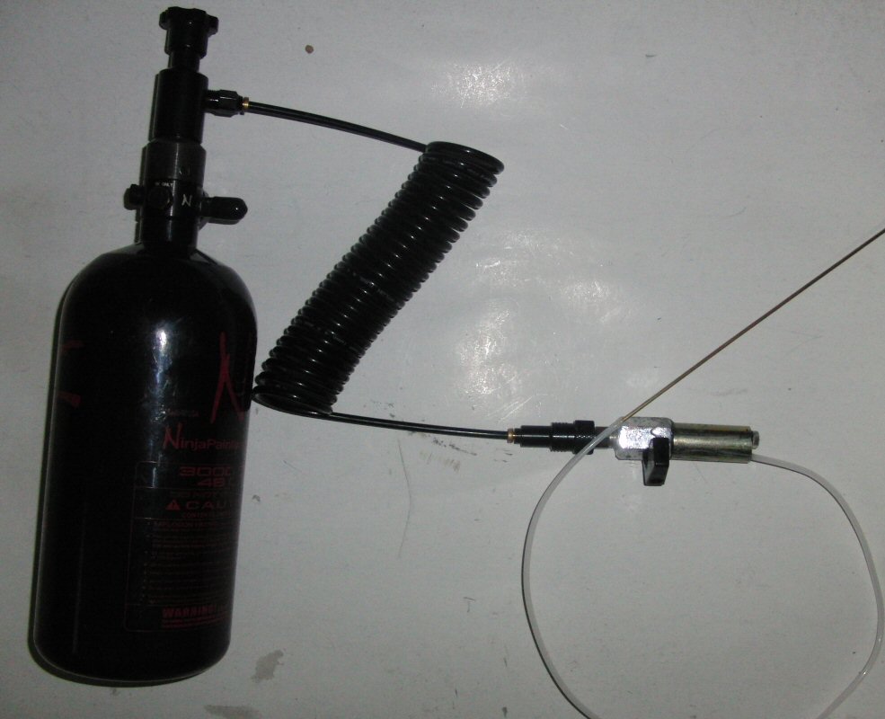

The whole setup attached to the paintball bottle regged to 850 psi

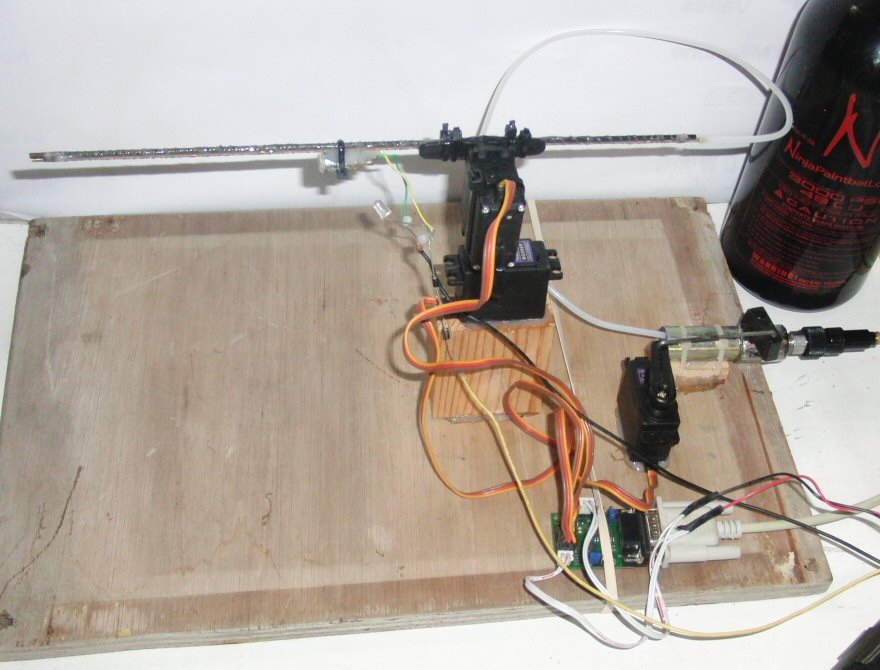

None of that fancy stuff for me, it's cable ties and Araldite all the way :D
As you can see it's pretty ghetto, but works quite well :) the high velocity flow causes the POI to shift upwards but that can be compensated for. There's also a pretty wide spread of shot, almost the size of an A4 paper at 10 feet, a "shotgun" effect which should increase hit probability.
The laser sight is hooked up as dewey-1 recommended here, and it's all powered by a 1A 6V power supply.
All that's left now is to mount a camera and calibrate it :D

al-xg wrote:Seems like it might be worth making a more balanced and rigid frame for a newer version. (that ball valve mount :D)
That ball valve certainly needed better securing - first auto targeting test, the thing came loose on the first shot and didn't close...
Still, plenty of hits :D

I repaired the trigger and added (epoxied :D) a permanent camera to the mount in the meantime, I hope to post some more testing soon. There's a lot of tweaking to do with calibration till you get it right, for example I realised it was set to a level so sensitive that it was detecting the laser dot as a separate target and trying to track it, talk about a cat chasing its own tail :D
