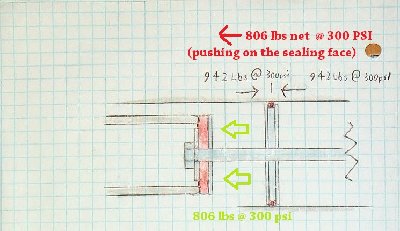

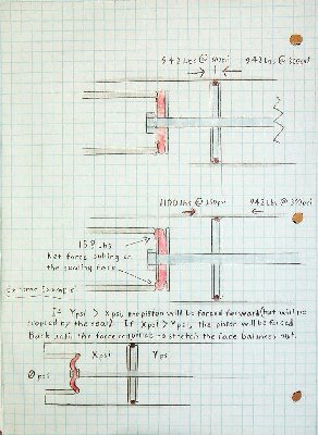

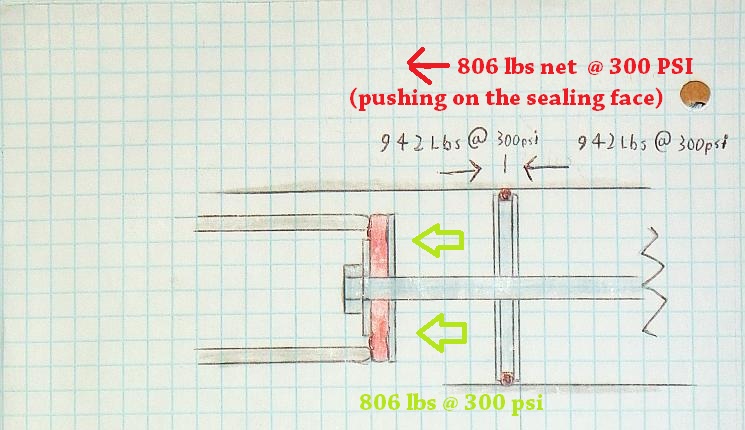

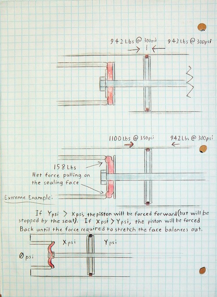

I did some brainstorming and I think I figured out your low opening pressure problem. Ok, I guarantee I figured it out*
First I'd like to direct your attention to an old high-speed video by clide:
http://gbcannon.com/projects/flipbooks/clearvalve.html
As you can see, when a sealing face is not secured to the rest of the piston completely, the face and piston will not move together in a uniform way. It will move long before the valve actually "opens", which in your case will cause it to dump the pilot volume.
Below is a quick approximation of your valve and what it will most likely do upon firing. There are a couple solutions to this, but the easiest is just to glue the face down.
*Guarantee covers both your entire purchase price and eternal salvation.

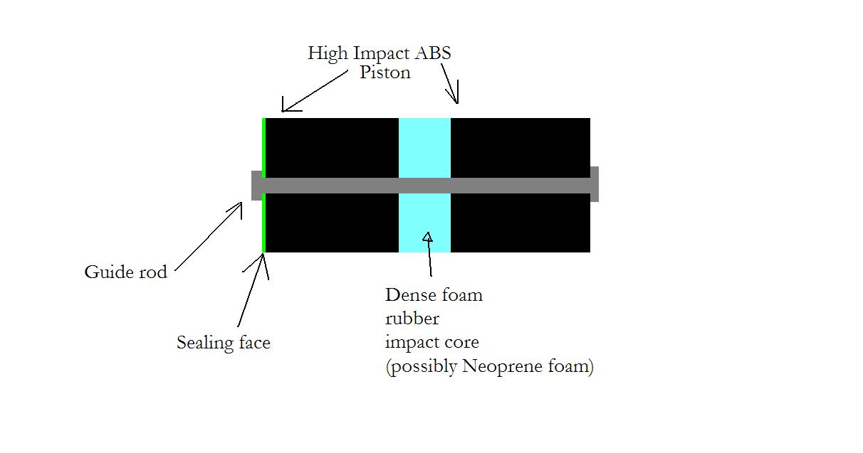

I had an interesting idea for a piston. You can substitute the ABS plastic based on necessity. It might be worth looking into though. The impact absorption would help extend the lifetime of the piston. Tell me what you guys think!
EDIT: This was with intent of being used in MrCrowley's Hybrid.
- High impact piston with shock absorbtion.JPG (34.37 KiB) Viewed 2782 times
Last edited by Mr.Tallahassee on Fri Jul 15, 2011 12:15 am, edited 1 time in total.
