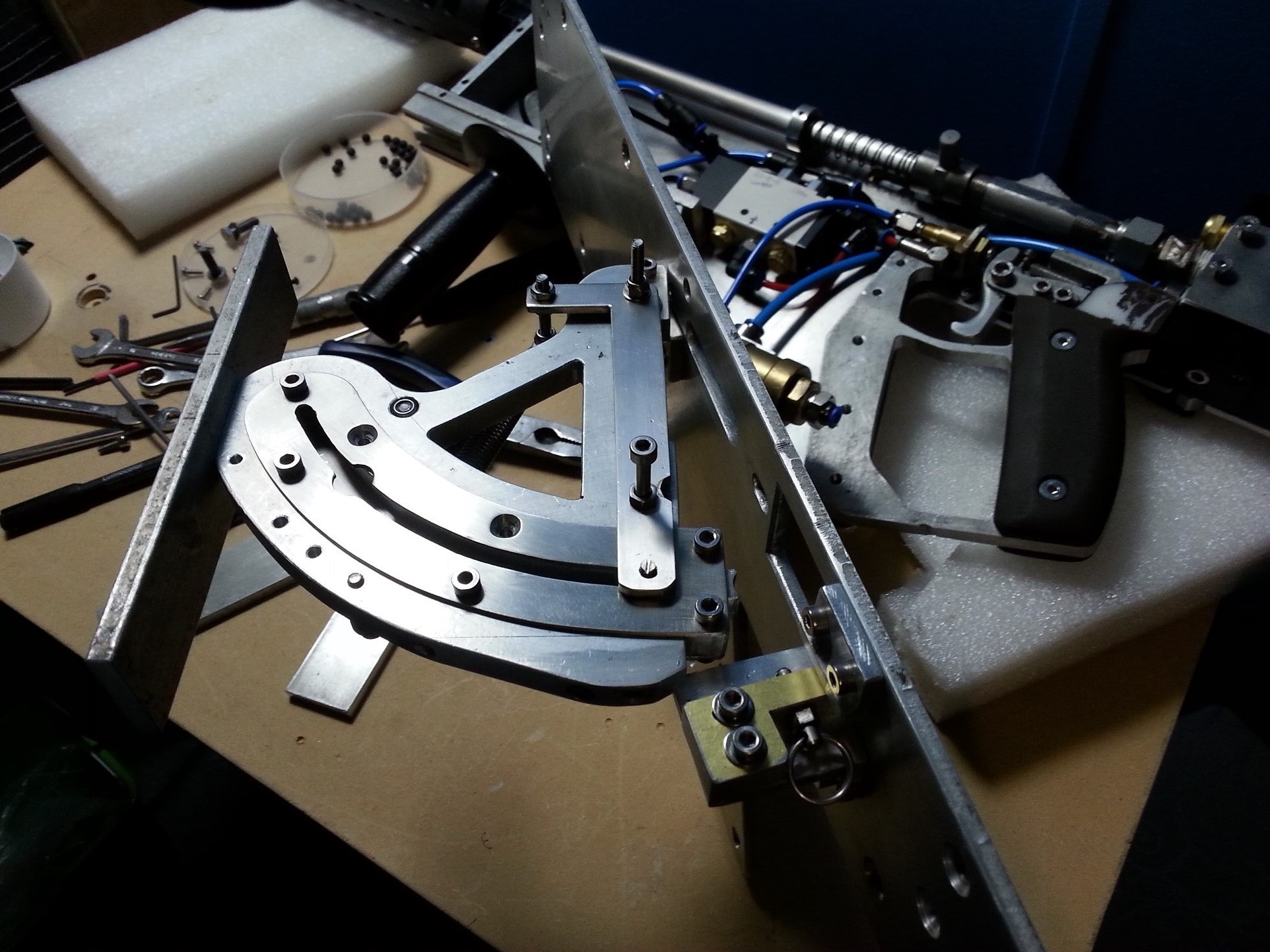

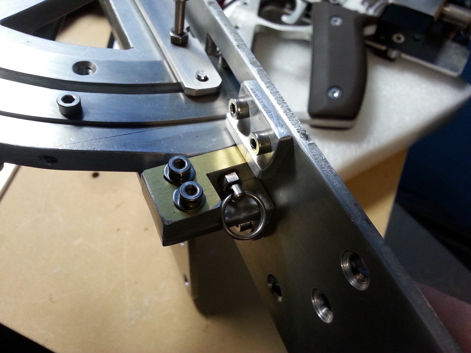

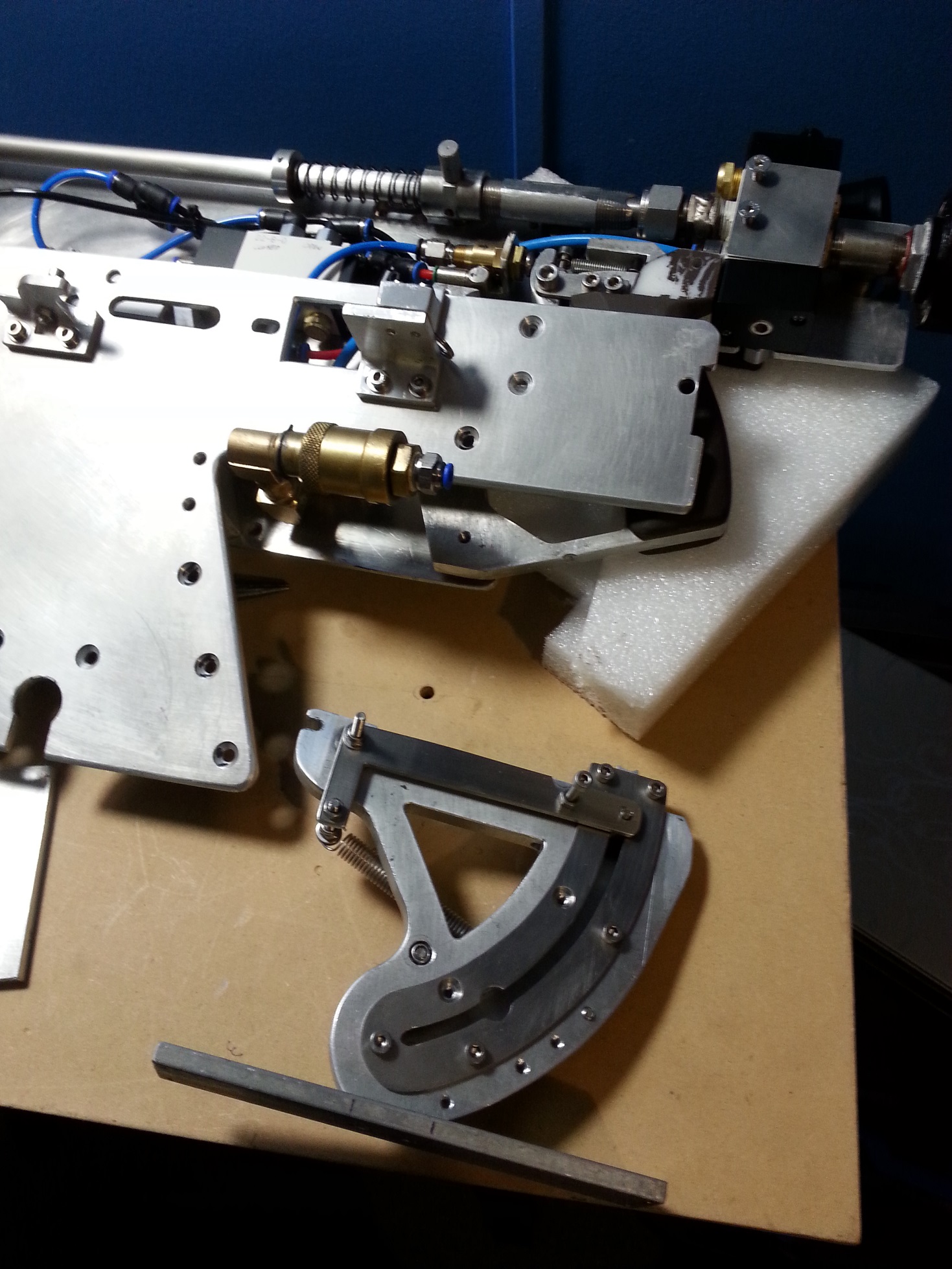

Playing with the BFG removable magazine a bit more, this bit seems to work nicely
