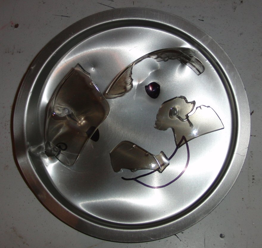

Some more experimentation, this time to see how much your average (though extremely funky looking, these are the best designed ones we're ever had :D) laboratory safety glasses would protect you in the event of being shot in the face by a hybrid :)
First shot is a CO2 capsule from the 0.75" hybrid at 12x, next was a 0.22" pellet from the mini hybrid at 14x.
In both cases, the projectile didn't technically make it through, but judging by the damage to the 1mm thick alloy witness plate, it would likely have made a clear hole through the glasses were it backed with something softer.

jackssmirkingrevenge wrote:Some more experimentation, this time to see how much your average (though extremely funky looking, these are the best designed ones we're ever had :D) laboratory safety glasses would protect you in the event of being shot in the face by a hybrid :)
You're right... they are funky looking! :D
Very interesting however... I wonder how they'd react if they weren't allowed to move...

Insomniac wrote:I wonder how they'd react if they weren't allowed to move...
I'm fairly certain that if it were rigidly supported without a hard backing, the pellet would have made it through with ease. The CO<sub>2</sub> capsule has a lot more kinetic energy but it doesn't have the benefit of velocity, meaning it would still bludgeon its way through as opposed to punching a clean hole.

well i guess all that proves is that safety glasses arnt made for the people with an intention of shooting themselves in the face :roll:

ilovefire wrote:well i guess all that proves is that safety glasses arnt made for the people with an intention of shooting themselves in the face :roll:
No consolation for poor Marvinthen :roll: :D
Could you test something more like what I wear? It'd be interesting to see if that's really worth all the extra money
Send me a sample and I'll be more than happy to abuse it kinetically in the name of science, but I'm not going to spend $80 on something just to shoot at it ;)

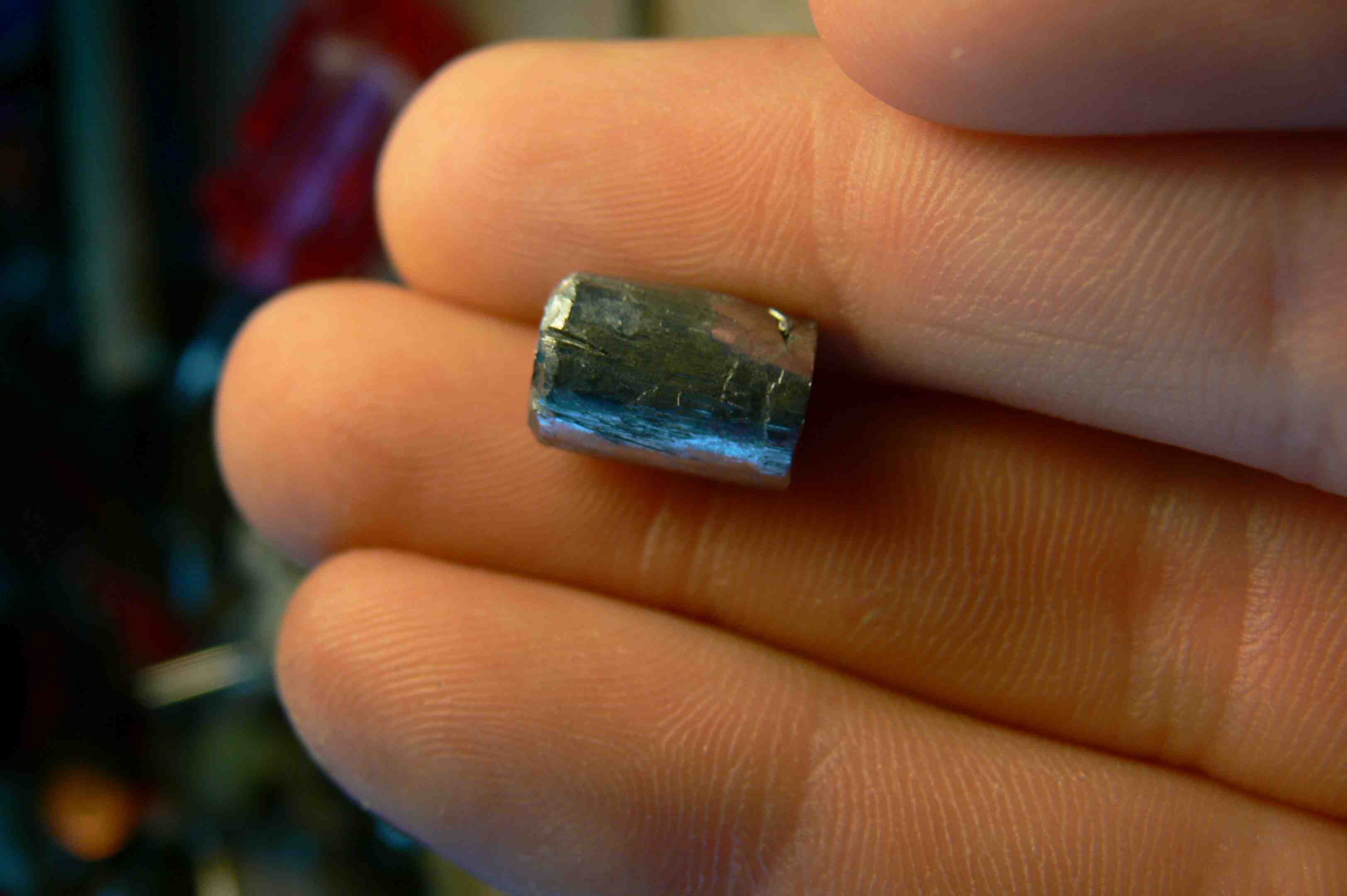

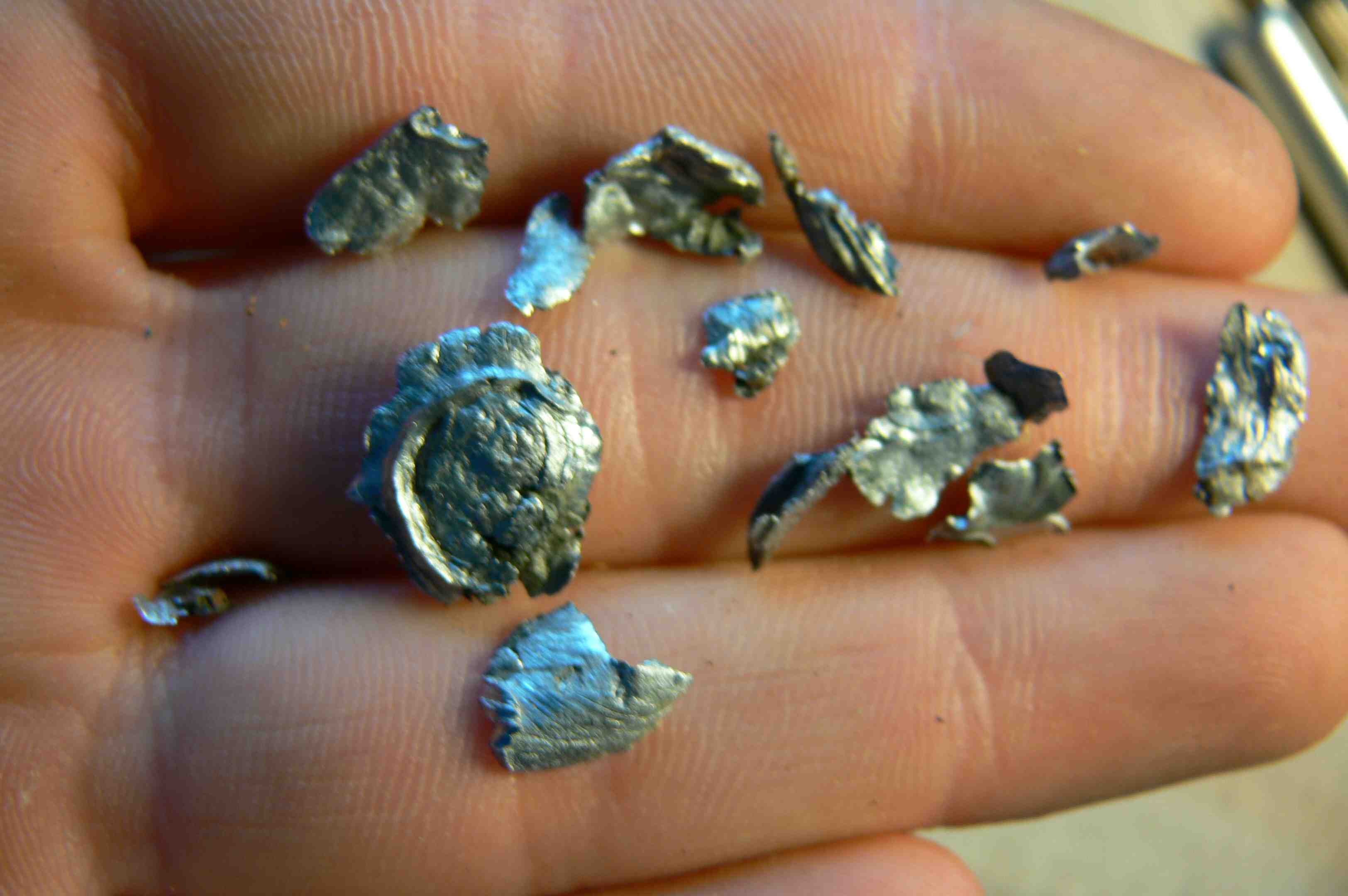

thought i would add some damage pics, damage is to a 8mm x maybe 15mm lead slug after hitting a brick at 27x with a 4ml chamber and a 1m x 8mm barrel

Fragmentation win! Any photos of the brick :D and also, since you were shooting at a hard target, I hope you were wearing safety glasses!
How loud is it at 27x?

jackssmirkingrevenge wrote:Fragmentation win! Any photos of the brick :D and also, since you were shooting at a hard target, I hope you were wearing safety glasses!
i didn't bother to take a photo of the brick because all that happend to it was it got a shiny metallic stain which was disappointing, but if you still want me to im sure i can make that happen and as for safety it had three sides surrounded by wood and for the front i had a newspaper to slow or stop shrapnel but did not effect the entry, i was wearing sunglasses but i know they wouldn't do anything so i looked in the other direction, and it is actually pretty good when i comes to sound because of the very low chamber to barrel ratio its pretty quiet i mean its not silent but its not bad

ilovefire wrote:i didn't bother to take a photo of the brick because all that happend to it was it got a shiny metallic stain which was disappointing
Hardly surprising given the frangible nature of the projectile, did you get lead fragments embedded in the wood?
ilovefire
Posts: 511
not in the side bits because they were solid hard wood blocks but a bit did get lodged in the bit of 1mm ply i had at the top that was covered by some other chunks scrap wood
