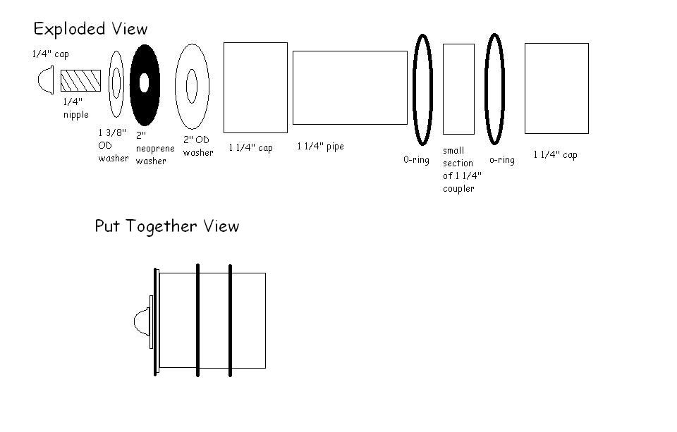

Ok, here's the diagram of the new piston I'm going to be making. Anyone see any problems with it? Its basically the same as the previous one, with the addition of o-rings and a washer behind the sealing face.
piston design.JPG (36.72 KiB) Viewed 2617 times
elitesniper
Posts: 1090
Try to fit a small check valve in it, more efficient.

Good idea elitesniper, just added one to my McMaster order.
Part #7768K26
Edit: I'm also changing the servicability of the back from bolts to a threaded reducing bushing. Hopefully it will make it alot easier (and faster) to take apart. The bolts always leaked anyways. Has anyone had any trouble with threaded pvc parts not sealing? They never seem to screw in all the way.
When he said check valve I think he ment drilling a small hole in your piston, not ordering a seprete one from McMasters, I'm not sure but thats what I think.
psycix
Posts: 3684
Location: The Netherlands
Drilling a small hole under the flap of your sealing face can act as a check valve.
It just flaps open to let air pass into the chamber, but when pillotted, the flap is sucked against the hole and seals it.

So I would have to drill through the washer and the cap behind the sealing face?
I was going to install one from McMaster inside the piston but this method seems much easier. As long as I can drill through the washer...
EDIT: OK, I'm pretty sure I'll be able to find a drill bit to drill through metal. Where will the holes in the washer need to be? Where it presses up against the walls of the 1.5" porting? Or inside the porting?
That little hole has to be located outside of the barrel's inner diameter. Thought that would be importent to point out.

I don't think I'll be able to drill outside the walls of the porting, there will only be about .05" around there. If I drill a little further in, like right where the washer presses against the wall, will I still be okay?
Otherwise I could add the check from Mcmaster inside the valve and drill holes around the circumference of the piston before the first o-ring groove. It would work in the same basic way, except it would be heavier.

You will have to.
If you are drilling it on the walls of the porting (or even worse, inside the porting), the chance exists that it will not be able to let air pass onto the chamber since the piston presses the flap against the hole.
When its outside of the porting, the sealing face can flap open somewhat.
It doesnt need to be a large hole
In that case, your piston may still be too small for the porting.
If you had a larger one (say, 2,5"), you would not only be able to install the check valve hole easier, but it would also perform better.
You COULD make the porting pipe have tapered edges (like a spud-cutter, but then not sharp) this makes not only the sealing face seal better, it also improves flow AND because the porting walls that press against the sealing face are thinner it will be easier to install a check valve-hole.
It also increases initial frontal area somewhat, and since yours is small, it is relatively a large difference.
