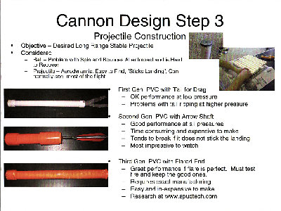

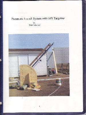

The Cannon Chamber is constructed out of 4" sc40 PVC and is 5' long. The barrel is I believe 1 1/2 in sc80 but it has a sleave insert into it that that is some sort of super thin vacuum pipe. The vacuum pipe fits perfectly around my projectiles, so I slid it in that sc80 and called it a barrel. lola The entire barrel is 9' Long. And you can see in the Picture the that it had to be supported to make it more stable.
Maxes the 2nd I have Videos but am not a You Tube junky and dent know the easiest way to post them.
TurboSuper is exactly right! The actual Launcher was not hard to construct at all. It took maybe a week to finnish. The difficult part was incorporating everything together. Getting a Rellyable Projectile, preforming all the physics calculations, writing the Program, building the Electronics, and getting the launcher to fire extremely accurately was the hard part. Trying to get all that to come together in time for the fair was rather difficult. But was rewarding when it payed off.

From the other picture, I got the impression that it stood about 2ft high.

Whoa it is huge yes that othe picture definitelry made it look about two foot tall. Cannont wait for a vid on this. How much dough did you put into making this, electronics and all.

well the projectile could be much better in terms of drag coef. but ofcourse I understand that there were other considerations
are you going to upgrade it for example by building a new more powerful gun?
I think it was not the same launcher on the other picture you're talking about (it seemed like white PVC)MaxuS the 2nd wrote:From the other picture, I got the impression that it stood about 2ft high.

Yea the Projectiles was one of the most difficult parts of the whole project! It was def the most time consuming part.
I have been wanting to build a new projectile that is launched with a sabo, but have not had time to get around to it. I have also wanted to build one with and accelerometer in it, so that you can measure various data such as launch force and impact force. It would be very nice to be able to measure and then check to see if the data collected collaborated with the what was predicted.

OMMFG! lol. From the other picture, I thought I could step on it and break it, but now that you actually show its towering scale, It looks massive.
How did you take that other picture anyway? It sure fooled everybody..

I took that other picture from the top of my 10' Porch. lol
