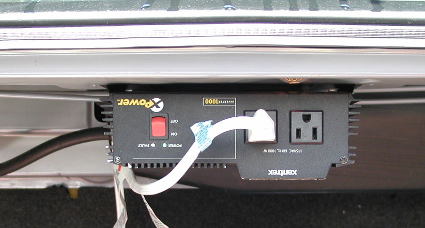

The Prius has a very small 12 volt battery, much like a garden tractor. It wouldn't be used with just the battery. It would use the charging circuit. To provide the current, when parked, I'm not using the electric power steering, lights, A/C blower, power brakes air compressor (Prius has air brakes instead of vac assist), defroster, etc. The combined non driving capacity is about 1 KW which would be re-purposed for running external items. :D Already works and fully tested for an entire weekend power outage. Read the original posts. We are limiting the capacity of the compressor to one the car can handle. It's why I don't have a 2 KW inverter and am limiting the compressor to under 500 running watts and a 1800 starting watt surge. :(
jmccalip wrote:I am not running my compressor off an inverter.
It's funny how people think nothing of using a 12 volt compressor of the same size won't use a 120 volt compressor. It's the same power draw.
I agree with you on the pawn shops. Many are no bargain and often marginal condition stuff is left and not claimed. Two words.. NO WARRANTY.
My Prius inverter install.  The 12 volt battery is in the trunk.  The big black tube is the power lead, sized to handle a couple hundred amps surge.

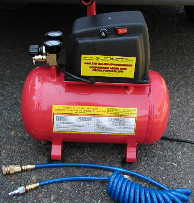

I have picked up the 1/3 HP 2 EDIT 3 gallon compressor from Harbor Freight and did extensive testing this weekend. It works great. It is this one that was on sale for $59.95.
http://www.harborfreight.com/cpi/ctaf/D ... mber=97080
It has no problems re starting on the inverter at the cut in pressure. The delivery is just enough to keep up with the reload cycle of the marshmallow cannon. We had a ball with the 3 foot tennis ball barrel and emptied a bag of tennis balls out in the field in no time.
The large cannon was another story as the chamber is about 3 gallons and the compressor is only 2 gallon. Tag said 2 gallon, compressor clearly marked 3 gallon An initial fill to 40 PSI is quick, but then the compressor runs for a long time to bring up both the compressor and cannon's combined volume to 70-80 PSI. The wait isn't too bad, but the compressor runs constantly and we wait for the pressure to build on each shot. It is about as fast or faster than hand pumping it. It is well worth the money for the field launching.

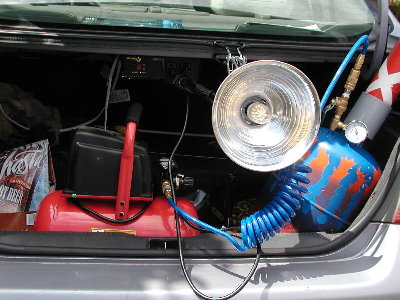

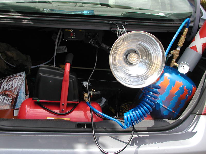

Edit, after a weekend of shooting, here is the field power setup.
1 Prius
1 Trunk Mounted 1KW inverter
1 2 (3) gallon compressor 1/3 HP
1 Air Cannon
1 Light for night operations :D
Compressor takes 3 minutes to reach 100 PSI from empty. Pressure drops to 40 PSI on initial cannon fill and takes another 3 minutes to reach 70 PSI for a 3 minute cycle time for 60-70 PSI shots. Longer for higher pressure.
The marshmallow cannon is better. Compressor takes same 3 minutes to 100 PSI, but only drops to 80 on filling the marshmallow cannon. It's almost back to 100 and shut off by the time the next shot is ready for pretty much continuous shots. Did a Tennis Ball cycle of a dozen tennis balls with the 36 inch barrel and the compressor kept up, but didn't cycle off. The inverter and compressor held up well.
It is a little slow for the big cannon, but much better than the hand pump where most people petered out at 60 PSI or less. It was consistent at higher pressure and faster.

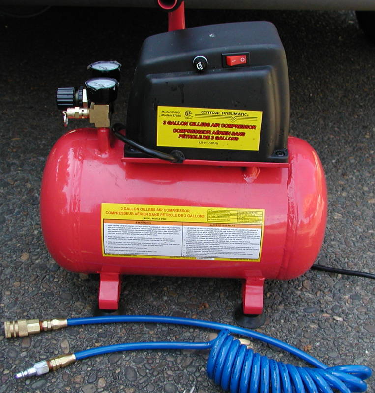

Compressor did not come with a hose. I just used the one I had on my hand pump seen elsewhere.
Portable air for field use.
Compressor advertised as 2 gallon on sale for $59.  ;-)
