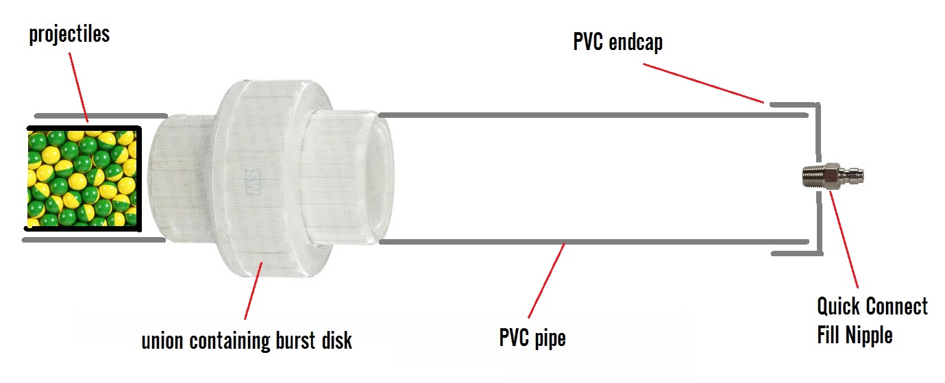

What do you intend to fire as ammunition? One possibility is to make self-contained cartridges but this can get a little complex. Then again, you could consider something like a burst disk:Also, what is the best method to make this breech loaded?
Basically your cartridge is an empty tube with a burst disk made of a frangible material (eg aluminum foil) at one end. You load the cartridge, connect the nipple to a gas supply and open a valve briefly. The pressure inside the cartridge rises until the point that the burst disk fails, dumping the air through the barrel and taking the projectiles with it.
In terms of performance with a burst disk you will get maximum flow and virtually zero opening time, which means you can operate at lower pressures than you would have needed with a sprinkler valve, plus you have the realism of actually loading cartridges.

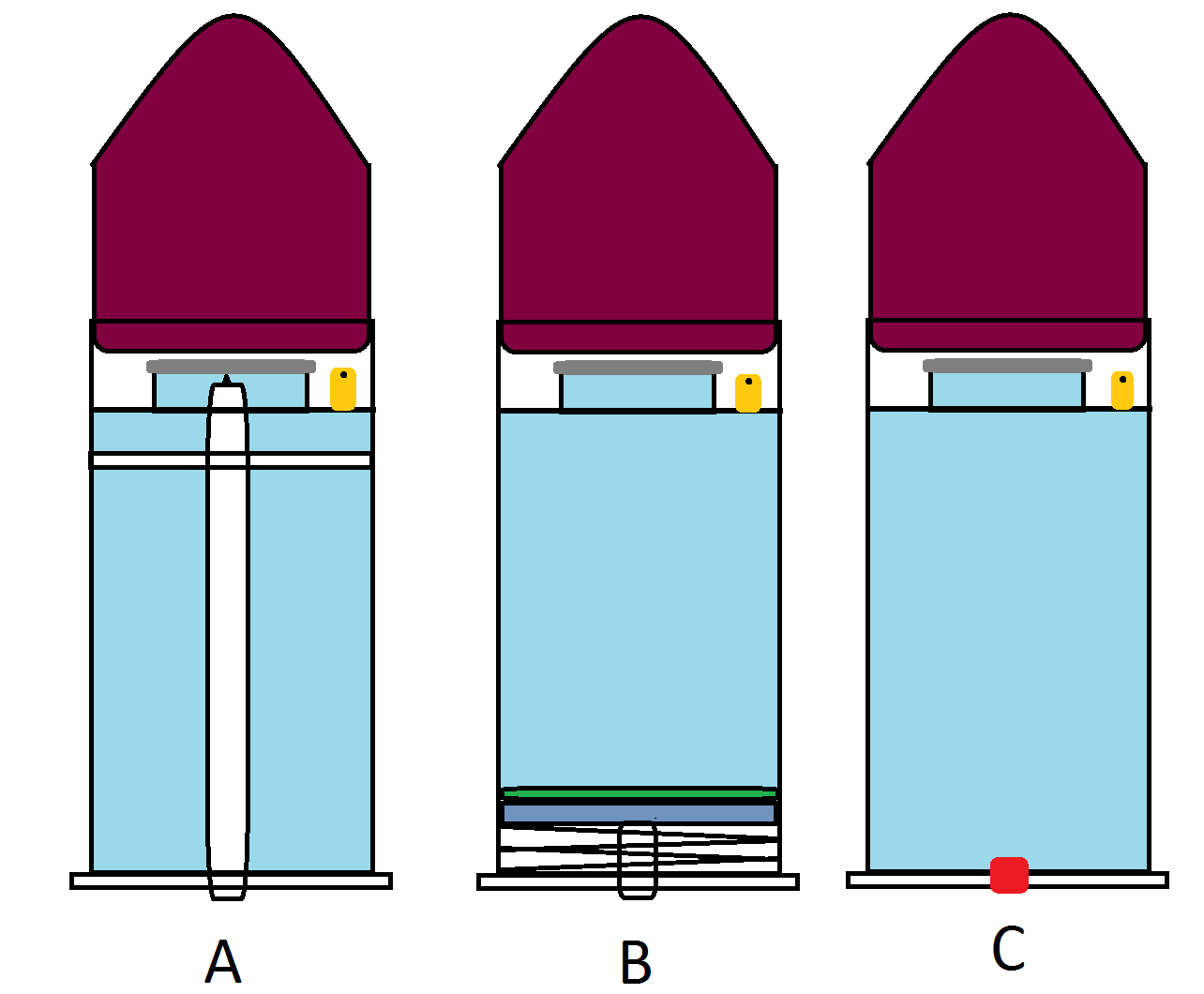

So, I've been thinking about this for a while, and while I like your shell design, it has a few flaws that I wanted to work out. Particularly the need for an air compressor to fire the Cannon.
I came up with 3 experimental pneumatic shell designs (emphasis on experimental)
A- primitive design that uses a firing pin to pop the burst disk
B- uses a spring powered piston (blue gray) with an O-ring (green) triggered by a "primer" which uses a mechanism similar to a clicker pen (not displayed) to release the piston and compress the air to a critical point.
C- is a borderline against the rules solution, which uses a #209 primer (red) to not only burst the disk but also to agitate the air.
I'm not sure if any of these would actually work, but if any of them has a chance I'll test it and see if it's a step up in pneumatic breach loaders.
- Project-tile.png (16 KiB) Viewed 4366 times

They'll be 75mm diameter and constructed of welded steel (which will be pressure tested).Zeus wrote:I'm unsure of what you can construct and how large your cartridges can be.
The only valve in them is a burst disk (depicted in grey), but the only way I can produce burst disks well is out of layered aluminum foil.
For the intended purpose, I would worry that the time required to pressurize the cartridge in order to burst the disc (few seconds) would be uncomfortable in real life scenario. Also you would need to connect the nipple and close the breech, which is one action more then ideal.

In practice, if the pressure source is disproportionate to the burst pressure (say feeding 850 psi from a CO2 bottle with a 75 psi burst disk) it would take less than a second.I would worry that the time required to pressurize the cartridge in order to burst the disc (few seconds) would be uncomfortable in real life scenario.
If you want preloaded cartidges, another relatively easy method for high flow with a burst disk is to use a nichrome wire to pop a mylar burst disk as in this recently posted project. This gives you the benefit of electronic ignition meaning there is no complex mechanical trigger to make and your trigger switch can be anywhere.
- Cthulhu
- Posts: 194
- Joined: Wed Apr 12, 2017 7:07 pm
- Location: South Texas
Wow! I can't believe I didn't think of this. but will there be a noticeable moment of time before the nichrome gets warm enough to melt the mylar enough?jackssmirkingrevenge wrote:If you want preloaded cartidges, another relatively easy method for high flow with a burst disk is to use a nichrome wire to pop a mylar burst disk as in this recently posted project. This gives you the benefit of electronic ignition meaning there is no complex mechanical trigger to make and your trigger switch can be anywhere.
This way I could help the general shell design but replace the inner mechanics with simple wiring inside the pressurization chamber.
With a strong enough battery the right gauge of nichrome will glow red hot almost instantly.will there be a noticeable moment of time before the nichrome gets warm enough to melt the mylar enough?
