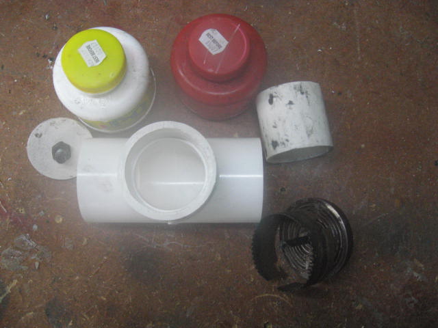

What you need:
Sheet PVC
Fitting (that you want to seal off)
Pipe (the same diameter as the fitting)
PVC primer and glue
Hole saw
Bolt

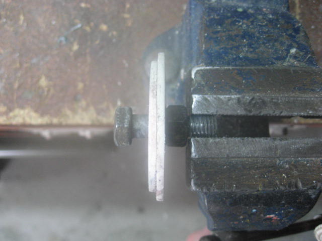

Thread the bolt through both disks, and apply PVC glue and primer between the two disks and hold together for 30seconds.
Tighten the bolt up and apply some silicon sealant or other sealant or epoxy around the bolt to make sure a good seal.

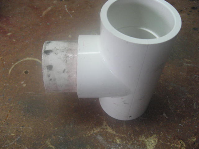

1 - Materials
1 - Materials

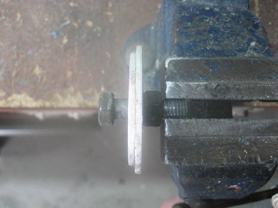

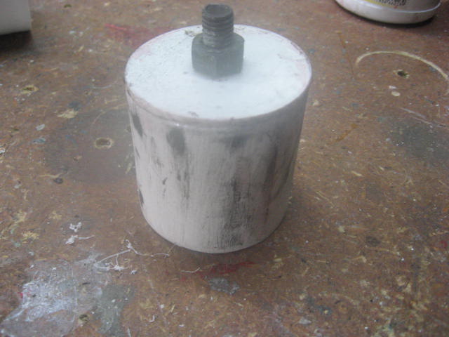

2 - The two disks, smaller one to seal against the inside of the pipe, larger one to seal inside the fitting.

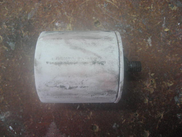

3 - Completed - Side
Completed - Outside<br /><br />Looks like a piston doesn't it.
Completed - Outside

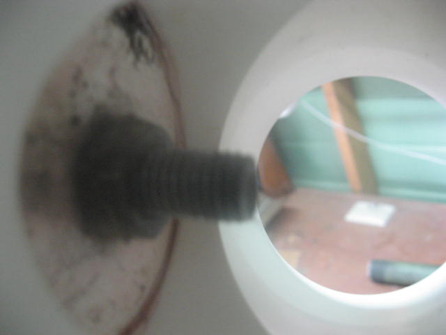

Completed - Inside Pipe
Inside 2.JPG (36.35 KiB) Viewed 6265 times
Completed - Outside
Completed - Outside

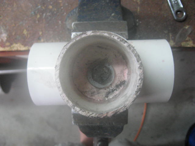

Completed - Inside Fitting
