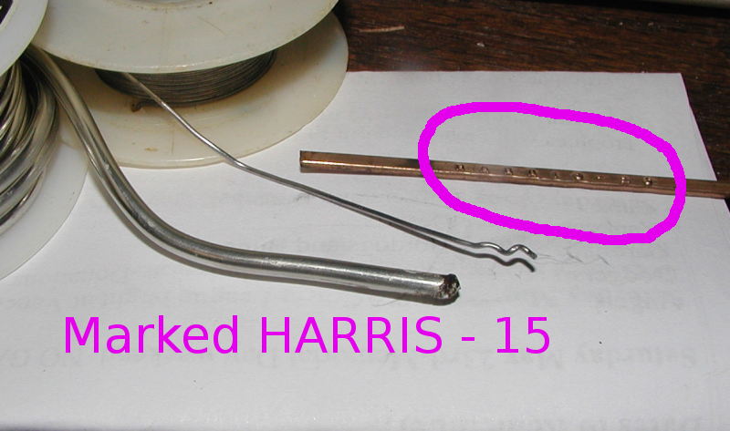

jeepkahn wrote:On that note, Because the brass brazed end was so ugly,I did have this hydrotested before being put into use with way more than a 4:1 safety margin...
The joint on the right is actually using a rod called Blockade...
Here's a link to the website. http://www.harrisproductsgroup.com/cons ... .asp?id=31
I only had a sample of it to use that's why there are 2 different rods used, had I known how well the blockade was going to work I would've gone ahead and bought some more....
Thanks for the update on the product used. My job was done with the old industry standard Stay-Silv 15 listed in your link.
Reading the product literature, the improvement appears to be the ability to braze to brass without flux which the stuff I use doesn't do very well. It wants to ball up and roll off brass instead of wetting it.
Again thanks for the update on the other connection.
HARRIS - 15
HARRIS - 15

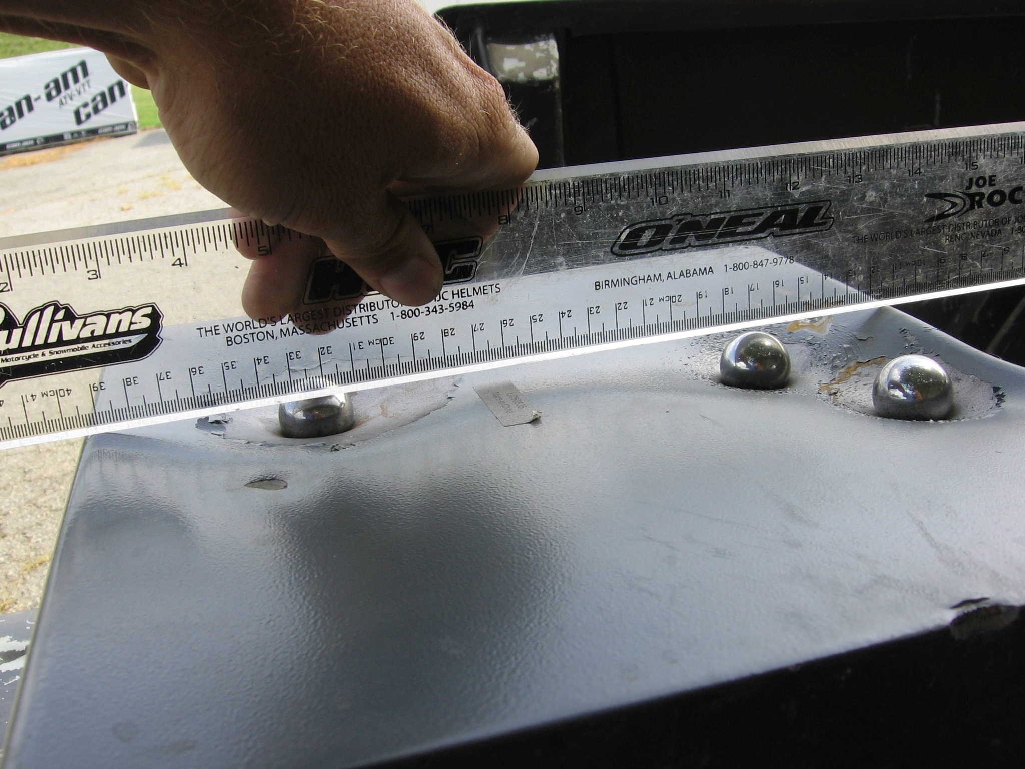

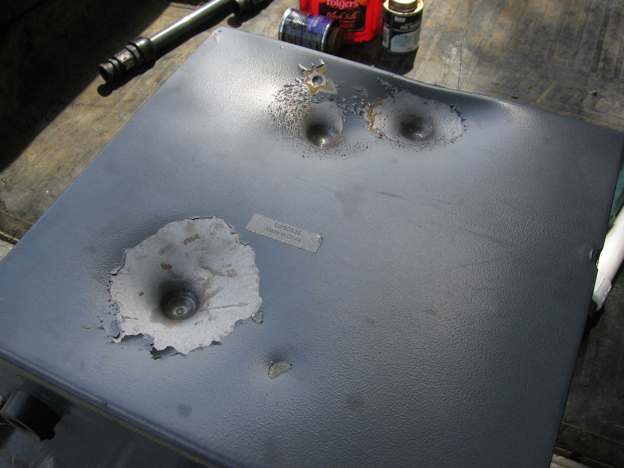

Here's some pics of a home safe that I've been using for target practice...
These are with from 1" steel bearings. And the safe is constructed of .25" AR plate(abrasion resistant, very hard stuff).
Yes, it stopped the bearings but the funny thing is that the bearings literally hit and drop straight to the ground, no bounce at all, the safe itself weighs about 75lbs and moves about a foot with each shot... I was amazed at the depth of penetration against this hard @$$ plate steel...

As far as dropping rounds.. it shows the energy transfer is close to 100% like a Newton's cradle. Nice selection on projectile mass to achieve this.. Well done. :wav: :headbang: :salute:

:| Dear god...
That must have sounded like a train smash when those hit! Very well done mate.
