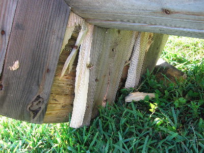

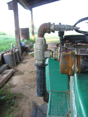

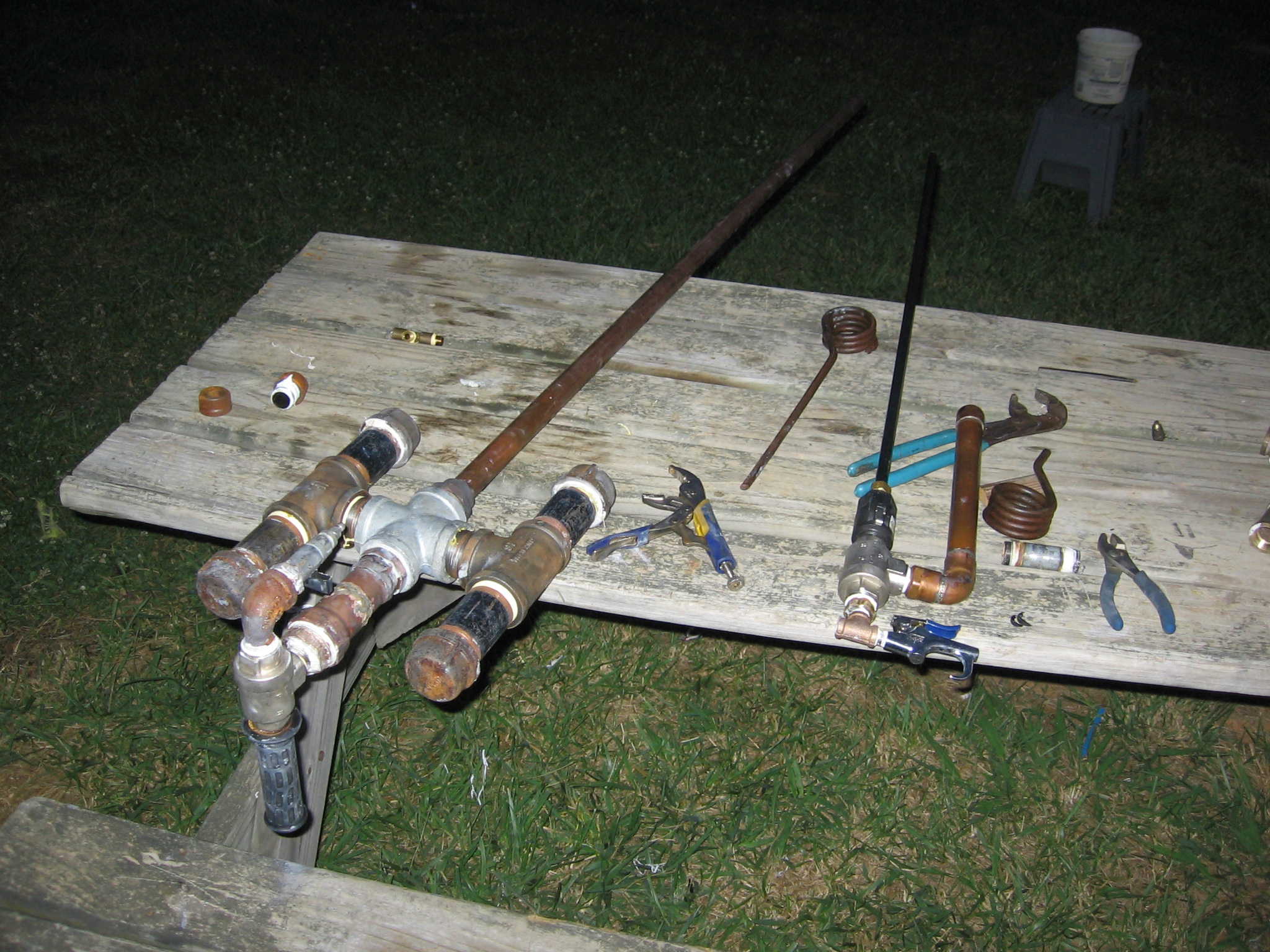

Haven't gone unregged yet but the first time I fired it with a 1"ballbearing @600psi it kicked so hard it broke off the brass fitting that the blowgun was attached to, and put me on my butt... After that I put on a 3/4" street 90 with the ballvalve and filler adapter and use the ball valve as a trigger(this friday I'll be getting a check/filler nipple and will run it off the back of a tee that'll replace the str90 and use the 1/4" ball valve as a trigger only<the>)....

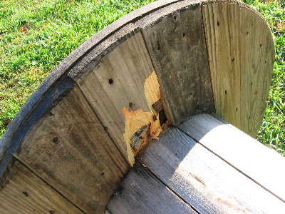

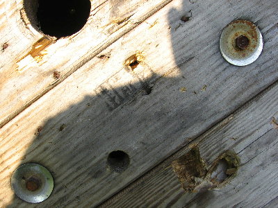

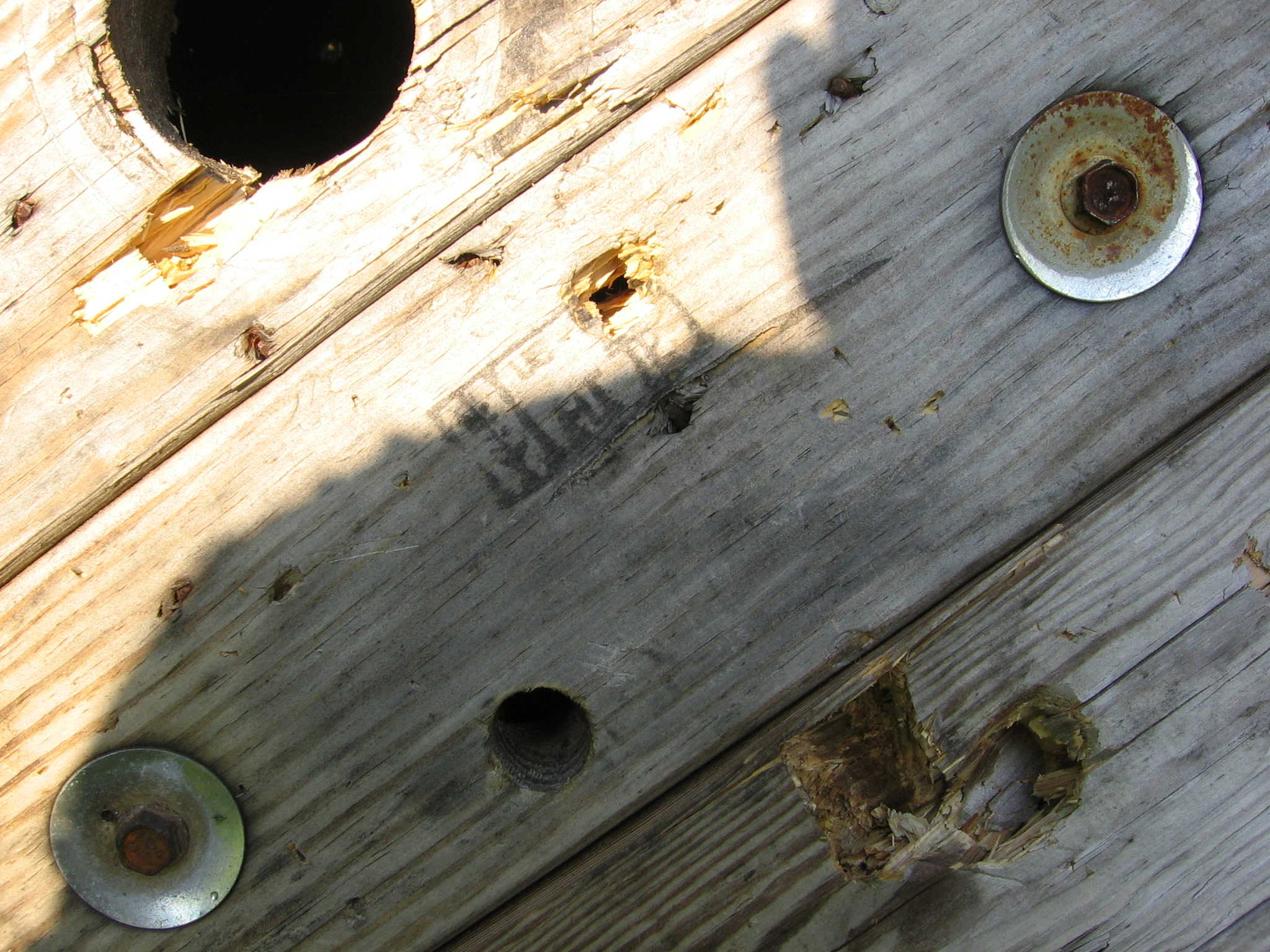

I'll post some damage pics later.....
I used Iron for the chamber because I didn't have the money for brass/copper fitting for copper chambers yet....
Specs are: 1.5" porting , toolie styled barrel sealer, 1" type k barrel, 3/4" qev as the pilot valve...
I've also got to build a mount/tripod for this thing, it weighs about 30lb and will bruise your leg if you brace it against your thigh...
I also forgot to mention how much of a pain it is to make a piston that'll handle 600psi+ without self dectructing the sealing face every shot...
And yes, thats my gawdawfull ugly brazing job on the piston chamber, and LIBERAL use of pipedope on the threaded portions....

Looks awful but pretty is as pretty does, looking forward to the damage pics

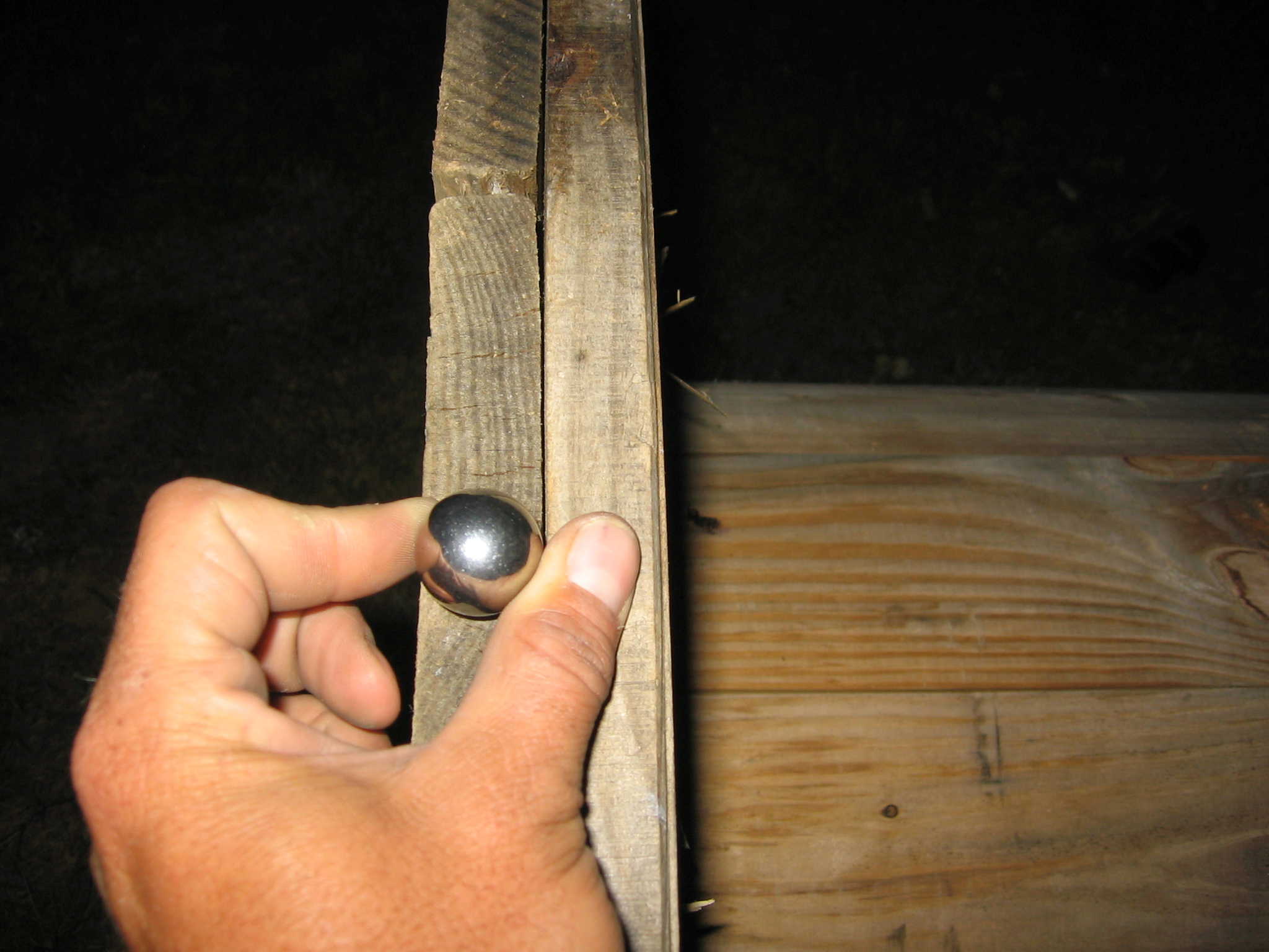

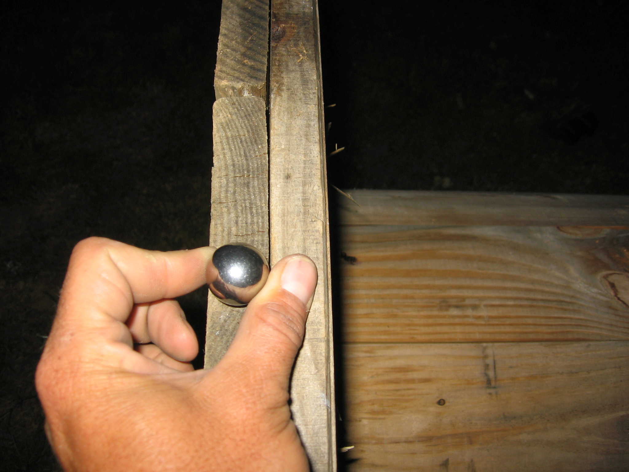

As you can tell by the pics, the wood is not rotten and that's a ' steel ball for size index...

Very impressive penetration, any idea at what rate it screams through the air?

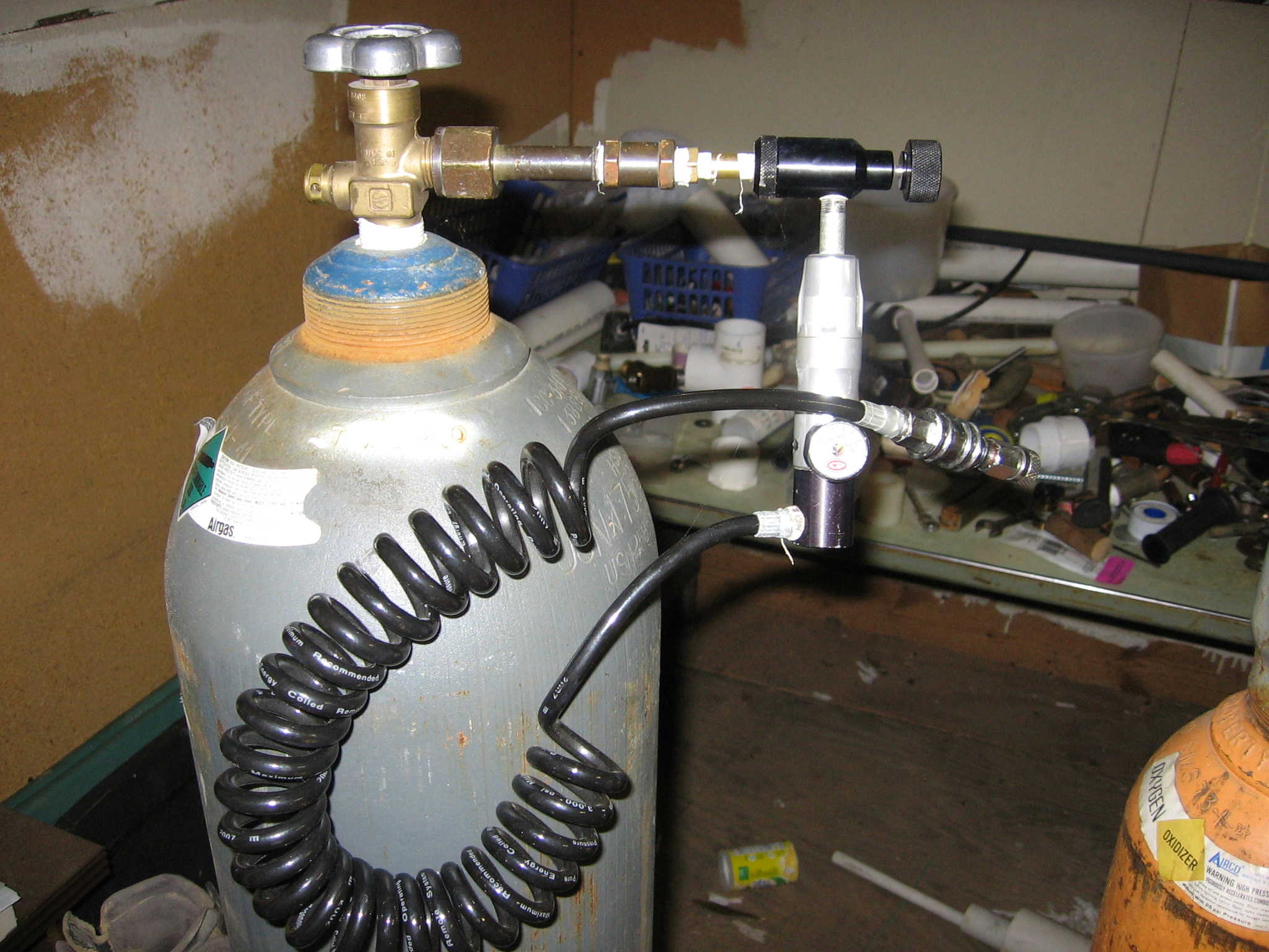

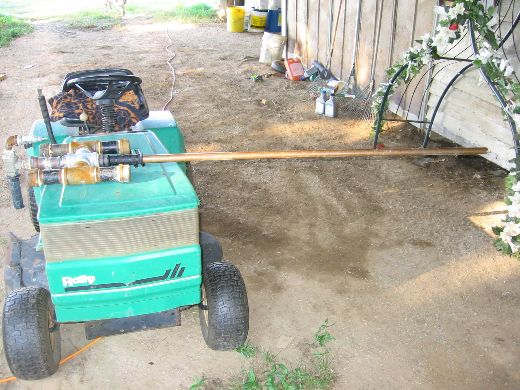

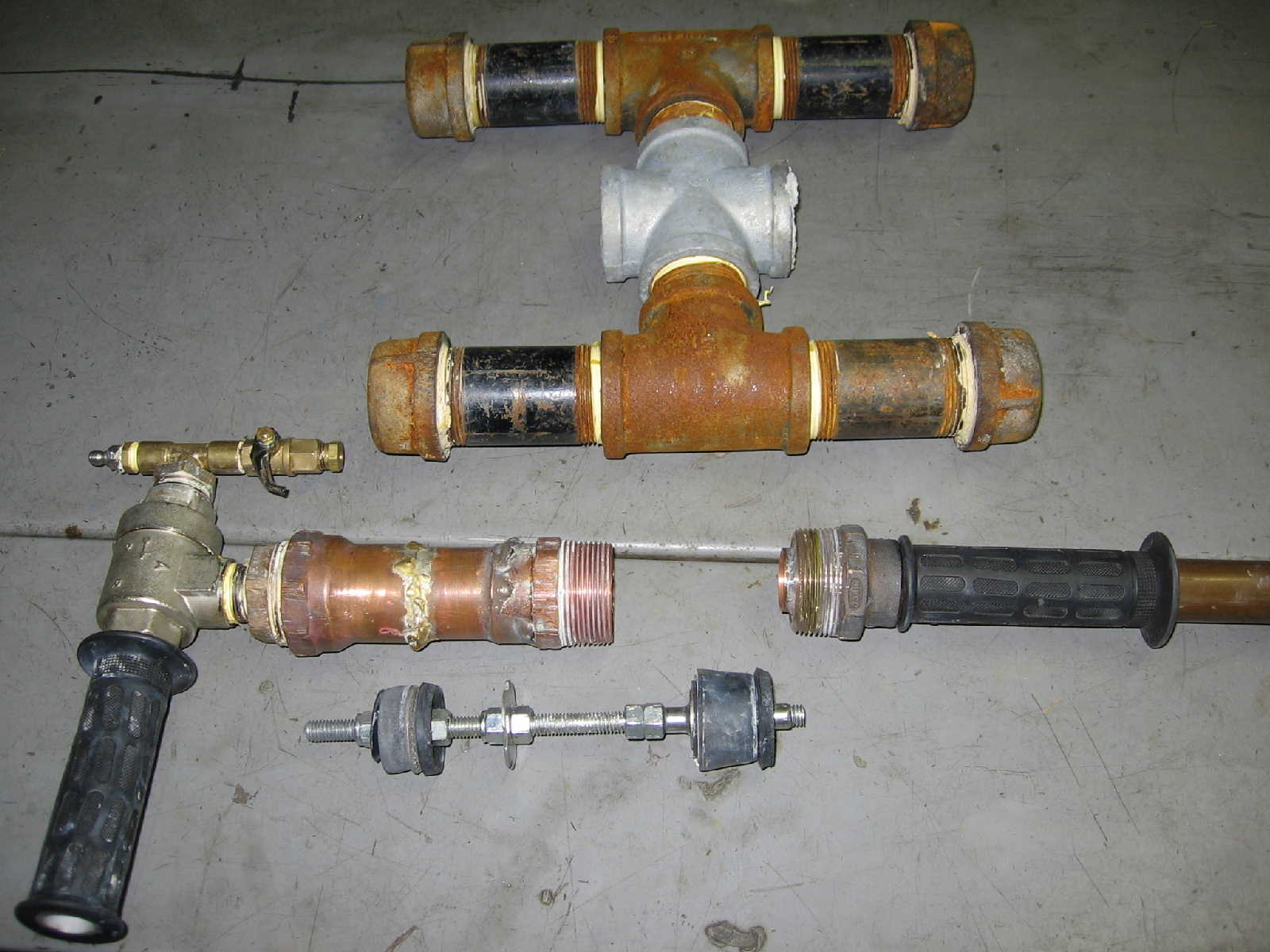

Some better pics of overall size and layout, as well as the fire control that will be upgraded soon... Also a pic of the c02 adapter setup I use to fill with....
I've tried to get readings 3 times, but at 6ft away firing 16" above the chronie, the muzzle blast kept knocking the chrony off the stand, I'm going to mount it to a steel plate 12"x12"x.125"thick and clamp that to the picnic table...

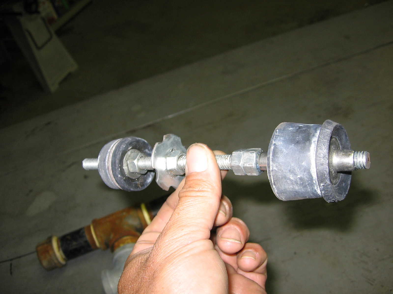

The piston is 3/8" threaded rod, 2 3/8"x1.5" washers spaced 2" apart with a rubber "flapper" seal that allows air to enter chamber but 100%seal on firing, the sealing face is .25" flange gasket rubber(we have a local company that makes large high pressure flange gaskets And I get the scraps for free, durable hi durometer stuff), with a fender washer behind and a smaller washer in front( the problem I was having in the begining was too small a washer on the barrel side and when I'd fire it the sealing face would get launched as well).... this piston has more than required travel (about 5/8") but I only did that so that the nut and rod can pull back even with the breech....

So you're sure the recoil broke the brass and it wasn't failure???

Recoil...@600psi it kicked so hard it broke off the brass fitting that the blowgun was attached to, and put me on my butt... After that I put on a 3/4" street 90..

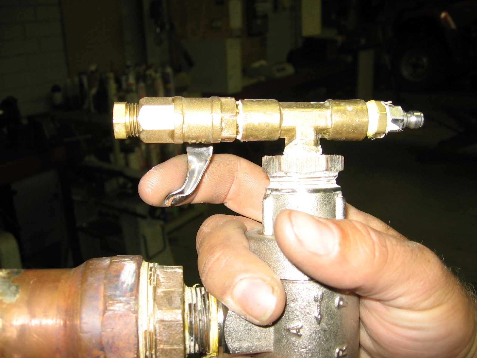

actually the nipple connecting the tee to the qev sheared, so yes, I would say that the recoil did it, especially since this thing has a teensy bit of recoil....THUNDERLORD wrote:Looks even more awesome in the close-up pics.

the grip on the barrel is just for carrying it, that's where it balances at...I'll be building a bipod for it this week...

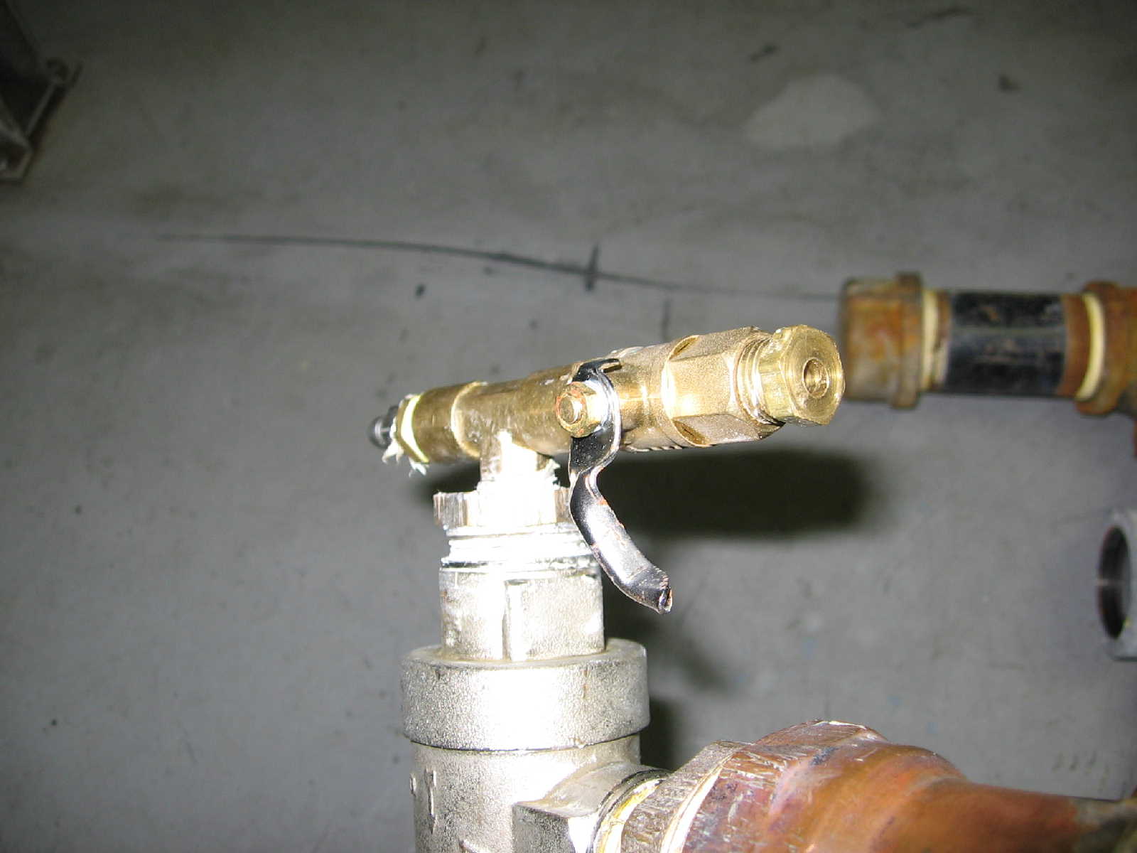

Here's the updated triggering mechanism I built to replace the blowgun triggered broken one.....

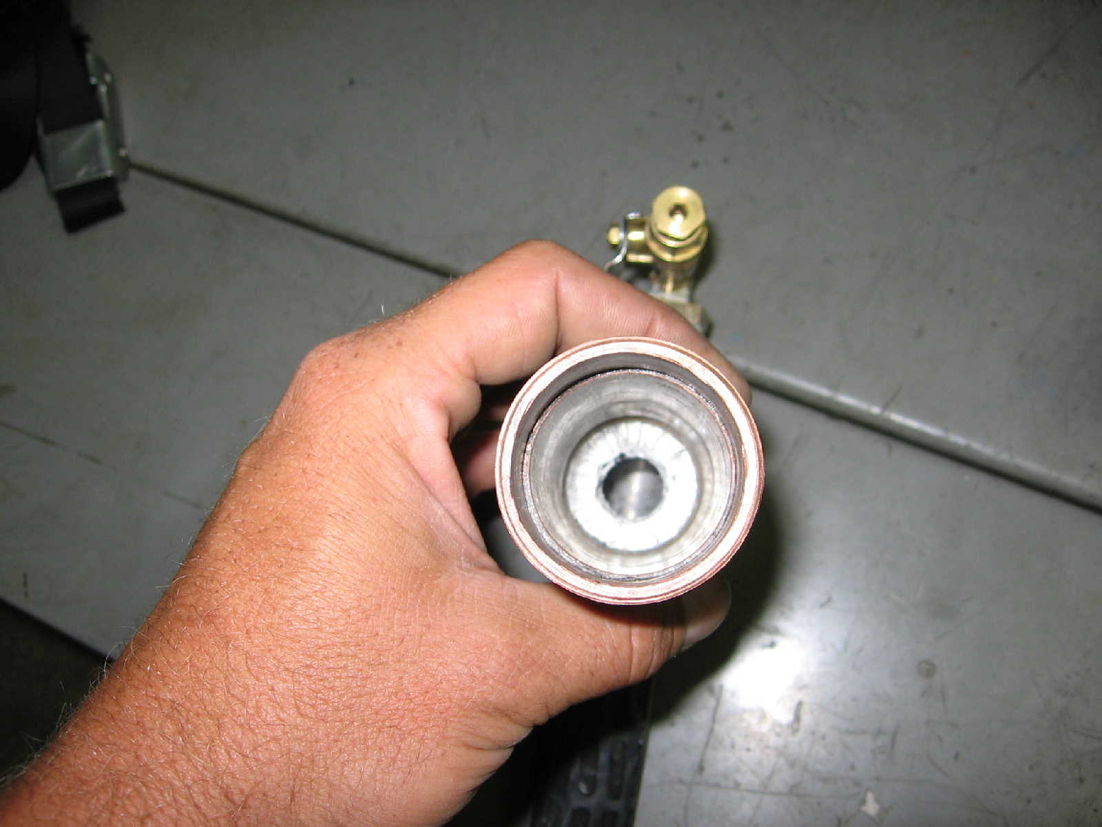

Also pics of the decimater "field stripped", the piston(showing the toolie design), and the piston/pilot chamber( gives a good visual of how I build the "cup seal" rear piston seal that is so effective for allowing only one way flow for filling and 100% seal against backflow on firing)...
The reason for the big rubber stopper behind the barrel sealing face is because with unregged co2 and a washer directly behind the sealing face, a coupla shots would destroy the sealing face by turning the barrel into a hole punch, the rubber stopper helps cushion against that....
Do you think a 3/4" qev is overkill for a 2 cubic inch pilot volume???
