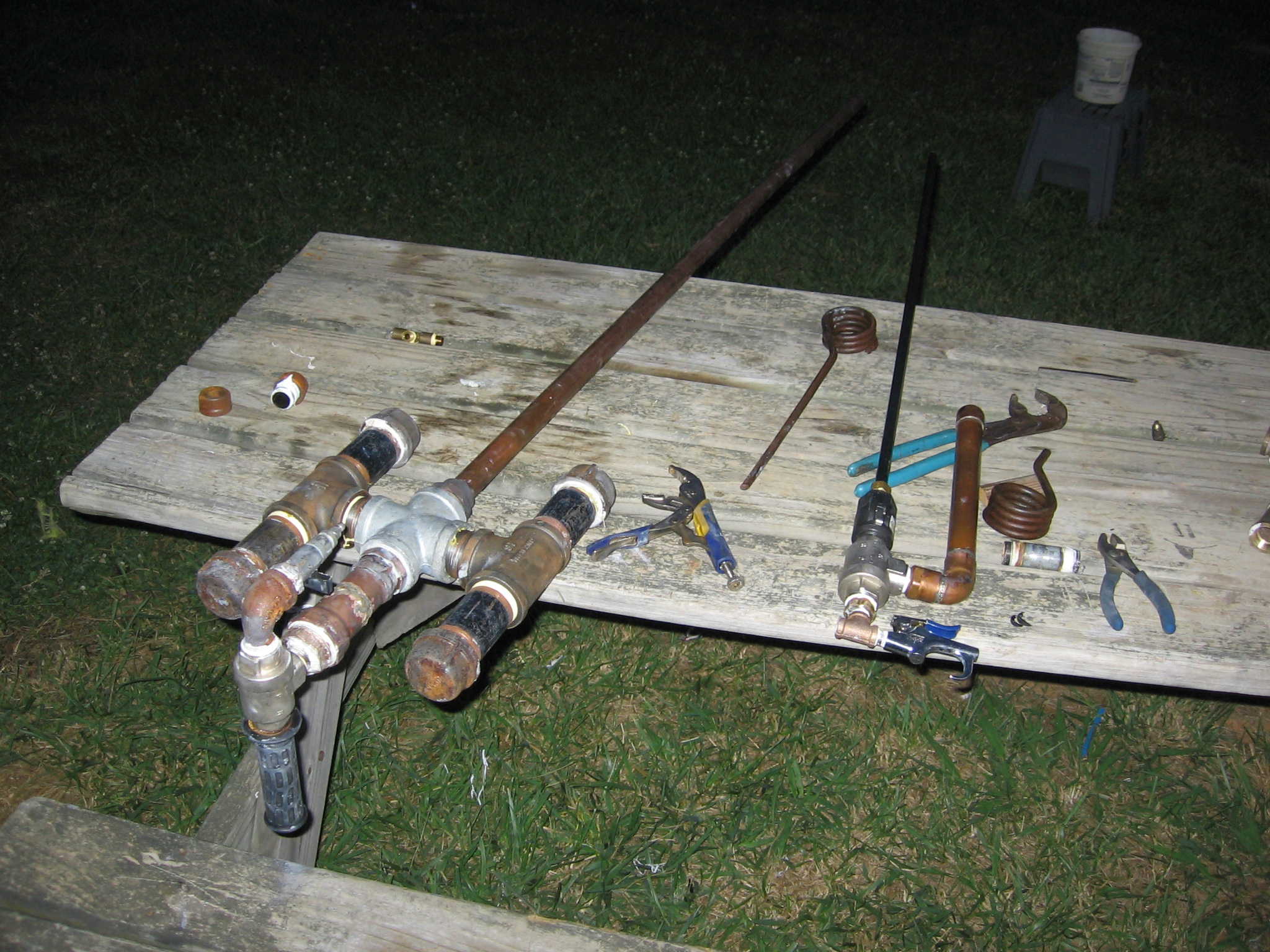

Haven't gone unregged yet but the first time I fired it with a 1"ballbearing @600psi it kicked so hard it broke off the brass fitting that the blowgun was attached to, and put me on my butt... After that I put on a 3/4" street 90 with the ballvalve and filler adapter and use the ball valve as a trigger(this friday I'll be getting a check/filler nipple and will run it off the back of a tee that'll replace the str90 and use the 1/4" ball valve as a trigger only<the>)....
I'll post some damage pics later.....
I used Iron for the chamber because I didn't have the money for brass/copper fitting for copper chambers yet....
Specs are: 1.5" porting , toolie styled barrel sealer, 1" type k barrel, 3/4" qev as the pilot valve...
I've also got to build a mount/tripod for this thing, it weighs about 30lb and will bruise your leg if you brace it against your thigh...
I also forgot to mention how much of a pain it is to make a piston that'll handle 600psi+ without self dectructing the sealing face every shot...
And yes, thats my gawdawfull ugly brazing job on the piston chamber, and LIBERAL use of pipedope on the threaded portions....
needs polished and going to upgrade the filling/firing method but It works for now...

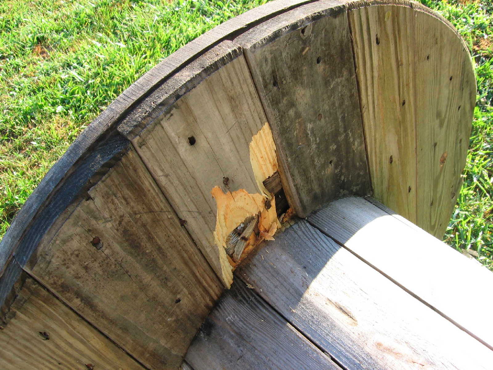

As you can tell by the pics, the wood is not rotten and that's a ' steel ball for size index...
most of the pics don't do justice because the entry wounds don't look like much but the exits are impressive

I was going for the same look as the AMS Avalaunchers, hence the sidebyside chamber layout, when I get the copper chambers built the weight an bulky look will hopefully go away... but I don't know if you want hold something lighter while firing when the recoil is so ferocious...

Some better pics of overall size and layout, as well as the fire control that will be upgraded soon... Also a pic of the c02 adapter setup I use to fill with....
I've tried to get readings 3 times, but at 6ft away firing 16" above the chronie, the muzzle blast kept knocking the chrony off the stand, I'm going to mount it to a steel plate 12"x12"x.125"thick and clamp that to the picnic table...
The piston is 3/8" threaded rod, 2 3/8"x1.5" washers spaced 2" apart with a rubber "flapper" seal that allows air to enter chamber but 100%seal on firing, the sealing face is .25" flange gasket rubber(we have a local company that makes large high pressure flange gaskets And I get the scraps for free, durable hi durometer stuff), with a fender washer behind and a smaller washer in front( the problem I was having in the begining was too small a washer on the barrel side and when I'd fire it the sealing face would get launched as well).... this piston has more than required travel (about 5/8") but I only did that so that the nut and rod can pull back even with the breech....

actually the nipple connecting the tee to the qev sheared, so yes, I would say that the recoil did it, especially since this thing has a teensy bit of recoil.... :shock:
the grip on the barrel is just for carrying it, that's where it balances at...I'll be building a bipod for it this week...
