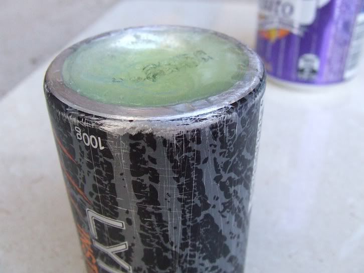

Well I'm making slow progress, but it's coming together. This is the piston so far:
This is the indent in the end of a deodorant can filled with epoxy. This is the rear of the piston, so the purpose behind the epoxy was more surface area contacting the bumper and thus the force is distributed.

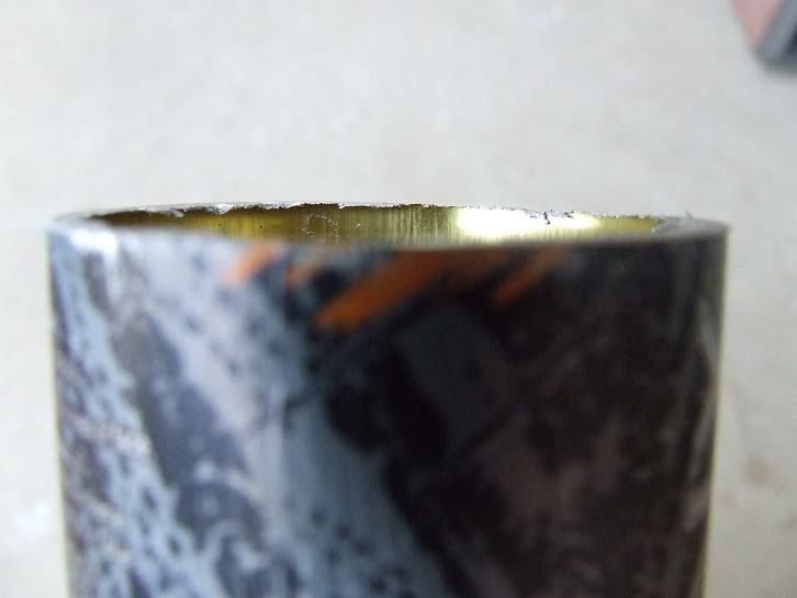

This is the sealing face end (unfinished; there is no actual 'face' to it yet), sanded flat with an angle grinder.

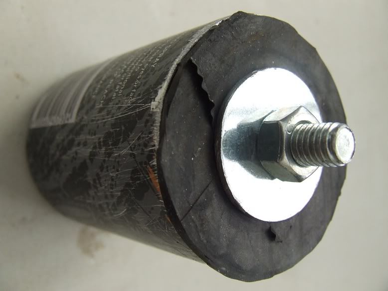

I plan to make the piston as light as possible, and so far I can slide the piston back and forth inside the tee just by exhaling and inhaling. This brings me to my concern - I don't want to bolt the rubber disc down like my previous launchers piston as the bolt will add substantial weight to the piston. What I was thinking was, using JSR's tutorial, fill the end with approximately 1/2cm of epoxy and then place the rubber on top and let the epoxy set. Basically - epoxy the rubber disc on. Would ~100 psi be too much pressure and rip the rubber off?

Find a lighter bolt, but do put one. Even if you roughen up rubber correctly epoxy usually has a hard time holding on to it under tension, personally I wouldn't risk it.rikukiakuchiki777 wrote:I don't want to bolt the rubber disc down like my previous launchers piston as the bolt will add substantial weight to the piston.

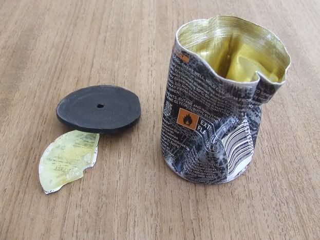

A few shots later, the piston went from this:
To this:
I should have realised that would happen with the thin aluminium walls, but I'm rebuilding a reinforced one.

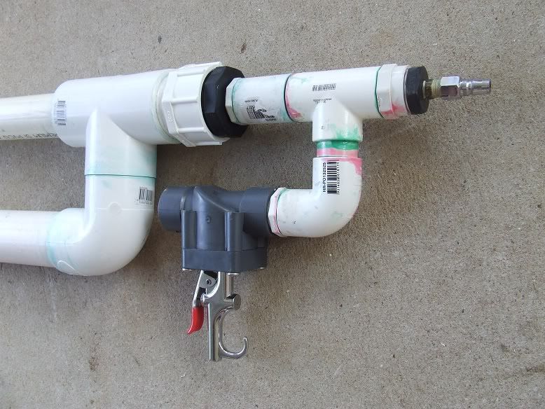

Anyway, this is the pilot area now:

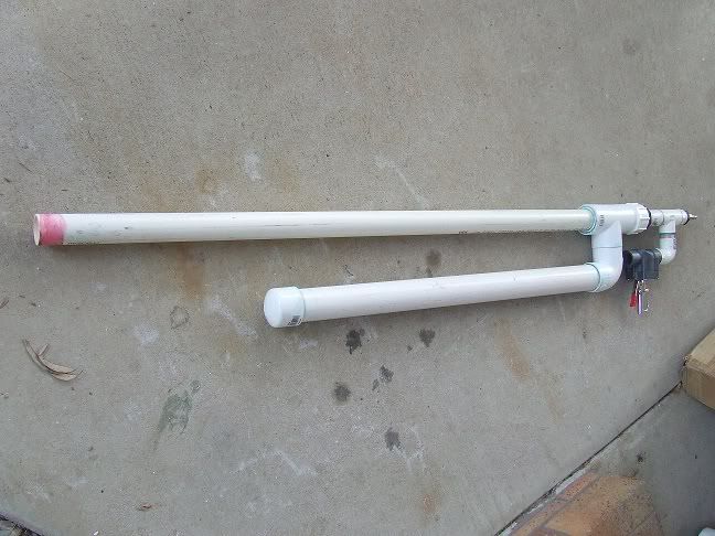

And the whole thing:
To this:
Ignore the crappy priming and paint stains, I'm really careless with that stuff

Haha shame about the piston. If you look at the piston I built out of a deodorant can in my first tutorial, the whole inside of the can is filled with glue, sounds heavy but it's not very long and weight isn't the worst problem that can effect performance anyway.

My new piston is the same thing however I've got a piece of PVC inside the deodorant can thats nearly the same OD as the cans ID, but I will fill the gap with epoxy. Its still extremely light, and should be capable of withstanding a lot more. Oh and I think my bumper was inadequate. I just chucked a fairly thick piece of rubber in to handle the 40psi shots, then forgot all about it and kept upping the pressure
