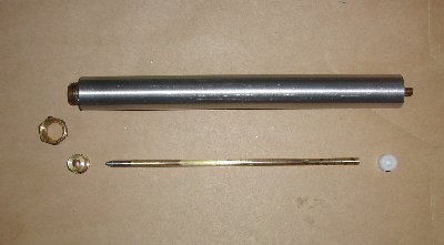

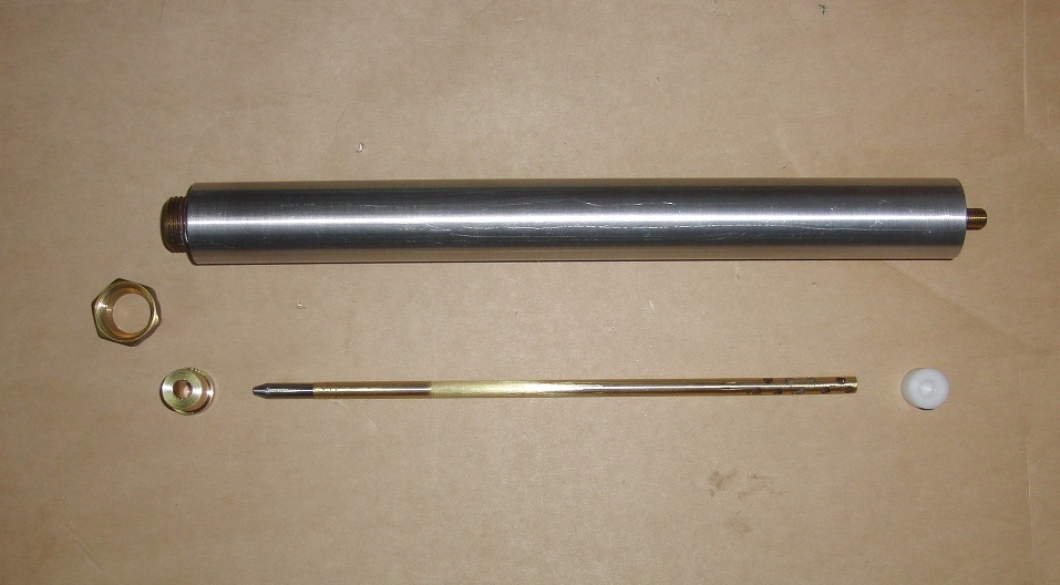

I made my own variation of this design using a coaxial
In the first shot in real time, you can hear the air leaking out past the captive sabot (or cabbot as we're now calling it
) after the shot. There's noise from the pilot exhaust and the impact but it's much, much quieter than when it's shot as a conventional launcher.
The "arrow" is a 6.5mm OD brass tube with a mild steel head, total weight is 22 grams. The perforations at the end are incidental because the tube is a recycled barrel from another project, but what they do is allow air to escape at the end of the piston's travel, reducing the air bumper effect. In spite of this, the delrin cabbot is undamaged many shots later, probably due to the relatively low velocity from the heavy projectile.

I'm waiting a silenced version of Helsing from you now Jack
Did you put the background music to show the effects? Well thought and as I can hear clearly the leak after the shot I'd say it worked very well.
Hehe not sure if I want to make a pneumatic repeater or a single shot hybrid in this style:wyz2285 wrote:I'm waiting a silenced version of Helsing from you now Jack
The music is just what I happened to have on in the background at the time.Did you put the background music to show the effects? Well thought and as I can hear clearly the leak after the shot I'd say it worked very well.
It's hard to isolate the noises, there is the pilot noise, projectile impact, cabbot impact... but the amount of noise this thing makes when fired in a conventional way is enough to make your ears ring, this is definitely silent by comparison.
Edit: another video, chronied it this time. At 250 psi, it's humming downrange at a mere 87.5 feet per second. That's only 5.8 ft lbs, so anaemic that it would be legal as an air pistol in the UK! boooooooooo!!!
I think hybrid is the way to go...
