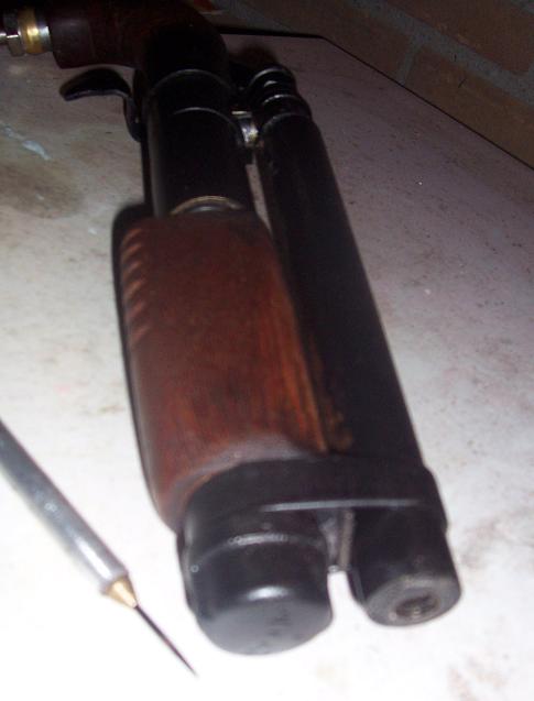

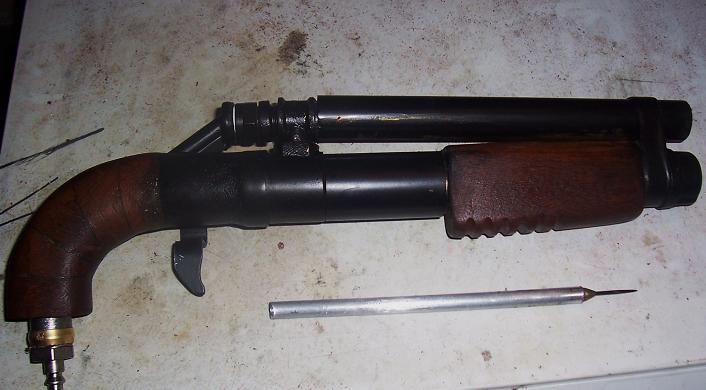

Just something I have been wanting to try for a long time.
I tried this system before on my " push botton valve" experiment.It needed more flow..
Take a barrel, shove in a rubber " sabot" and put a reducer on the muzzle.
The sabot can now push an arrow, but it cannot exit the barrel.A drilled out center point helps to keep the arrow aligned and steady.
This causes the gas to be trapped.
Of course..I made it so that not doesn't seal 100% ..the air bleeds out slowly..resulting in a silent shot.
An arrow gives better penetration while the sabot gives it more force.. :D
Unfortunately, threading a reducer into the muzzle made the barrel sleeve turn over it's foam tape insides and droop even more, but this is just a prototype,
I will replace it by a shiny new barrel all together
*( " I will replace...")* :D
I will also drill ports in front of the sabot to enable it to push out the air in front faster.Next try the system will be removable, so I can still fire marbles and 16 mm ball bearings if I choose to.
The arrow ( or airrow..) got launched in complete silence, apart from the impact, wich was not too loud and most importantly, doesn't even sound like a shot.
Damage was done at under 300 psi.The gun could take a lot more..

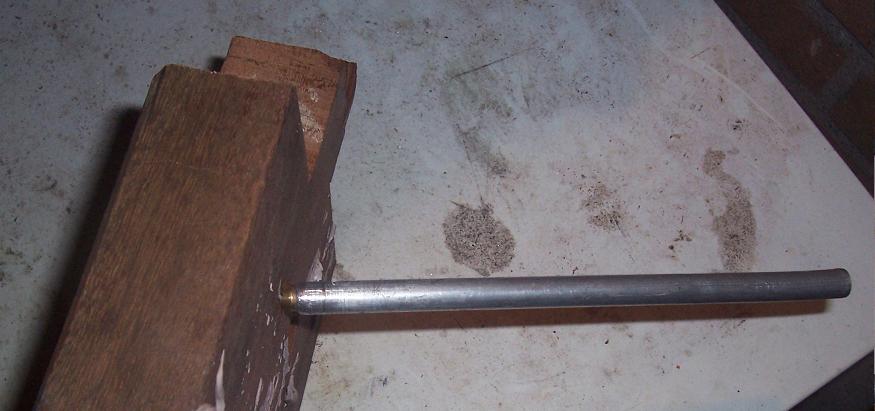

The target is 4cm thick quality hardwood, shot at a 90 degree angle to the fibers. ( hardest to do)
So much for reusable arrows..I can't get it out...
OUCH!! silent but...<br /><br />No way of getting it out without destroying the arrow.<br />With a longer spike I believe it would have gone through.<br /><br />My brothers combound bow could not do this.I did it with a 29 cm total length sawed-off pneumatic.
Hacked off reducer into the muzzle.I didn't take the effort to clean it up.Barrel will be replaced.
Droopy...Yes...just wait!<br />I'll make some new arrows too.<br />Just imagine what a longer barrel and arrow will do at 40 bar..( hint: J.Hogg and Psy..)

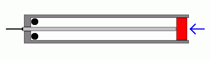

I'm guessing it's pretty much identical to the SP-4 cartridge concept using a cylindrical projectile driven by a piston?
unfired cartridge
firing
piston jammed against cartridge, projectile fired.

This can be done pretty cheaply as an attachment for a "standard" launcher, I like the rubber sabot idea, heavy but it helps to soften the impact. If you carve out a small space in the centre of the piston, you wouldn't be limited to cylindrical projectiles either, though accuracy would probably suffer.
if you carve out a small space in the centre of the piston, you wouldn't be limited to cylindrical projectiles either
already suggested :D
accuracy issues probably could be solved by adding a short length of small bore barrel at the muzzle. It would be the best to have a short tapered section of the barrel facing the piston so that the projectile could get in the barrel
POLAND_SPUD wrote:accuracy issues probably could be solved by adding a short length of small bore barrel at the muzzle. It would be the best to have a short tapered section of the barrel facing the piston so that the projectile could get in the barrel
Precisely what I was thinking ;) still, the projectile cannot be too off-centre, otherwise you'll fire the barrel off as well :D
