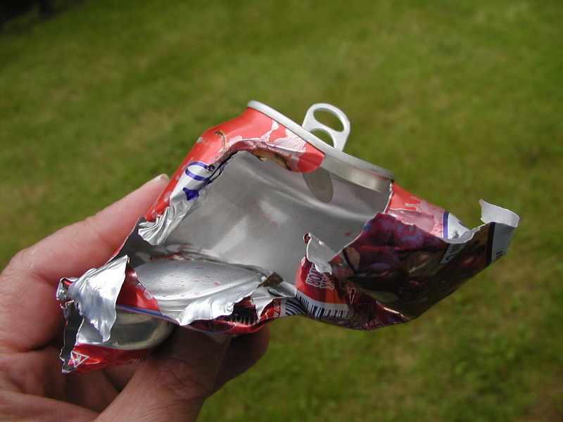

For those with smaller valves, you can play too. Here is a can launched from my Marshmallow cannon with a 3 foot barrel.
The launcher is 54 cubic inches
Valve is 1 inch.
Can was launched empty at the edge in an attempt to split the can in half.
Photo below.

Not bad for the small valve, if I can get my hands on a soda can barrel I will definitely try this.

tech, those damage pics are both extremly impressive and odd, with all the empy cans i have shot i never had a side blow out. they usualy just smush and endup in 2 peices. was that shot at extremly close range? because at close range the internal pressure of the can would still be high and possible cause a blow out upon impact

The distance is shown in the photo on the second page. Muzzle to target is about 6 feet to reduce can rotation.was that shot at extremly close range?

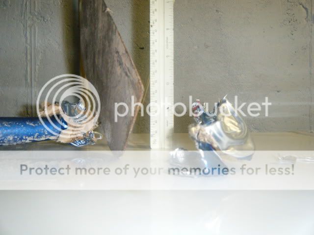

Here is what I got sofar, the tests were done at 20, 40 and 60 psi since it was done in my "indoor firing range" aka my basement.
I also attempted the "can cut in half" with a garden hoe... I couldnt find my Machete
If i find it and remember to do this... I think the "halving" will be cleaner.
Tests were done against a concrete wall. It didn't move...
