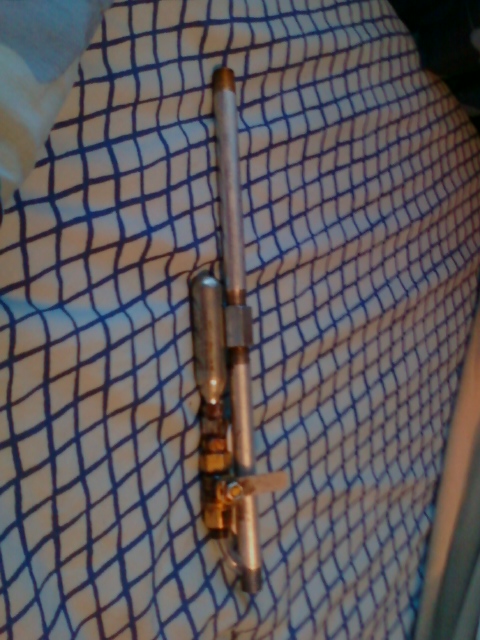

Is it me or did the barrel change in the diameter for the last 8 or so inches? Is it a full length barrel suppresor or wah??
Also, you said that it was an over under design, where exactly is the co2 canister, I can't seem to see it in your pictures
Yes, the diameter did change, the inner barrel is the smaller one, and the bigger part is the outer barrel/long supressor
. And the co2 canister is in the wood, just like the Firing valve and the metal T.
Look on page 1, second pic down. you can see the chamber there.
Ah, now I see it.
Did you epoxy some annealed copper tubing onto the CO2 canister or something similar?
I'm asking beacause the connection from the co2 canister to the chamber dosen't add up, the co2 canister is too small for where the barrel starts.
Does this help? Its the internals of the gun.
