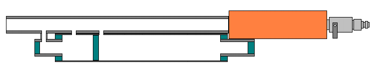

That looks like a very unusual, but totally awsome way of making a supressor JSR.
Never made one like this before but you certainly gain a lot of volume by having the barrel out of the main tube. In this case, the main tube alone has a volume of around 13 cubic inches, over 25 times the volume of the chamber. I've also split it into two chambers as you can see from the internal diagram, which should make it even more effective.
I might also have to make an attachment for the pilot as it will likely be louder than the muzzle blast itself, a simple clip-on expansion chamber should suffice.
- Actual internal configuration of the suppressor
- 12boresuppressorint.GIF (3.16 KiB) Viewed 4222 times

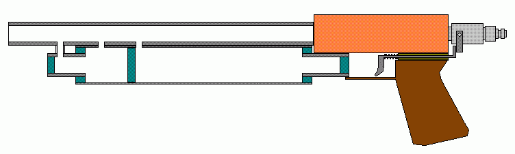

- planned trigger/pistol grip configuration
- 12boreplannedconfig.gif (4.4 KiB) Viewed 4180 times

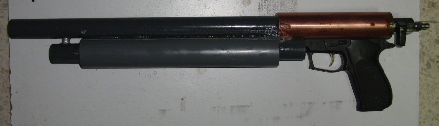

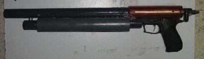

I'm normally reluctant to finish off my launchers aesthetically and ergonomically, due to the non-servicable nature of epoxy construction should something go wrong inside I will have to throw the whole thing away so I don't bother.
In this case, the only moving part is the piston, which doesn't need lubrication, plus the seal is 1/2" thick neoprene which is unlikely to wear out throughout the life of the launcher, and the pilot/fill valve setup is removable, so I'm more confident with making a completed launcher. Always wanted a riot gun lookalike in my armoury
At 18" barrel length it's not quite at "sawn-off", but I'd rather gain a couple of inches of barrel length if it means more power and less noise.
I'll take it to 800 psi tonight and see how it performs. By my reckoning suppressor pressures shouldn't exceed 10 psi so hopefully nothing will blow out
Having the temperatures at Scorchio! might be annoying but it speeds up epoxy curing times remarkably, it's almost fully cured after a mere 6 hours

waiting for the info of the 800psi shots, lets just hope that you wouldnt kill yourself
I'm confident the chamber will hold that pressure so no worries there, as to ricochets... well, I've learnt my lesson
Given that the suppressor volume is greater than the expanded volume of HPA in the chamber at atmospheric pressure, there is a concern that a vacuum will be created in the barrel before the projectile exits the muzzle, thereby slowing it down. It should be noted however that the ports through which air can flow into the suppressor chambers have an area 6 times smaller than the area of the barrel. As there are three of them in total air can only fill the suppressor at a maximum rate around half of the rate through the barrel, so this eventuality should be avoided.
I've just done some testing, here are some velocity and muzzle energy results using a 30 gram CO<sub>2</sub> capsule:
barrel without suppressor at 100 psi: 40.7 fps / 1.7 ft/lbs
barrel without suppressor at 500 psi: 190.5 fps / 37.3 ft/lbs
barrel with suppressor at 500 psi: 180.9 fps / 33.6 ft/lbs
barrel with suppressor at 800 psi: 250.8 fps / 64.6 ft/lbs
As you can see, the suppressor cut 10 fps from the muzzle velocity at 500 psi, doesn't sound like much but for a relatively heavy projectile it cuts almost 4 ft/lbs from the muzzle energy, that difference is more than what most CO<sub>2</sub> 0.177" pistols will manage.
The energy increase at 800 psi is fantastic, and while the suppressor made a difference at 500 psi - more of a "whoosh" than a sharp crack - at 800 psi, *quite* loud, but I can't tell the difference because I hadn't fired it at 800 without the suppressor.
I decided to give the UPS steel case another go, but as I was filling the chamber sprang a leak. I'm guessing the pressure stretched out the copper tube a little. I tried it subsequently at 150 psi and there were no apaprent leaks, but it leaked at 500. I've added some reinforcing epoxy, and put the innards under some vacuum with a large syringe to attempt to such in some epoxy into any hairline leaks.
Since I had the target and camera set up I took the shot anyway, no idea what the pressure was but it didn't quite punch through - still, made a bigger hole.
